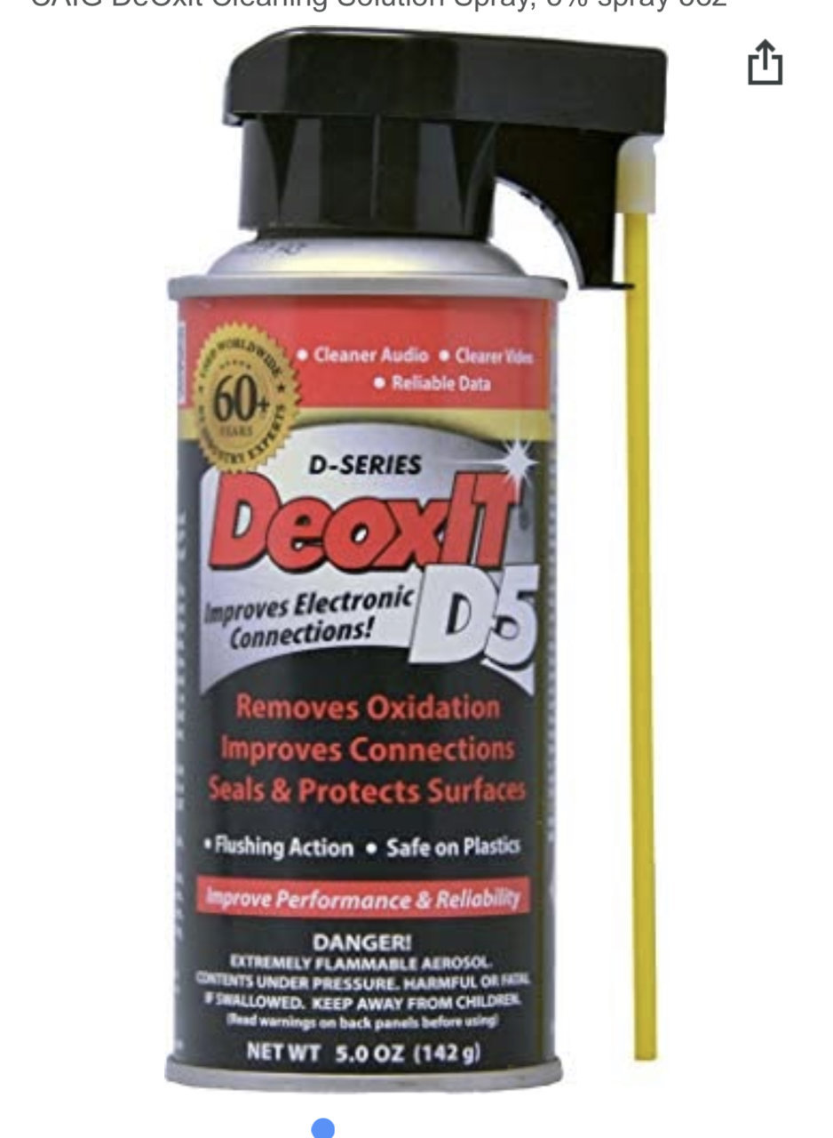

    You beat me to it! I was going to say, if OP intends to try to keep or dry it out himself, Deoxit is the best bet IMO for all the connectors. Stuff like occupancy sensors under the seat might be fucked regardless, but I think most of the actual ECUs should be fairly high up under the dash.
    @captawsm how high was the water on the inside? It honestly doesnt look that bad from the screen shot
    https://smile.amazon.com/Hosa-D5S-6-DeoxIT-Contact-Cleaner/dp/B00006LVEU
