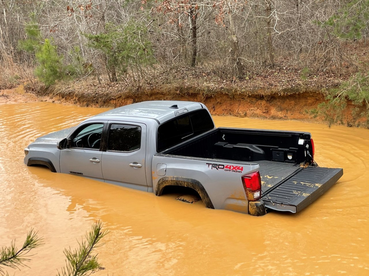

    Yeah, hopefully they do total it and whoever picks it up knows what it has been through. Otherwise we will see a guy on here a year from now chasing electrical problems.
    Not sure if this one is included. Luckily it was short (although running a bit faster than I was comfortable with), and I had already seen an LC go through. I'm not quite as heavy as an LC, though. Nothing got inside, but driver's seat has a nipple now.

    When I did mine I was throwing lots of engine codes. I hydro locked it and spent a couple days of drain water, Crain, oil, repeat, etc. it would run, but then it would only start and kept dying due to the anti theft device. Insurance called it comprehensive as there was a road there and water came up. Totaled it and happily split ways with it. Didn’t even want to fix it and sell the lemon knowing it would be a gremlin machine for a year or more.

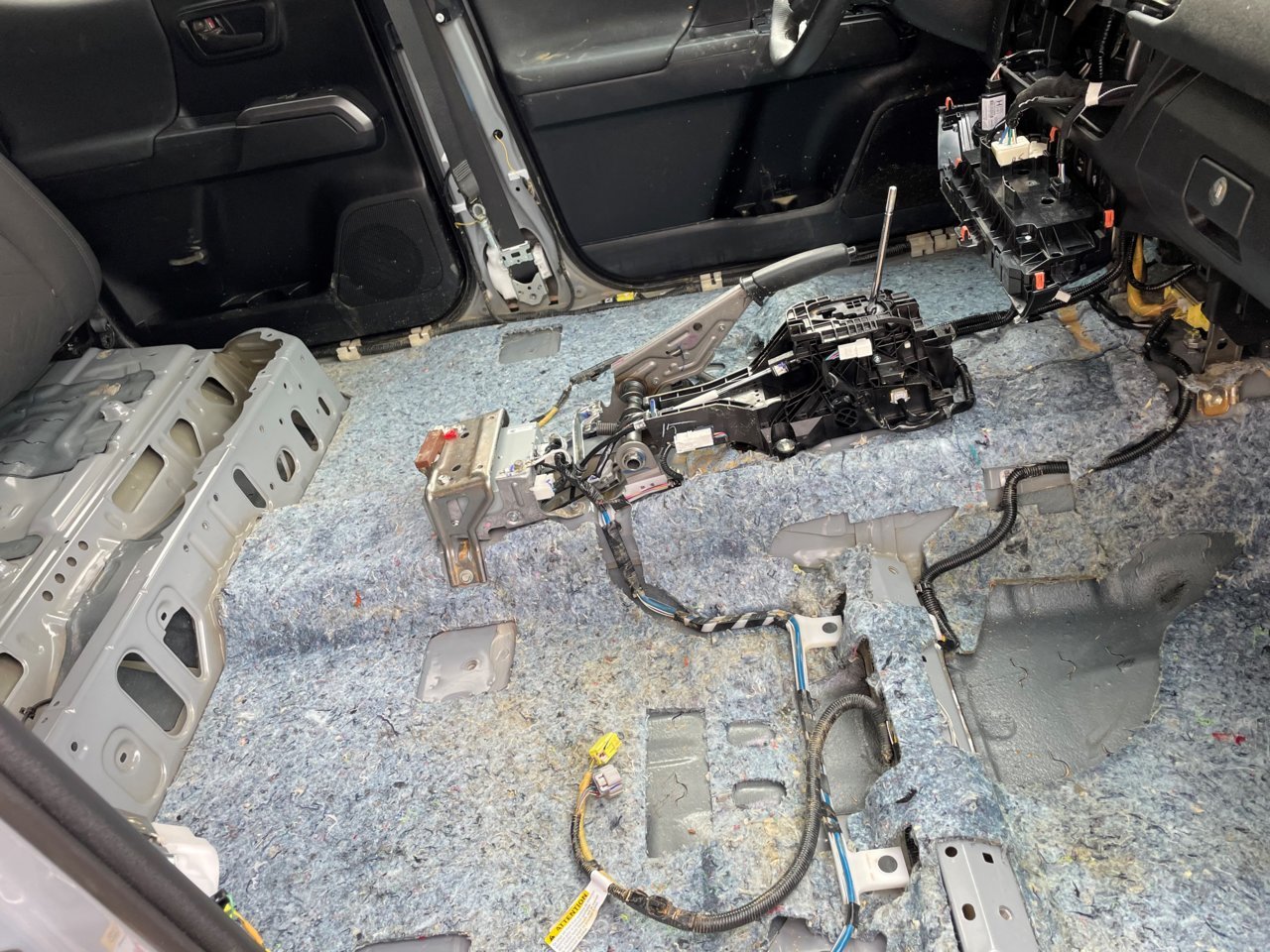

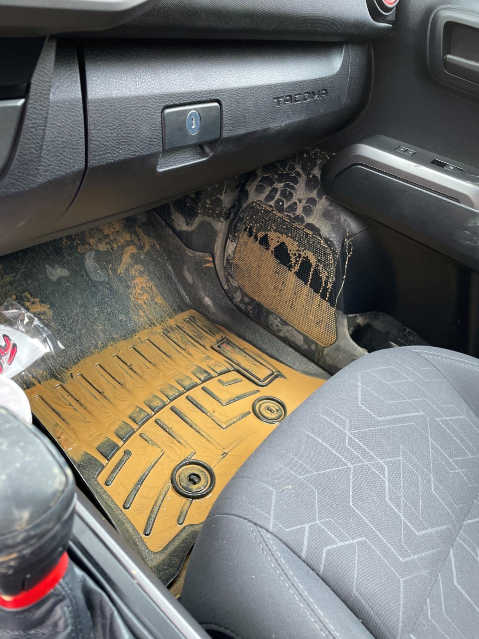

    I did the exact same thing almost four months ago. I never turned off my truck, and the water never went over the engine. I did have 6-8" of water in the cab though. I had to replace the starter (sounds like you have similar issues) and alternator. I completely stripped the interior, cleaned it, dried it, and reinstalled it. Then I took it to the dealership for a once over, so they could check all the error codes. Those codes, the starter, and alternator were the only issues I experienced from the water. It was a real pain to clean it out, but everything works like a charm at this point. I did some more damage to my truck trying to get it out, but that's another story lol. Because of the physical damage we did to the truck while pulling it out and a local shop telling me my computer was fried (it wasn't, it never even got wet), I called State Farm, and they paid everything without question.
