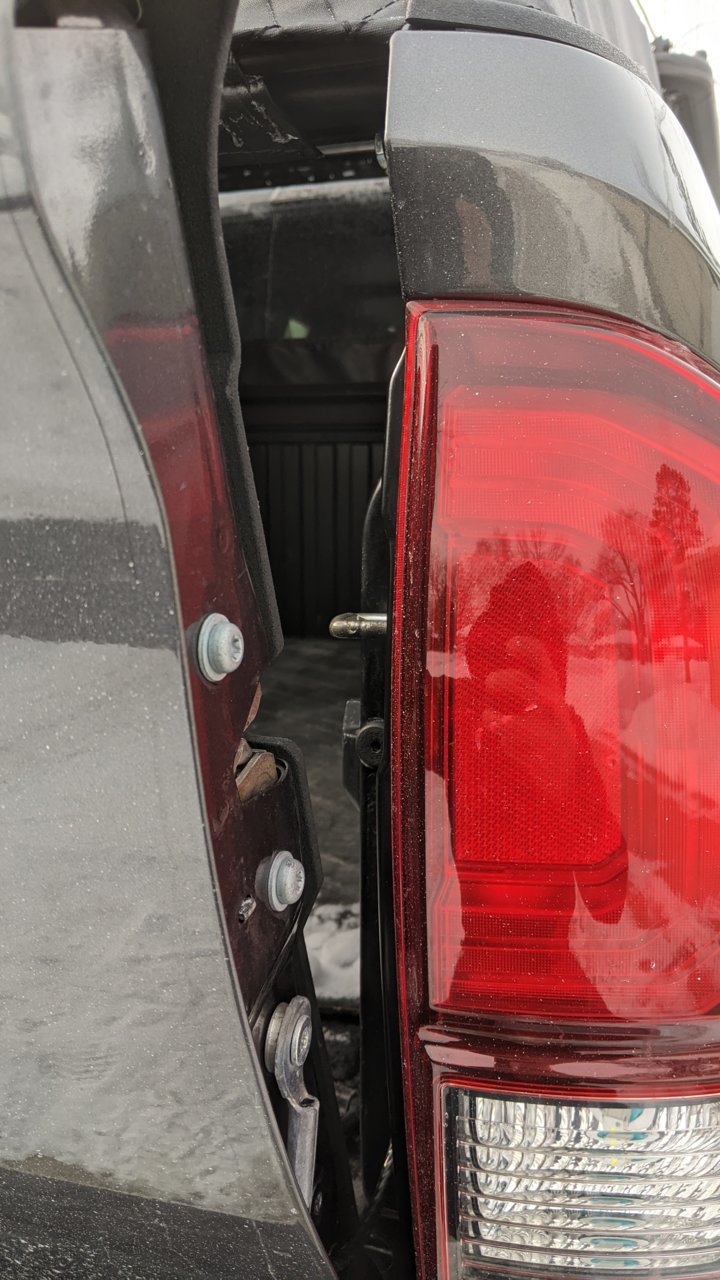

    We have gone from rainy weather to cold weather well below freezing. My key turns in the lock and the latch handle lifts but the tailgate does not open. I'm thinking the latch mechanism is frozen.
    The tailgate itself is not frozen because it moves slightly when I push on it.
    When I turn the key to unlock it turns past 45* but not 90* (flat). I think this is normal, but can anyone confirm?
    I have a BakFlip tonneau cover, so I now have no access to the truck bed.
    TIA for any help.

    Use a hair dryer on the sides of the tailgate where it latches to the bed.
    Water can get inside the latches and when it freezes the latches can no longer operate.
    So after you get it open, blow out the water from the latches on the tailgate with compressed air then spray some wd40 on them.

    Where on the sides of the tailgate are the latches located? Up high above the level of the top of the taillight or ???

    About 8" down from the top of the bed.

    It was the tonneau cover frozen to the tailgate that was the problem. I used a hair dryer and while it is slower than a heat gun, a hair dryer won't melt plastic.
    I have dried both surfaces and applied Areospace Protectant 303.
