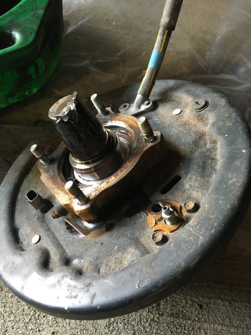

    Well I have the rear end apart and what a surprise that was. Hats off to ECGS. their customer service was top notch but in this case not necessary. The third member is perfectly fine. My passenger side axle shaft is sheared in half and the housing is bent. I’ll be calling Matt back at ecgs to thank him for his help and wish him a merry Christmas.
    Back to business... I am in desperate need of a rear housing with shafts for this turd. Anybody around Tennessee have one laying around? TRD off road 8”

    Anybody know if the trd off-road housing is the same as the base sr5 housing?
  16. Nov 8, 2019 at 1:33 PM
    #1436
    RyanDCLB
    RyanDCLB Well-Known Member
    Jun 13, 2019
    #296235
    3,543
    4/19 DCLBOR
    BAMF lists it as 8.0 locking diff and 8.4 non-locking diff here :notsure:
    markus30[QUOTED][OP] likes this.
  17. Nov 8, 2019 at 1:34 PM
    #1437
    markus30
    markus30 [OP] Well-Known Member
    Apr 11, 2017
    #215993
    877
    mark
    Florida
    2009 tacoma dcsb trd
    king 2.5 coils with resi in the front, dirt king lca, TC uca, archive towers, 14" rear kings, shackle flip, dakars HD. pelfreybilt front bumper, sliders and skids, brute force rear bumper, method nv 17" wheels, 35" ko2s, 4.56 gears locked, EBC brakes,TC spindle gussets, dual batterys, arb fridge, bunch of other crap..... more to come
    Yeah just looked it up. Not the same. And considering what the local salvage yard just quoted me for a complete trd off-road tear end, I’m about to just order a 9”

    correct, for some reason the e-locker rears were made to be slightly smaller than the SR5 and Sport rear ends. 8" vs 8.4"

    So get the rear with the e-locker. I've read that the electronics are pre-wired on non TRDOR models. Then just get the gears that fit the 8" rear.
