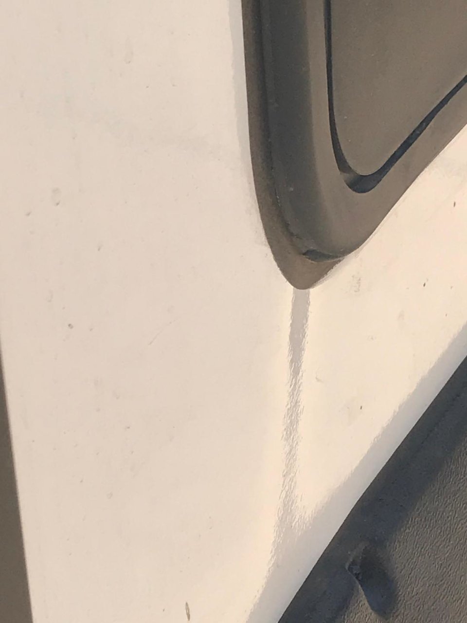

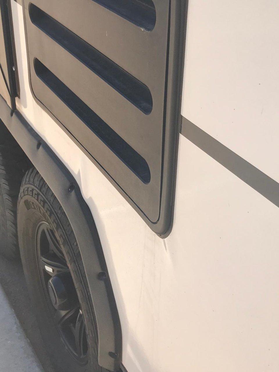

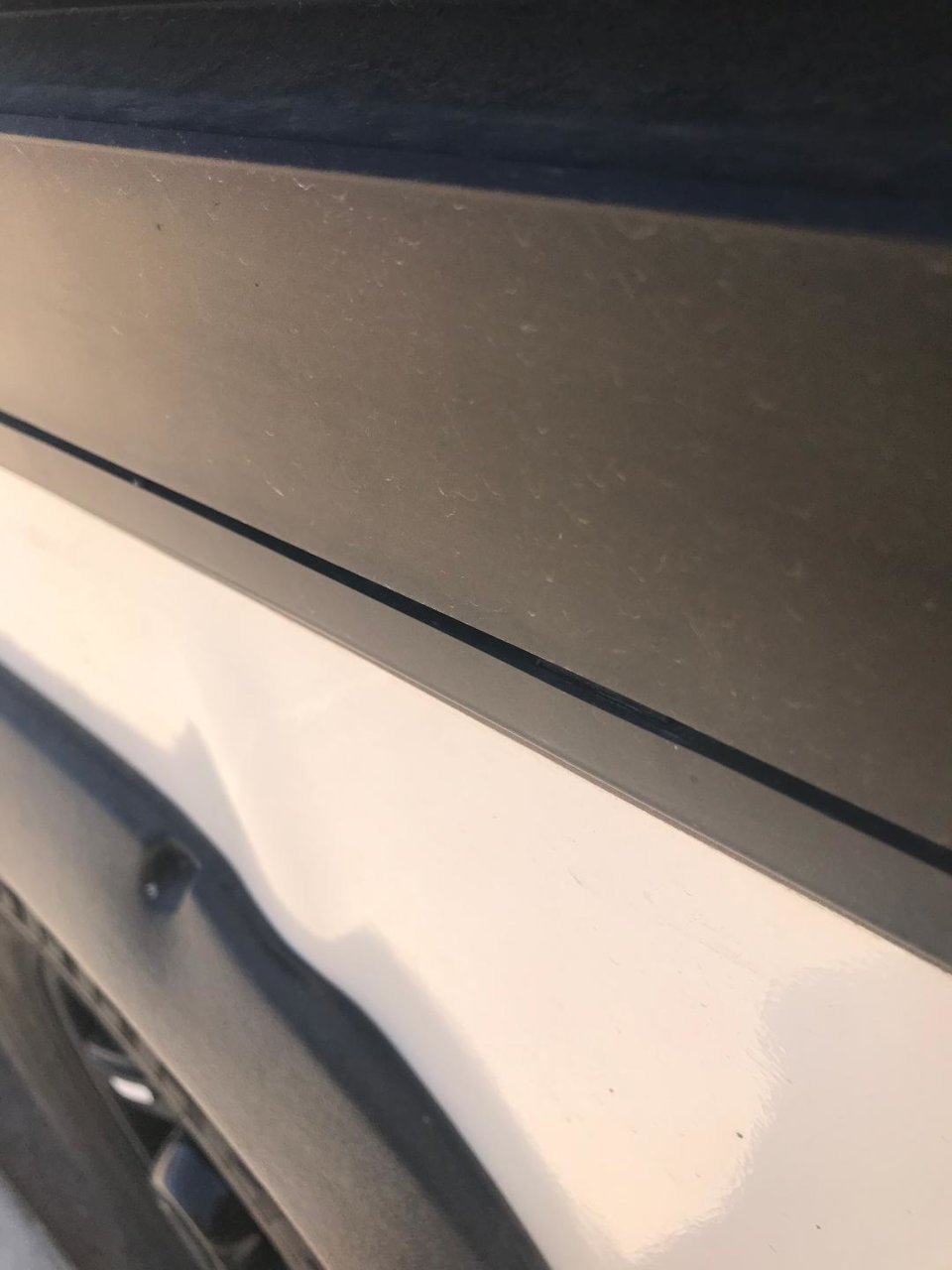

    I had a fiberglass issue with mine at the corner of the refrigerator access down to the fender flare. There were waves in the fiberglass sheet. I sent pictures to NoBo and they thought it was delamination and tried to say it was from seals in the refrig access leaking. I let them know that it was noticed a week after I got it and we hadn't had any rain from the time of purchase until the time I brought it to the dealers attention.
    It ended up being a glue issue and was fixed to my satisfaction.

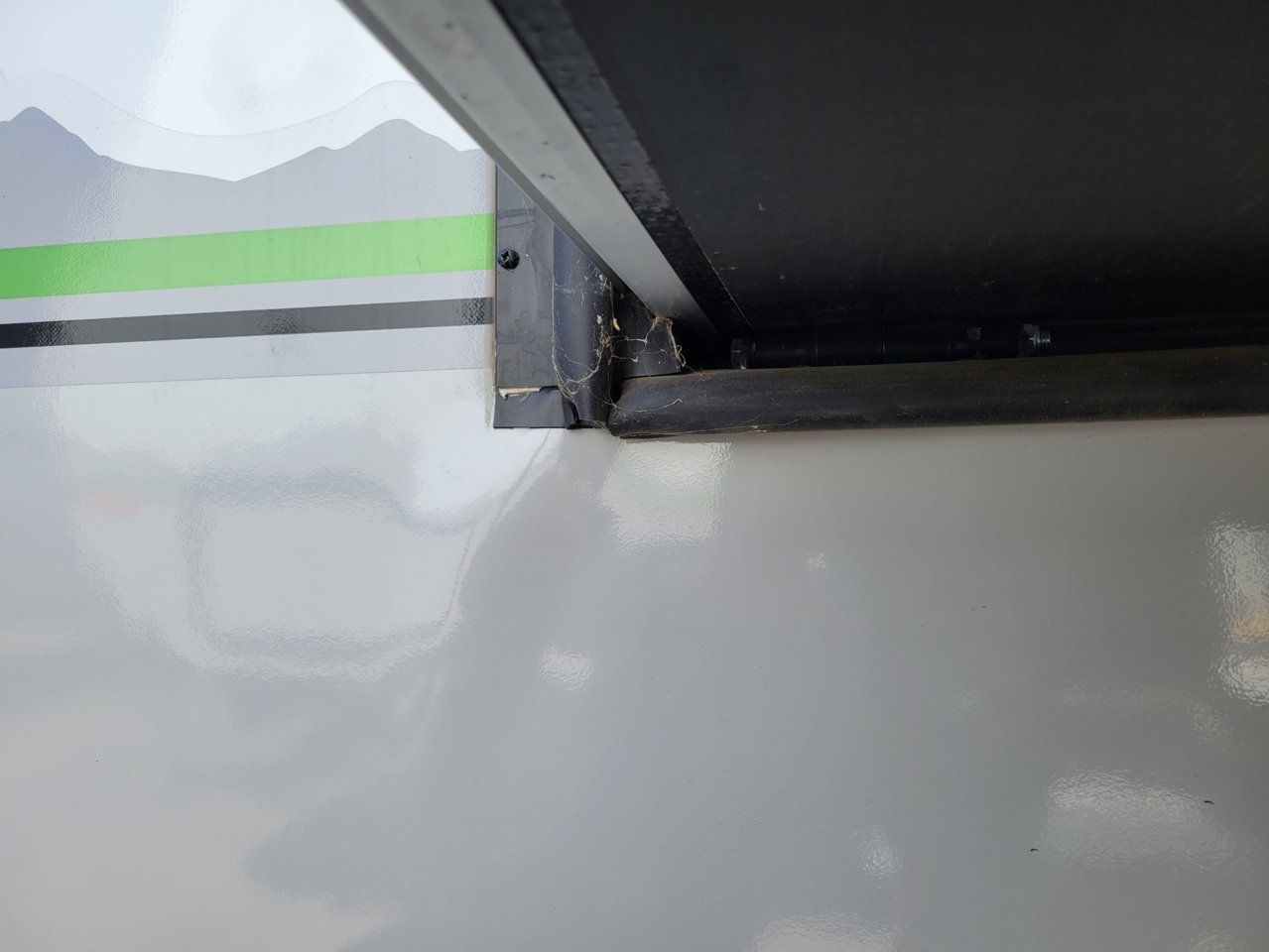

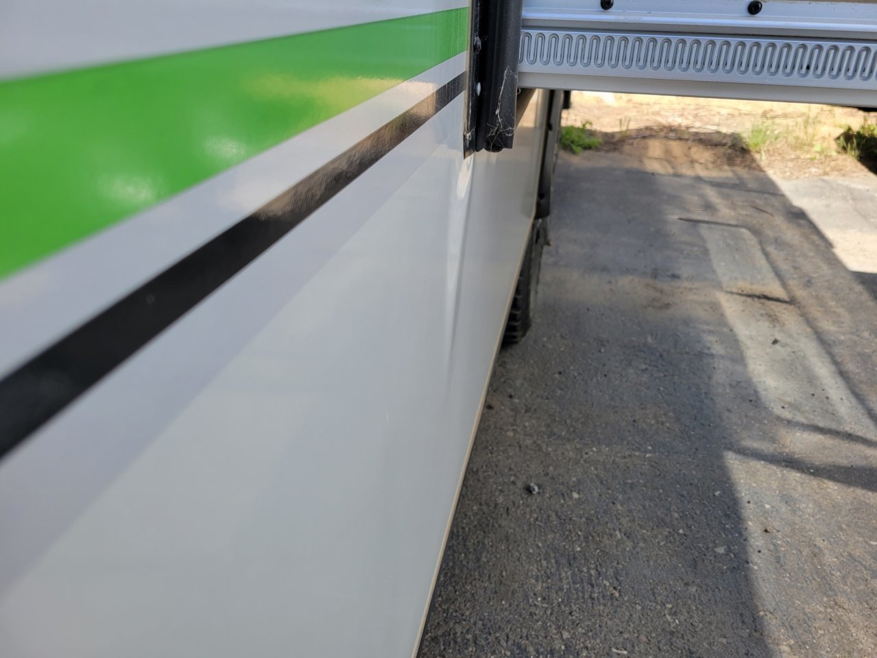

    That same friend of mine mentioned that it's seldom water intrusion creating these delams when new. He said ever since Covid Production trailers have hit the lots, the delams are pretty much always due to the builder moving too fast and failing to apply a sufficient amount of the adhesive product to stick it to the foam core walls. He personally has developed some good tricks to fix these things that don't lead to more problems but he warned that the wrong guys doing repairs can cause repeat problems. Resins will attack and destroy the foam that encased in the aluminum framework that the Azdell and interior luan is glued to. When that happens, it creates inclusions or pockets of "nothing" for the surfaces to stick to so it makes it easy for for the delams to continue once they get going.
    Kinda funny, I haven't heard shit from my dealer in a week and a half after giving up a $1000 deposit and I'm laying low to see how they deal with this transaction. My sales guy was nice in that he didn't shadow us when we went and looked at different models but I now know that I know more about these trailers then he does and he doesn't bother to call me to update where things are going. We put a credit app in 2 weeks ago as we're tossing the idea of maybe buying through a credit union and then paying it off in 6 months or so or we may just cash it out. It depends on the interest rate at this point. I know the credit stuff was dealt with 2 weeks ago as I was alerted to the hard pull. I get a call yesterday late afternoon from a service tech wanting to schedule our walk through and hand us the keys! Nobody has sent me a purchase agreement with pricing, finance details, nothing. In the meantime, I have found a used 2 times, kept in a barn 19.6 for sale about 45 minutes from home for the same price the new coach is but that's negotiable. Then I found a new '22 up in NorCal with all the bells and whistles with upgraded solar with a bigger inverter and Battle Born Lithiums for $4k less! They sent me a confirmed pricing agreement and spec sheet within 10 minutes of me talking to them yesterday. Even though my dealer is 10 minutes from the house, I have a suspicion this communication issue while carry on when it comes to warranty issues so I'm on the fence right now about their trailer.
    Here's a shot of the first one with the delamination for grins and giggles!

    Here are some picture of my fiberglass issues.

    It was noticed right after I bought it. I brought it up to them right before my regular warranty was up when the interior wall cracked and needed to be replaced. Everything was done in one shot. I bought an extended warranty. The way these things are built (across the board), I didn't want to take any chances. It looks fine now.

    It was repaired by a local company that the dealership trusts. The problem was in the shape of the panel. They removed the refrigerator access panel to figure out what the problem was and then made cuts in the sheet of fiberglass and glued it down. The fiberglass surface was then repaired and painted. The service manager dealt with it. I met him when I picked up the trailer at the dealerships location in NW Phoenix. He works at their east valley location. He did not like how the paint looked when done, so he had someone else do a repaint from the stripe down. You can't really see any defect unless your really look on an angle. To me it was acceptable. Since I already owned the trailer, there was not much choice. It took them about 8 weeks to get everything done. Most of it was the 6 weeks waiting on NoBo to send the inside wall panel.

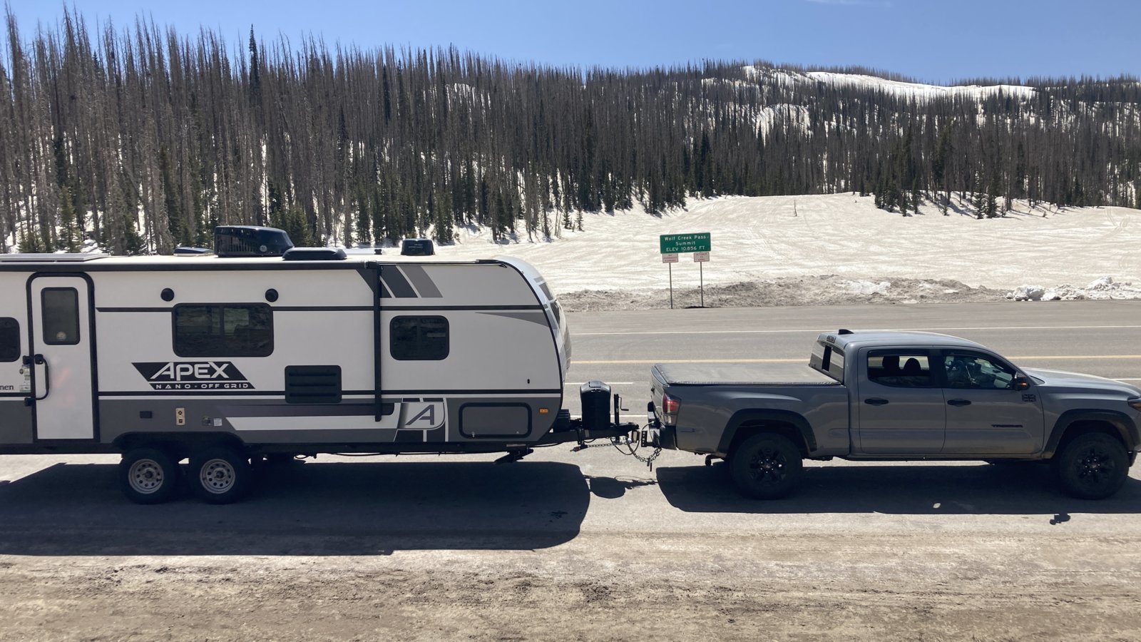

    Look familiar?
    We did it westbound in April and didn’t find it too bad. Eastbound looked like it would be a struggle though!

    We did it at night so can't say it looks too familiar haha! We actually were headed eastbound, headed over to Westcliffe from UT. Once we made it through the pass it was around 2am so we camped the evening in some lot in South Fork I believe.

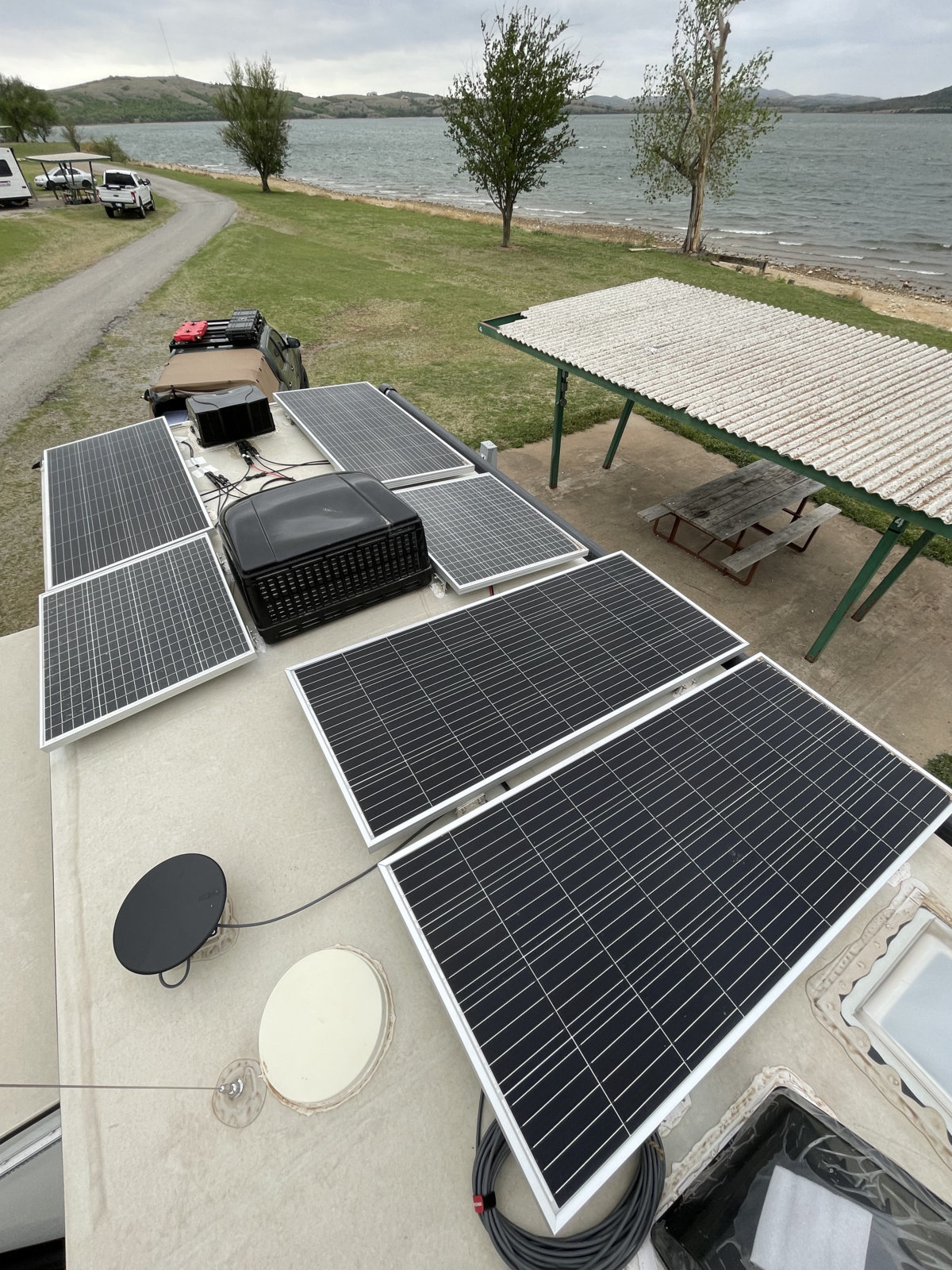

    Also love the trailer, can't believe you can get that floorpan around 4000#. That was our ideal layout but the Winnebago we looked at with it was around 6000#. Jealous of the roof space too... so much solar opportunity. I squeezed in as much as we could but could have used more!

    Wowzers, that's a lot of solar! We've managed with just the one standard panel all this time!! I never got around to finding it but I have a parasitic draw somewhere (I think), 2 standard lead batteries will be down to 1/3rd (via the battery monitor) after 5 hours of minimal lighting usage and device charging. Although I was always impressed that the solo panel would charge them up to full by midday.
    I'm sure with your setup you can charge even on a overcast day.
