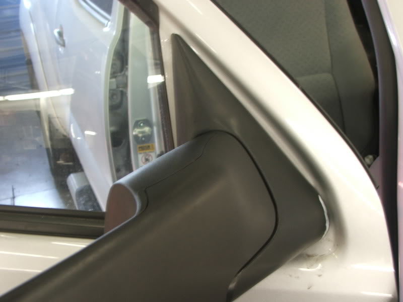

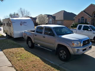

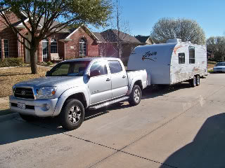

    Well to tell you the truth I've only mounted one set.....they pivot up so you can see around your trailer. The dodgeish ones are in both pictures up and down.
    I do appreciate you don't want me to look like a dumbass though.

    Ohhh!!! They flip up to be tow mirrors? Neat...
    No problem! I like to look out for other people no matter where they are!

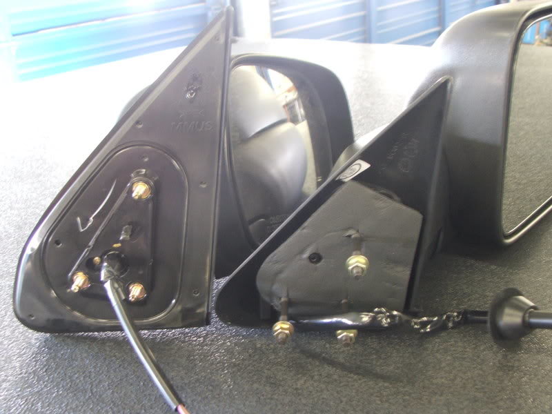

    When you decided to use the Dodge mirrors, how did you go about in looking for those mirrors? Like how they would fit dimension wise? I might try the Tundra dual-arm towing mirrors (they telescope out and similar to the pic below) but I don't know how to see if the holes would line-up like the ones you have now. [​IMG]

    First I checked what I call the triangle measurements, if you look at the mirror from outside you will see a triangle shape that goes up against the door frame. You have to have one the same size or smaller to fit. The late model Dodge mirrors have a triangle that is too large so are the late Fords. I found that the previous gen Chevy and Dodge had a triangle smaller than that of the Tacoma. The Tundra if I remember right is too large. But go out and take a tape measure with you measure yours write it down and then go visit a used car lot with different vehicles. You will find out what will fit. Then all you need to do is find the right type of mirrors that you would like.

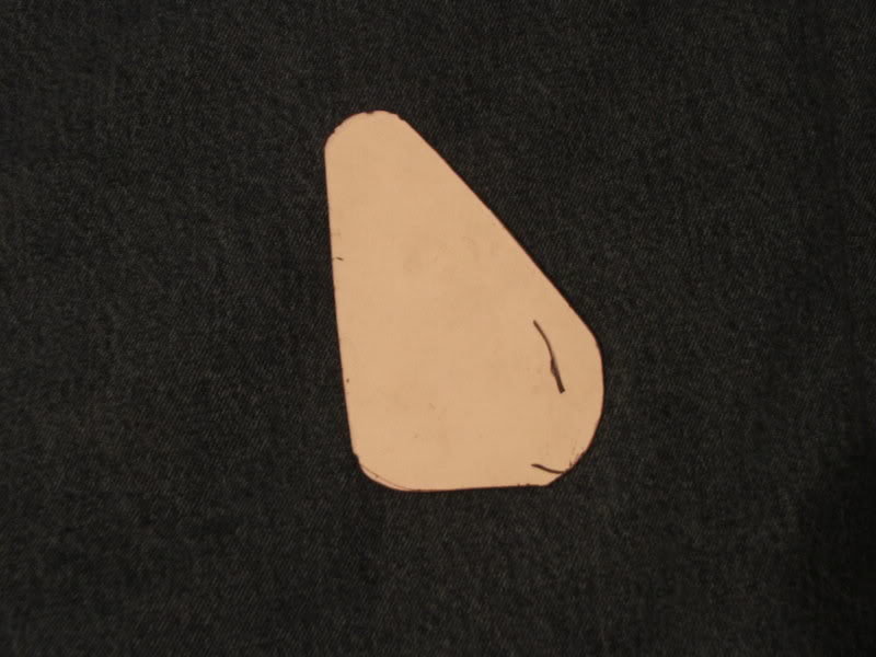

    "Cut gasket material out of a generic splash guard of about 1/8" rubber to this shape to fill mismatch of dodge to Toyota door frame."
    Do you know if the old splash guards from our 2nd gen Tacos will work? I removed the last two remaining guards from my truck because I'm tired of replacing them every two to three years. Them just don't want to stay on and tear off somehow.

    I just went to the auto parts store and got the biggest flat generic mudflaps that I found. Then cut out to the shape of the door area. If the old flaps you have are flat I don't see why they wouldn't work.
