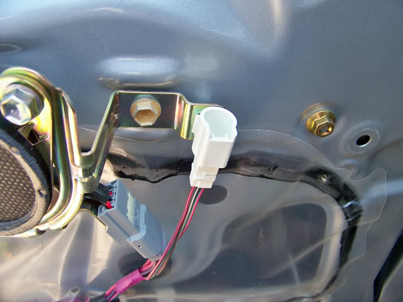

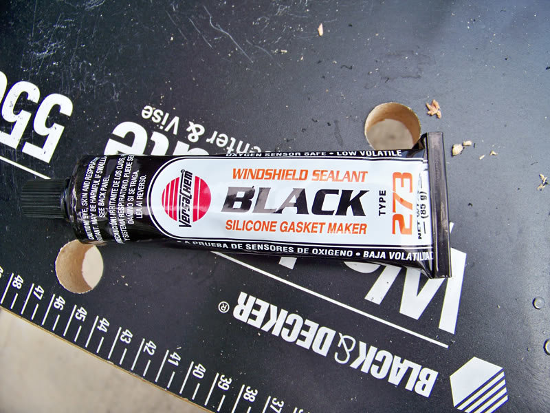

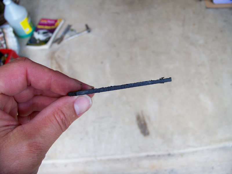

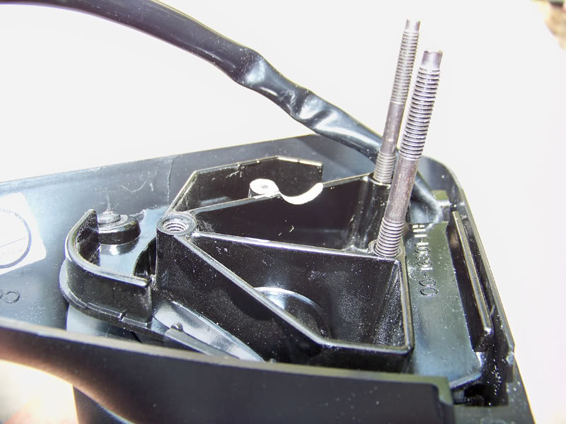

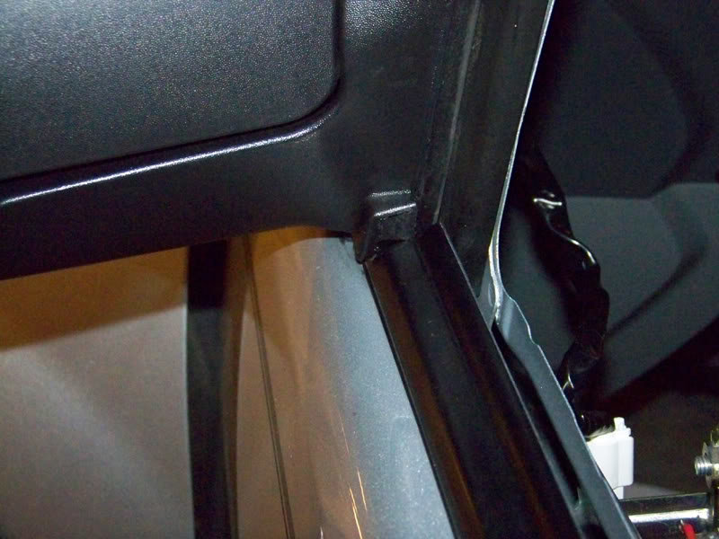

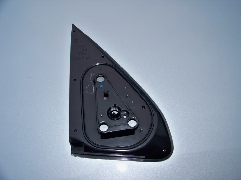

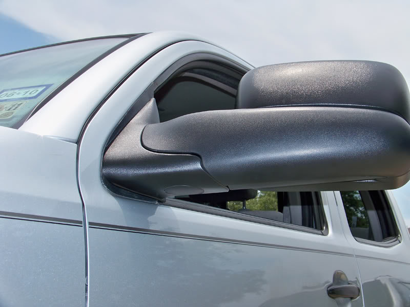

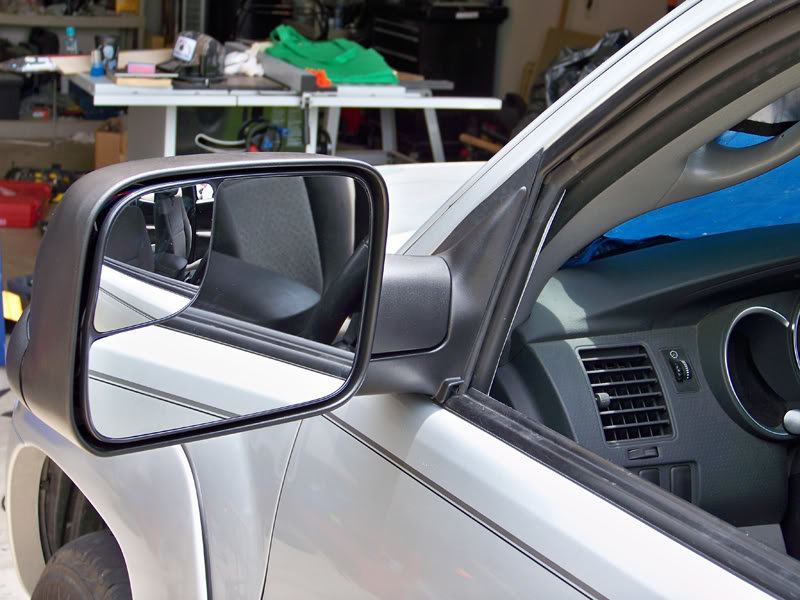

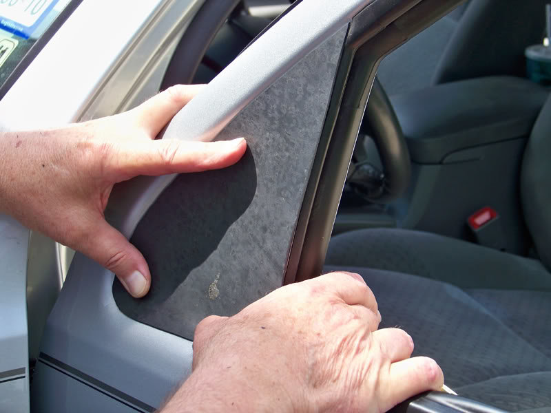

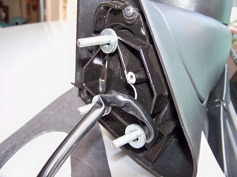

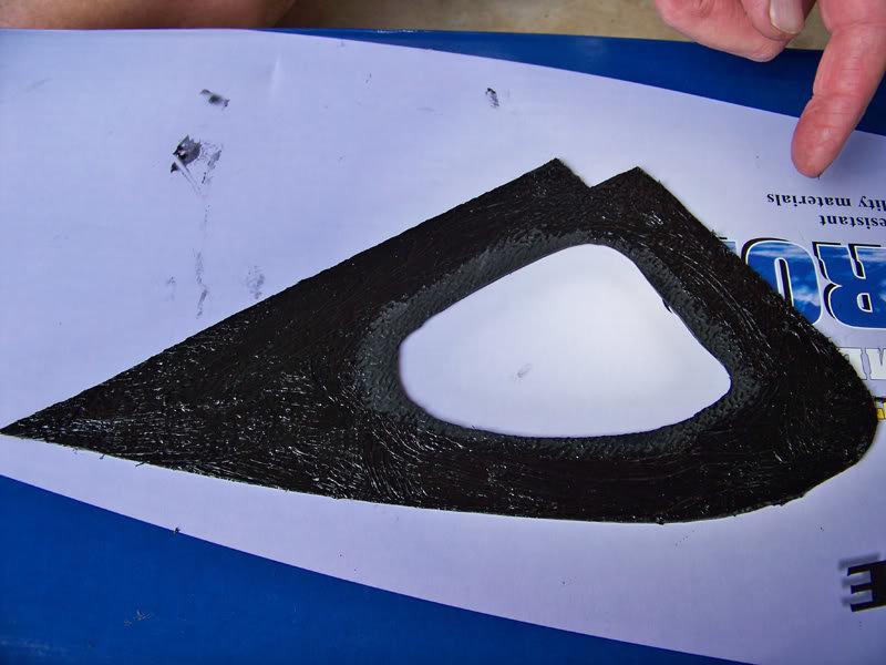

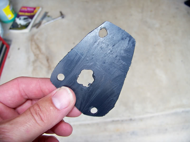

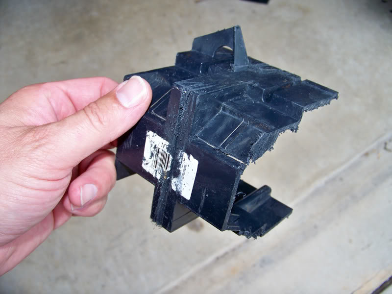

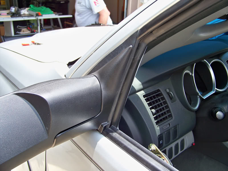

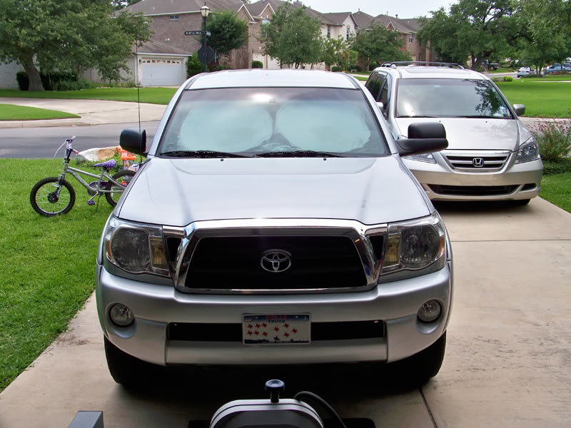

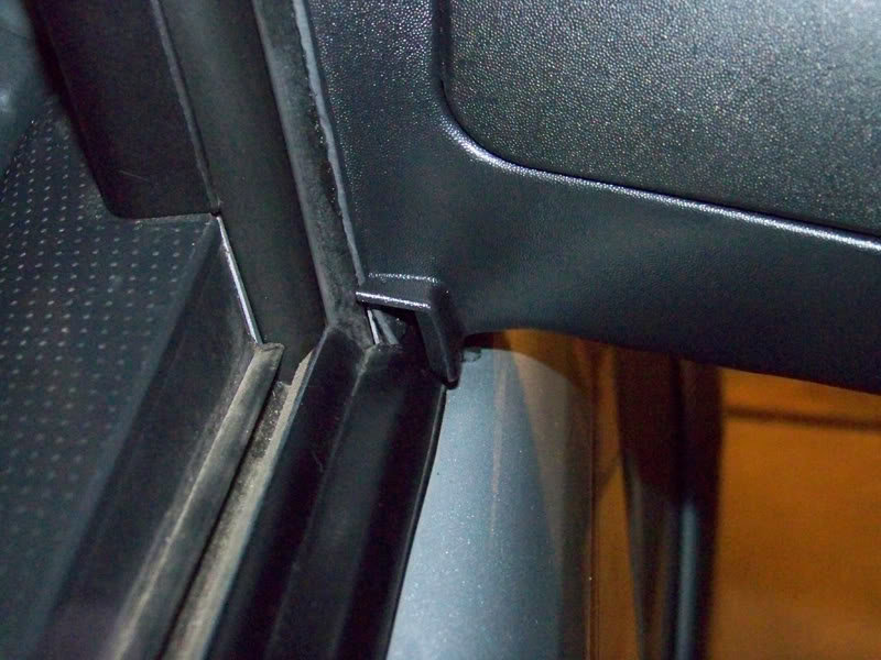

    O.K., I've been wanting to do this mod ever since I read it. So it's been over a month cause I had to wait for the mirrors to get in and to arrange for a long weekend (like Memorial Day) so my dad could help me. My dad being a double "E" (Electrical Engineer) and wanting the mod to be perfect in his eyes did it a little bit differently than 05silverTaco did. After buying the 3/8" semi truck mud flap (bought a larger size for just in case we screwed up on the first few cuttings) my dad wanted to use a much thinner material like 2.8 inches in thickness.
    Template for gasket
    Sealer and used as glue
    Electrical box for spacer (cut off both sides)
    What I used from the electrical box as a spacer
    Spacer after cutting it to size
    We cut this notch out for the electrical cable to fit behind the spacer
    We added these washers for extra support for the spacer (not sure we needed the notch after adding them) but what's done is done
    We kept the original connector on the door and cut off the connector on the dodge mirror and wired it to the other connector from my Taco
    Color codes from Dodge mirror to the Taco door connector
    My mirrors work just as if I never did a thing. Didn't connect heater cause we get very little snow and ice here in Frisco.
    Half way through, did this to show size difference
    Finally mounted (view one)
    View two
    View three
    View four
    View five
    I wanted to fill this hole in (used piece of the 3/8" thick mud flap)
    We wanted a finished look and no chance for water to get in
    Well I hope I didn't forget anything on what we did. If any of you have any questions I'll try to answer them.
    Lynn

    Lynn,
    Your mirror's came out great. Hope you like the versatility of them and enjoy the better size of the mirrors in everday use.
    Mine still work like a champ and look like yours (something Toyota should have done).
    Finaly someone brave enough to do this mod.
    Vince

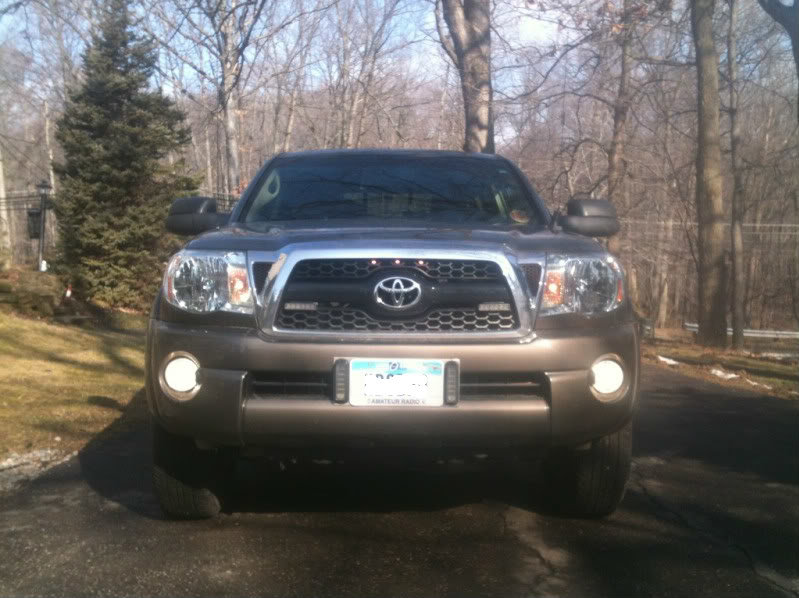

    very nice i tow a 18 foot boat all the time and its like 97 inch wide plus trailer cant see shit in my mirrors this is a great idea good work

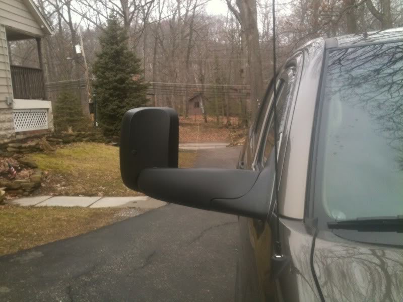

    507
    Henry
    Cleveland
    2000 Excursion 7.3L - Ex '11 Taco DCSB

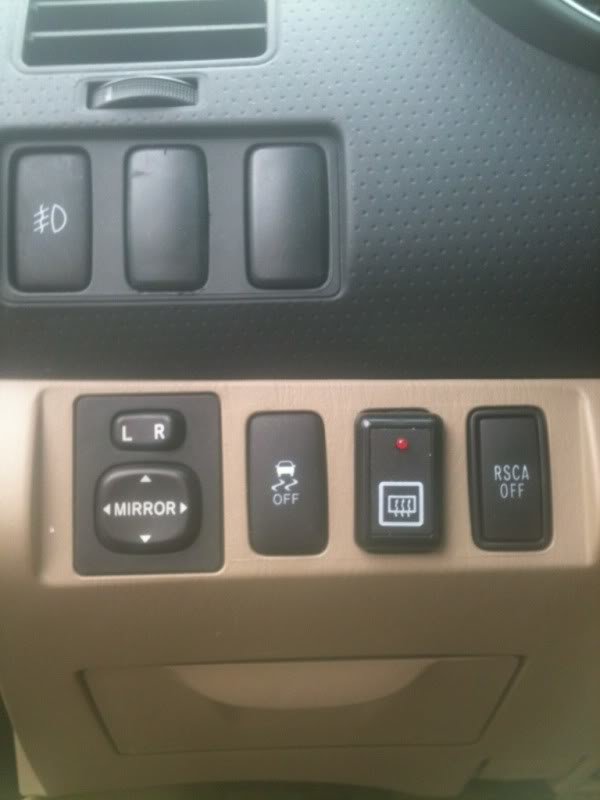

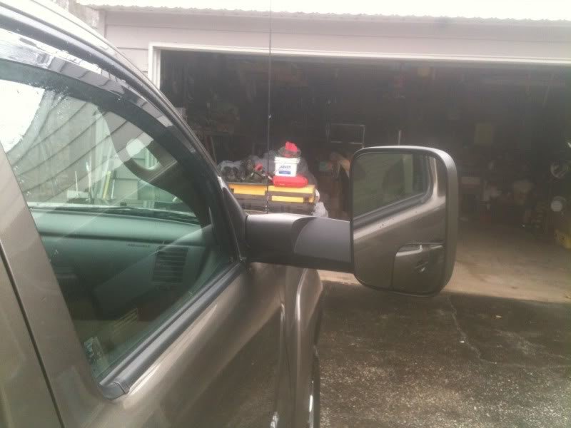

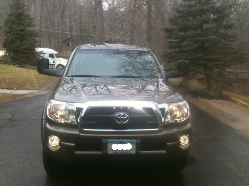

    I installed my dodge mirrors about 2 months ago. I finally got around to wiring the mirrors in this past week. The yellow cheat sheet for the wiring was great. My driver was spot on but the pass was totally different but trial and error got it correct. I kept the factory switch for the mirror controll and bought an after market defroster relay kit. I think it was about 50 bucks. modified one of my knock outs and mounted the flat button to it. I will have pics up soon. The wiring was spot on, the button matches all directions. the gyro in the mirror is nice also. I am getting a new Travel trailer here at the end of march so i will have more pics then. thanks for the mod info to get me started. I hate stock mirrors on these trucks. I couldnt see with my old pop up behind me which is now for sale 3K. in the cleveland ohio area.

    #53990
    507
    Henry
    Cleveland
    Here are the pictures finished
    and the switch for the defroster

    kd8bao, what is the defroster relay for?

    The dodge mirrors have defrosters built in.

    Aah, ok dont need defrosters. So both mirrors work with the stock switch
    like normal?
