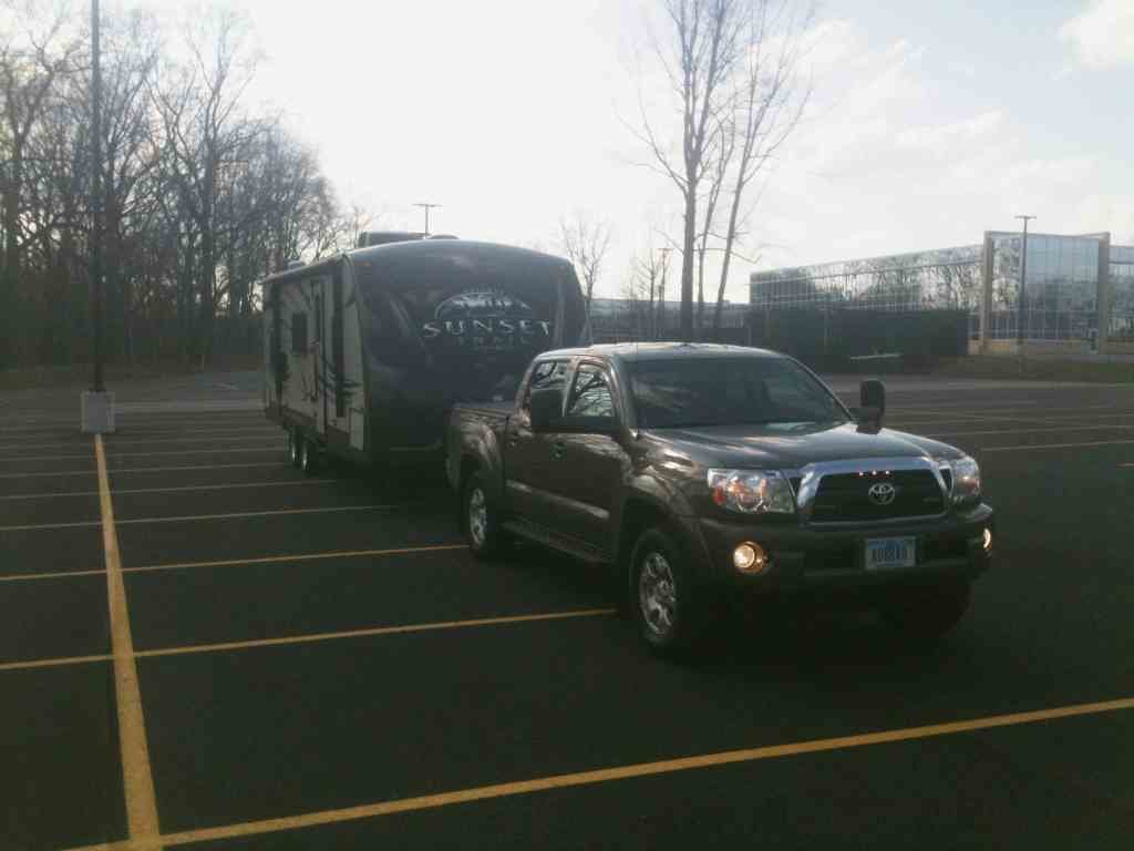

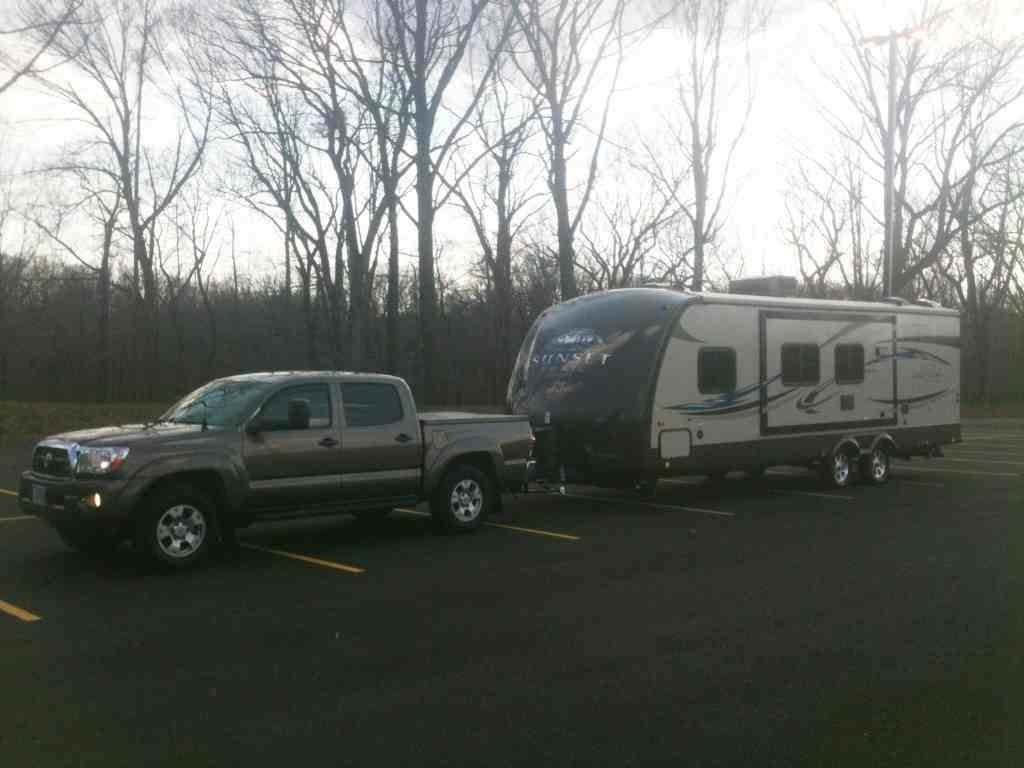

    Here is what you see in my mirrors

    What's the weight/length of that monster??

    It is a 27' box 8' wide 10'-7" tall. Trailer OAL 32' and a lite 5500 dry. Towed it with and with out WD hitch does good without for moving it around and still have 3/4" before bump stops. WD keeps it all level and pretty.

    Very nice. I really have to look into this mod. The view from your mirrors if great.
