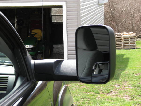

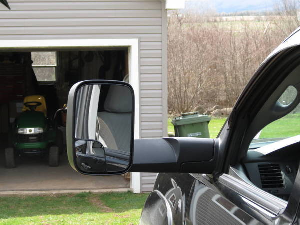

    They are plug and play for certain years, wiring is provided. I haven't connected my blinkers yet, but the wiring is pulled in so I can. Mirrors cycle great. I show a mounted comparison between the Left NEW mirror and the Right OLD unit installed. The foldaway size against the truck clears all drive thru and airport parking kiosks - the lady at the airport thought I was nuts taking measurements, but I was preparing for these babies to arrive.
    Great instructions, packaging and wiring. Heater is a DIY, but the wiring is also provided and they even refer back to our site for the link on how to install your own setup based on one of our members threads...
    BTW - In some states it's illegal to hang fake "anatomy parts" from your vehicles, like a polished set of oysters from your trailer hitch. I suspect once you start unfurling these bad boys in public, they'll find a way to say they are obscene as well...LMAO!!!

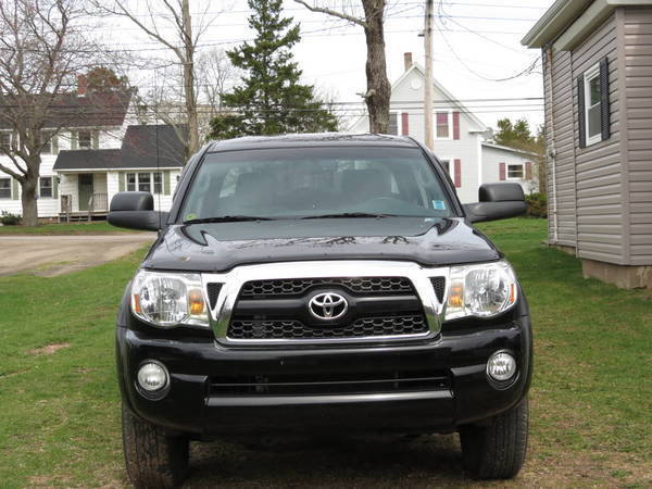

    wingnut, do you have any pics of your truck from the front with those tow mirrors in the normal driving position? Thanks!
