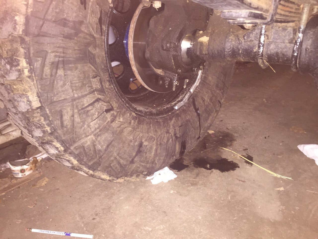

    Leaking diff oil on tire, need to know what is the best seal to use for inner axle seal? Don't think I want to use trailgear stuff anymore.

    Make sure you shimmed the knuckles correctly. I went through seals like crazy before I got it right.

    ^This. I spent a lot of time shimming the knuckles just right and haven't had a problem with the trail gear seals. But first, make sure your breather is working.

    When setting up your steering did you try to evenly split the shims between top and bottom? That will usually get you close enough that you dont have to buy/make the Toyota SST to get the shaft centered.

    Yep, this again. I went through a couple seals before I figured out it was the shims.

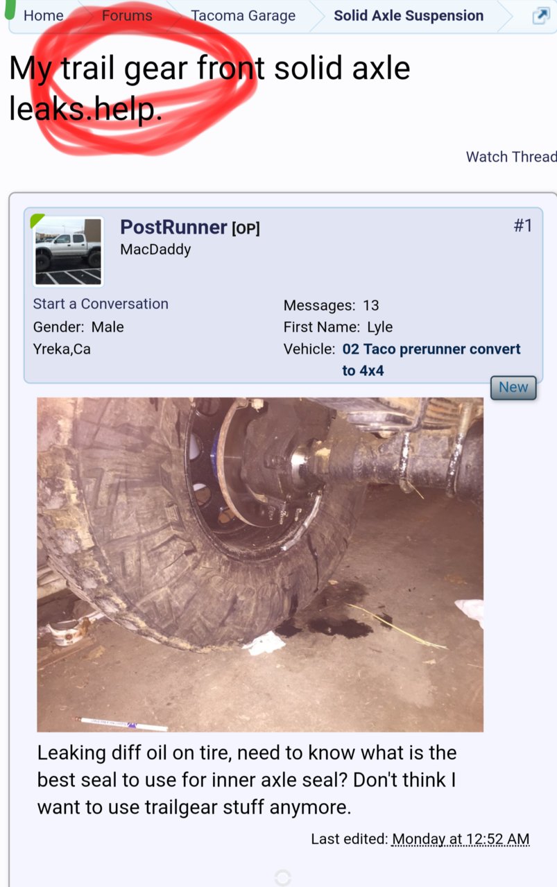

    Circled the problem for you, it's a simple fix. :bananadead:
