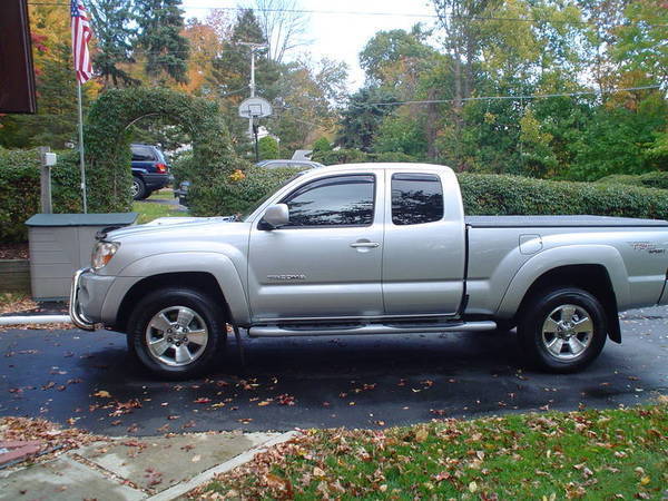

    now this is my truck after the tsb for the rear springs
    i have the 5100s on order and should be in any day
    what setting should i use thanks

    try setting them on 1.75......should level pretty good, cause remember the rear will settle just a bit.

    hey Will has anyone measured to see if it lifts right at 1.75"? When I eventually get mine I may go with the 0.85 setting cause I want to have a slight forward rake.

    i think a few people have measured the 1.75 setting and with the rear tsb, after a little while, its pretty level. the 0.85 will have a bit of rake which wont be bad either.

    Mine were right at 1" after a couple of weeks. :)

    set it at 1.75 as Will said and it's almost level...it still has a little bit of rake at the back,but in a few weeks it will level perfectly ;)...i'll post pictures later at my gallery

    This is my truck with rear TSB and stock front suspension (no leveling needed). It's perfect if you ask me...

    5100's at 1.75.Last time i checked the rake was 1.25"[​IMG]

    To me these look very similar in stance, with different front setups though. Is it me? I know pictures can decieve sometimes. btw both are sweet rides yall.:D

    06 thanks 1.75 it is post pic when i get it
