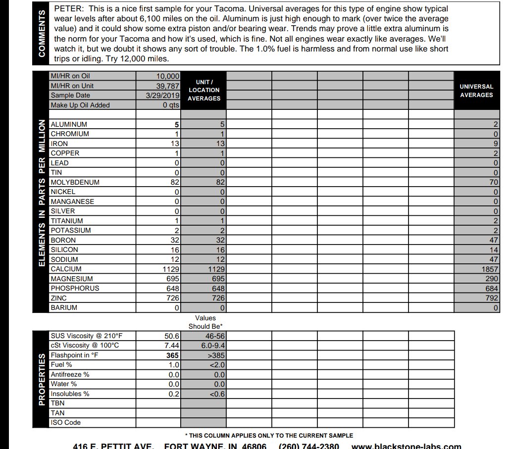

    If anyone's interested, I had a test done on my oil for the 2.7L. 40k on truck, 10k on oil, it had been changed every 5k until that point. Screenshot_20190412-151955~2.jpgPretty happy, I'd been doing 5k just because I enjoy it and it's cheap to diy. Haven't decided what interval going forward but it's nice to have proof 10k is no problem. Mobil 1 0w-20 because it had a rebate going.

    I always buy 2 during the Mobil 1 rebates, helluva good deal.

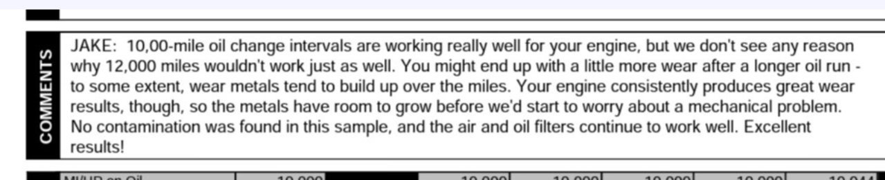

    Update: 80K results are in.

    Great info. Thanks for the post. Has been a concern of mine as my dealer offers lifetime synthetic oil changes every 10k. Looks like ill be good to go

    Looks low on potassium.
    Maybe you should throw a banana in there with the oil changes.

    I appreciate this thread, so thank you for sharing this info.
    Can you imagine the TW shitstorm that would ensue if someone started suggesting 12K oil changes? We barely survive a week without the 10k interval argument coming up as something worth dying for.
