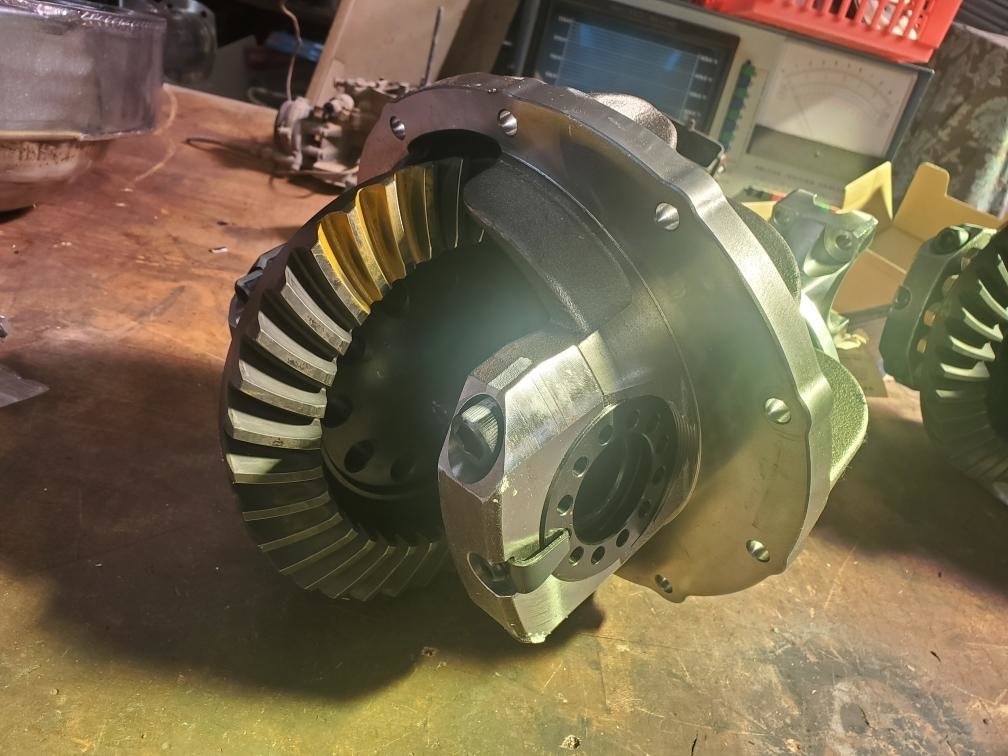

  10. Aug 28, 2020 at 12:19 PM
    #70
    US Marine
    US Marine Semper Fi
    Mar 24, 2016
    #182227
    14,744
    Chuck
    Gallatin Tennessee
    02 Pre Runner supercharged 4cyl
    TRD supercharger , Doug Thorley header , K&N CAI 265/75-16 Toyo open country mud terrain , 15x8 Method Racing wheels , Rancho 3" lift , 4.88 gears , Detroit Locker
    It's also a Drag racing only setup with Billet aluminum full spool and Pro series ring and pinion made from 9310 grade steel and special finish done to the gears
    This is my Street gear setup with Billet aluminum full spool and ring and pinion have a special finish on them
    zoo truck and SR-71A like this.
