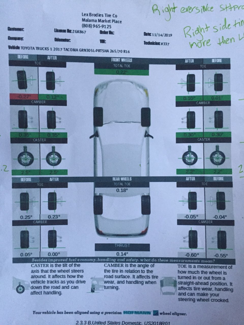

    help! My truck is pulling hard to the right on stock suspension and new tires on stock rims. 265/70/16 stt pros. I have alignment pics of what they did when someone replies. Mahalo!

    Any chance you know stock alignment numbers? L toe .012 R Toe .10
    0.35 L camber 0.30 R camber 2.5 caster L 2.2 Caster R
    front wheels ^
    back wheels toe 0.23 L -0.04 R
    CAMBER L 0.00 CAMBER R -0.55

    Assuming you meant R Caster 2.5, things look pretty close to stock settings. Was it pulling hard right before new tires? Guessing you got an alignment after tire install?
    Edit; right rear camber is farther away than I'd like.

    Here is my alignment picture that lex Brodies gave me..

    Looked that up.. if I find out these alignment numbers are correct then I'm going to call them out on this.. Maybe I just have one bad tire..

    Can you tell me if my alignment picture is correct?

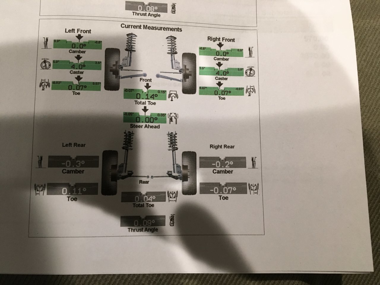

    ill do you one better, I can show you my alignment sheet.... mine tracks perfectly 265/70/17 duratracs on method racing MR 305NV 17x 8.5" 0 ofset

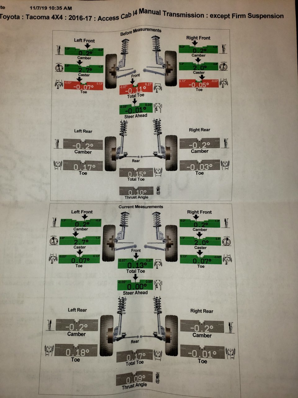

    Sorry for stealing the thread but since you guys are talking about alignment, Can the sheet be rigged? This is mine from today. Me personally I’ve never seen a perfect sheet like this and I don’t even know if it’s doable to have perfect matching numbers3720031C-F3A9-48B4-839D-C8CC73B1D22B.jpg

    They will vary slightly, but should be in range. ) main concern is your castor and camber for pulling one way or another.

    Adam - Your caster numbers should be less on the driver's side than the passenger and yours are ever so slightly the reverse. On a non-crowned road that should be fine but on a crowned road this will likely pull to the right but probably not hard right. You have to decide for yourself how much, if at all you want to compensate for crown and then tell the alignment dudes where to set your truck. Most competent alignment techs will automatically go .3-.5 less on the left. But in addition, it's very possible to have a tire that pulls. Have them re-mount the tires flipped (inside to out) and then put what was on the left on the right and vice versa. If it pulls the other way, then you'll know where the problem is.
