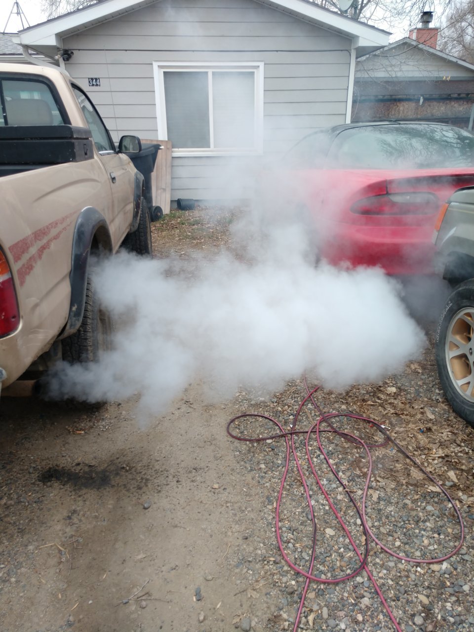

    So I got it running. Apparently one of my plug wires broke off in on the plug so I spent about 2 hours trying to get that our carefully. I went and got new wires and went to start it and it started but is running really rough and pouring white smoke out of the exhaust and idk why it's doing that any ideas?

    Check your head for cracks perhaps. Just a guess.

    I didn't see any but I might have a blown head gasket.

    From my experience with backing support from the almighty internet, usually that would mean you're burning coolant. Which entails something is FUBAR. If you catch it now though, you may be in for a cheap repair and not a large expensive paper weight.
