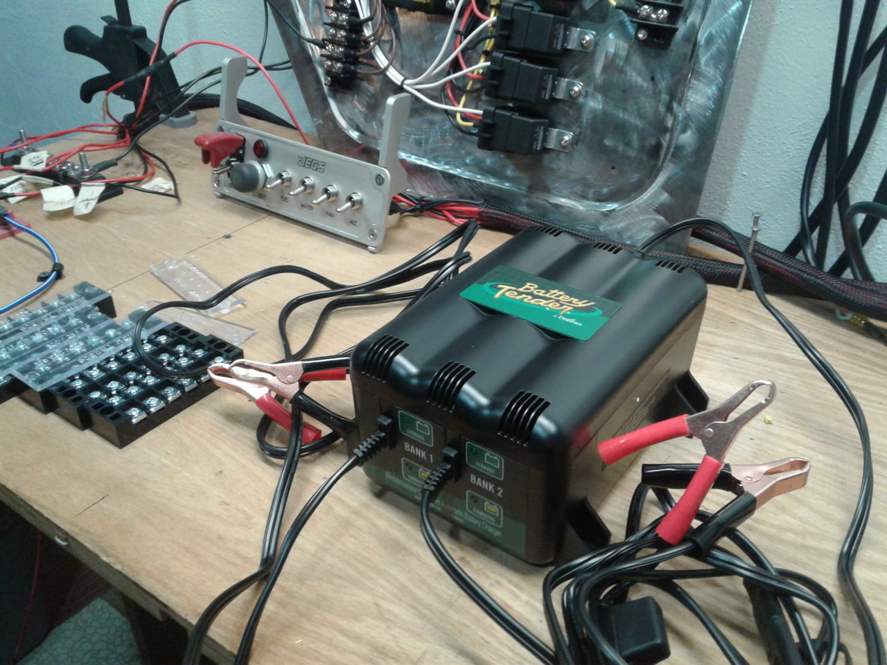

    Yep, perfect if you don't drive the truck. I tell folks it takes 12-15 miles at speed, not stop and go, to get a decent charge.tender1.jpg
    I've got this one
    Zim
    SR-71A and Wsidr1[QUOTED] like this.

    You can get a tender under $10 at HF. Not fancy, but it works. Had a friends Lexus on one for 6 months, no problem.
