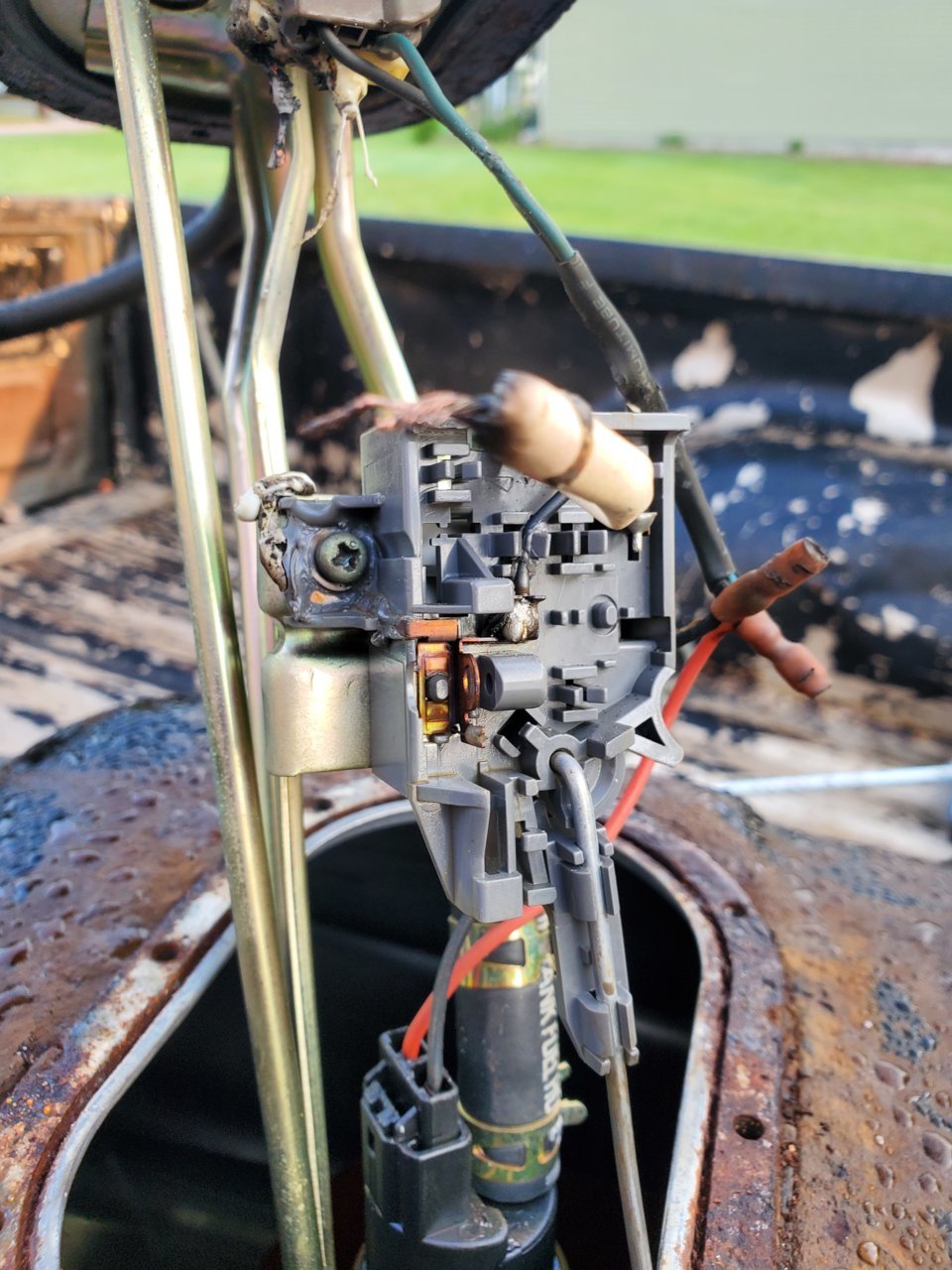

    #Update Fuel pump was bad now I have a brake line to repair. #Riglife
  8. Jul 25, 2023 at 5:51 PM
    O'Silver_Taco
    O'Silver_Taco Well-Known Member
    Aug 26, 2021
    #375390
    4,072
    MD
    98 Dlx Sr5 ext AT Rwd
    3rz to 2Rz bebuilt block and new heads
    I would use a new tank seal.....dont ask me why......

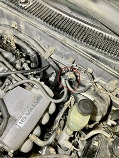

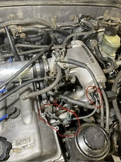

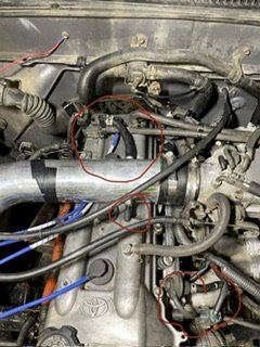

    Pic of what I’m looking for
  11. Aug 18, 2023 at 7:58 AM
    horunner17
    horunner17 Active Member
    Aug 17, 2023
    #431509
    34
    1995.5 Gray Tacoma 3rz 5mt, 2011 Red Tacoma 1gr
    And a couple more, if I could see some engine bay pics with egr deleted and where those lines are supposed to run that would be amazing!! I’m lost with this…

    Hopefully someone will chime in with pics. I would suggest picking up a Haynes manual for your year model. There might be diagrams in it that would help, but on a truck that old, you will need the Haynes manual at some point.

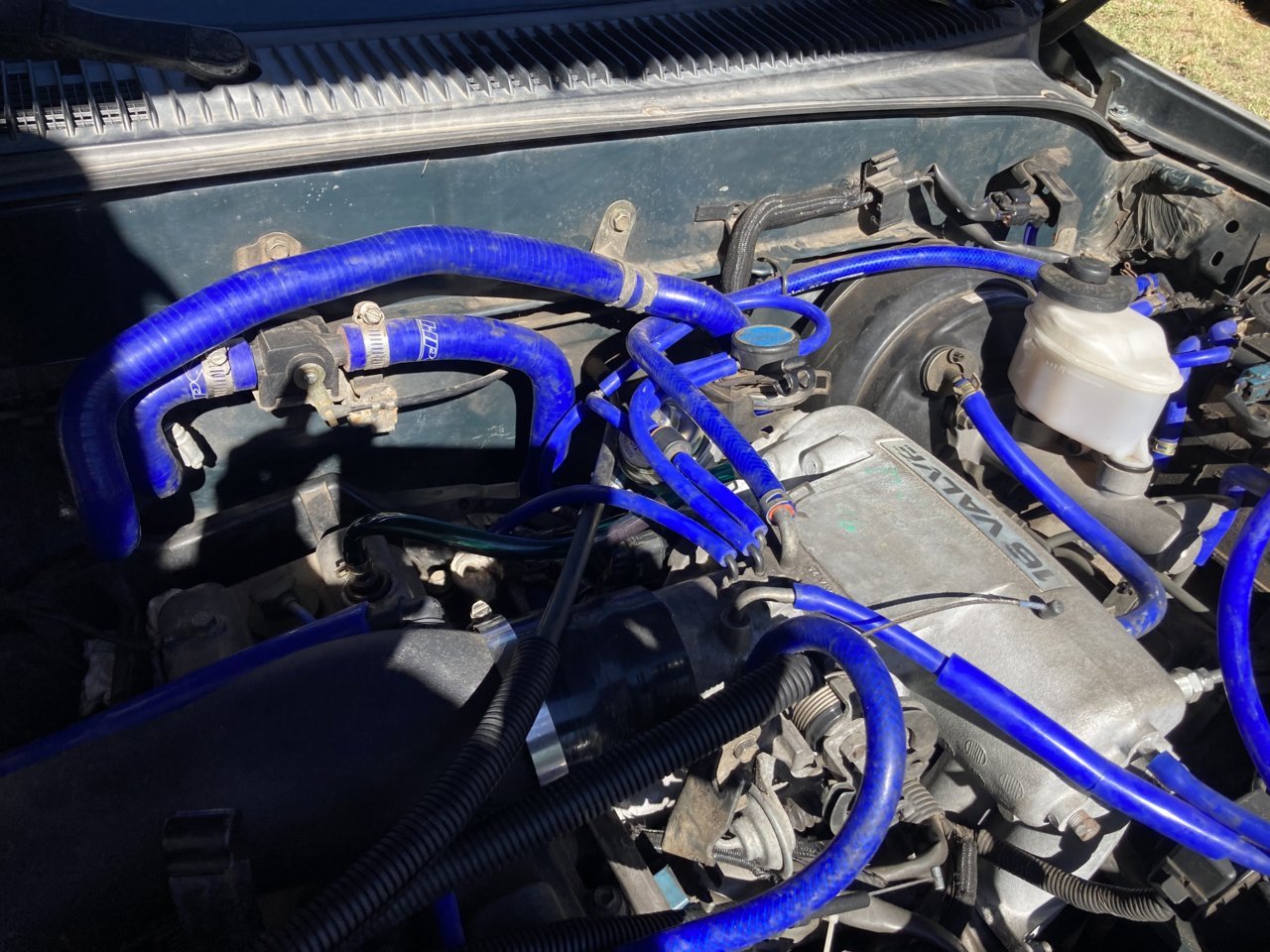

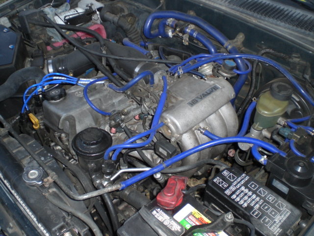

    I think the rear is OK....you have to vent the canister back into the intake....
    but but that front is some weird ass stuff......

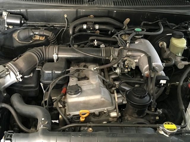

    here's a pic what a 98 looks like.
  14. Aug 18, 2023 at 9:24 AM
    O'Silver_Taco
    Aug 26, 2021
    #375390
    4,072
    MD
    here's mine
  15. Aug 18, 2023 at 9:26 AM
    O'Silver_Taco
    Aug 26, 2021
    #375390
    4,072
    MD

    I have the Haynes book and can’t find a good enough diagram to tell me what I’m looking at and what I’m looking for.
