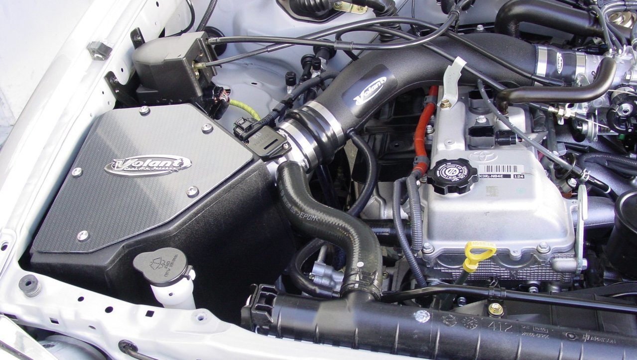

  16. Aug 19, 2023 at 1:16 PM
    #36
    O'Silver_Taco
    O'Silver_Taco Well-Known Member
    Aug 26, 2021
    #375390
    4,072
    MD
    98 Dlx Sr5 ext AT Rwd
    3rz to 2Rz bebuilt block and new heads
    This is what I went with.....however different intakes wont improve anything on low or mid rpm......really pushing at highway up a grade would you see any difference.
    Only caution is on the cold air ones......many way over oil that filter causing problems gumming up the maf sensor wires.......
    Most max at only 1.5 oz oil......
    If you get a cold air intake...get one that doesn't just suck in hot engine air....
    The oem factory one is just fine.....and doesnt set u back $350......
