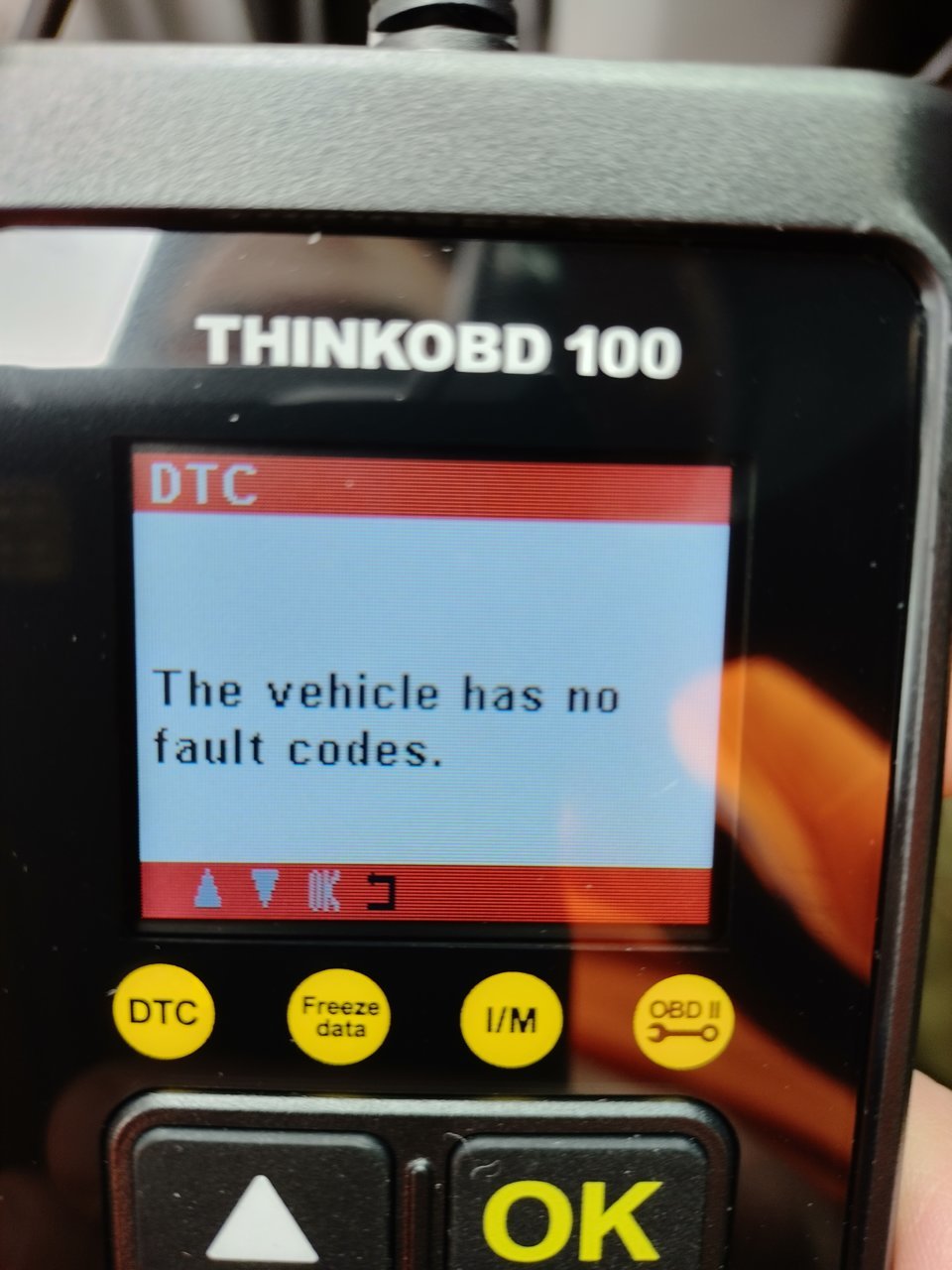

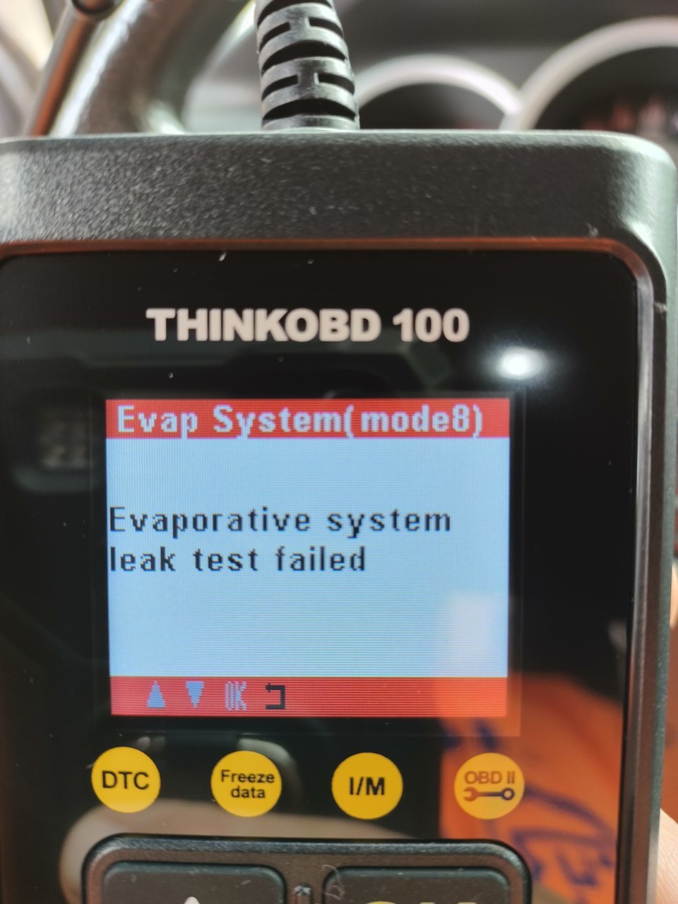

    20211001_135608_HDR.jpg 20211001_140709_HDR.jpg This is comical. One right after the other. Still no cel....
