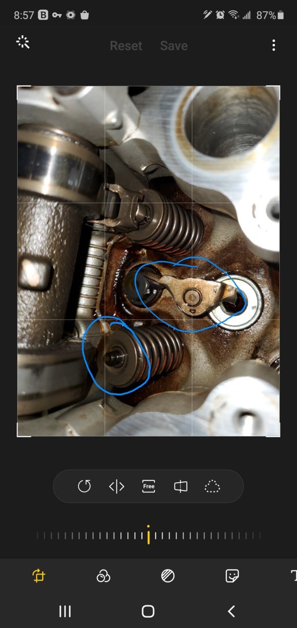

    Fallen valve rocker arm.jpg This is my first attempt at loading a pic on this forum.
    The valve rocker arm is actually for cylinder #3.

    isent the rocker arm under the cam? how is it possiable it can come out of there?

    If I were to move forward with trying to put it back on, is it as simple as it looks? I could lift the cam up just enough to get the rocker arm back on and them put the cam back, while keeping the timing in tact and all that.. right?

    I'd try it and they inspect it in a couple of hundred miles to see if it happens again, then you know there is some sort or clearance issue with the fit.l

    Yeah, I've never seen that before. I think the truck had some engine work done about a year and it looks like they just forgot to put the valve stem cap back on the valve, which is what the rocker arm sits on top of so not to damage the valve stem itself.

    Looks like it wasn't assembled correctly when work was completed before. It it were then it would have been impossible for it to just pop out.
    I do not think you will be able to just "lift up the Cam Shaft" as you would like to do. I don't think the timing chains will allow enough slop to accomplish that.

    I don’t have any experience with the 2.7, but I’m guessing you need something like this and a helper. Make sure the piston is not at TDC when you open the valve. Also make sure the valve goes down when you compress the spring. If you compress the spring and the valve doesn’t move, the keepers could pop out and then you’ll have to pull the head.

    But I’d have a buddy pressing on the valve stem just to be sure the valve goes down.
    (Don’t use your finger. Lol)
    Then hope like hell nothing flys apart.

    If the valve cap wasn’t on before the rocker arm fell out it had to making some kind of noise. Definitely never seen that before. Check the cam lobe for any nicks.
