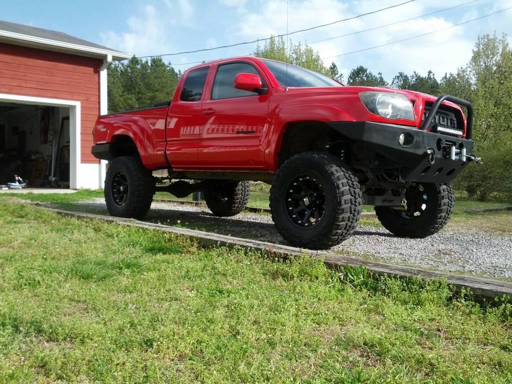

    Current Photos!

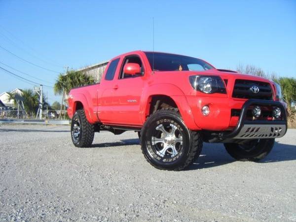

    First Pic then with first mod!
    A pic of it a year after i bought it with a Toytec 2.5" Spacer lift w/ AAL on 16" Dick Cepek DC_1 Black wrapped in 33x10 R16 Maxxis Buckshot M/T

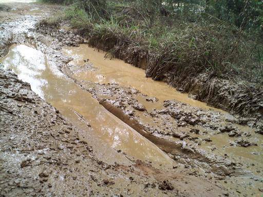

    Mudding at Fort Benning
    The cause to this ^^^ That right side buried me to the frame.. it took somewiggling!

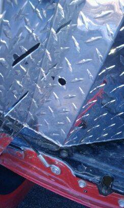

    Kobalt Slim Line 1000 series Truck box Write Up.
    I hated the chrome so i bought a quart of Herculiner. That stuff is amazing! (Make sure the weather is right or the drying process will be a pain in the @$$)
    After i drilled out the rivets for the latches and the "Kobalt" name I took "Krookz" advice and sprayed a heafty amount of Clear coat on the inside of the box to prevent the aluminum from rubbing off on everything! Then i began to scuff! I went with a steel brush! Cheap and very effective!
    Then I figured out a way to mount it. I bought 2 - 3" long 1/2" Carriage Bolts that fit perfectly in my track system. Then used a washer and a Nylon lock nut to secure it.
    Then measured close to center where the bolts would lock into the notch in the track system and then drilled the whole!
    After that i began to Herculiner it. Becasue weather conditions did not permit and i was very unpatient (3 days of Herculining later) i decided to finish (seal the herculiner) the box off with Textured satin black Rust-O-Leum spray paint. I did 90% Herculiner and then basically took the shine off with the paint.
    The finished product! (I'll get a better picture soon.)

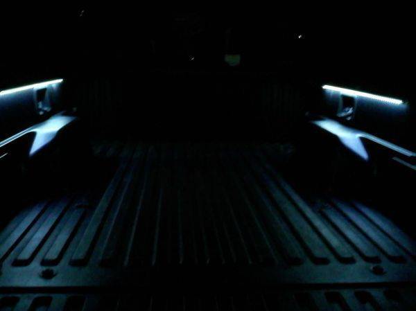

    Bed Lights
    Bed Lights (Not the greatest pic but it does light up the whole bed)

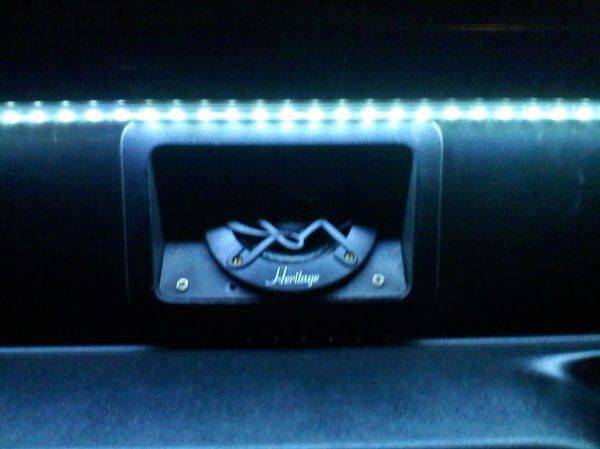

    Bed lights on with pic of my 4" Speakers in the back.
    Bed speaker lights... Don't judge.. (Ignore the music its all i had in my truck since my iPod got stolen)

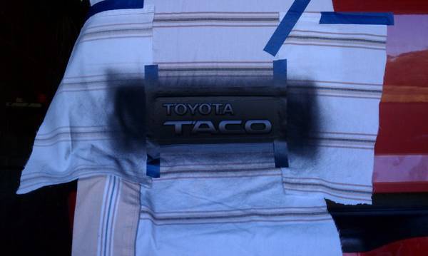

    Plasti Dipped My Badges
    After about 1 or 2 coats on rear
    After 4 Coats (Final coat was thick)
    Side

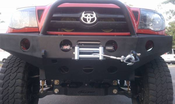

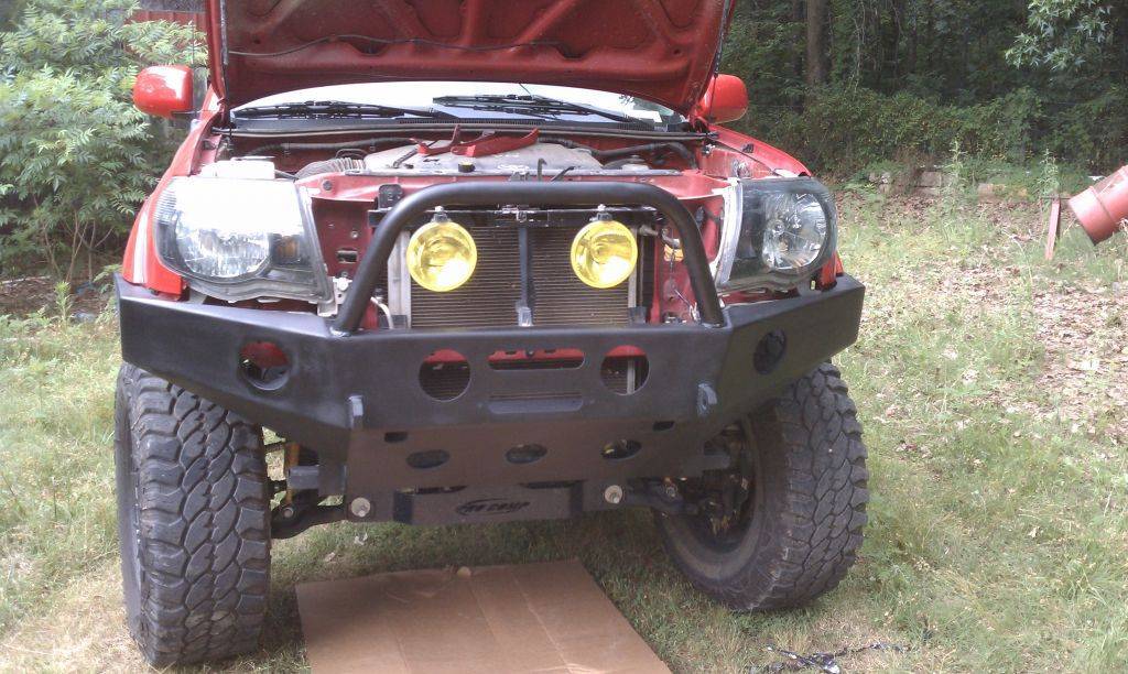

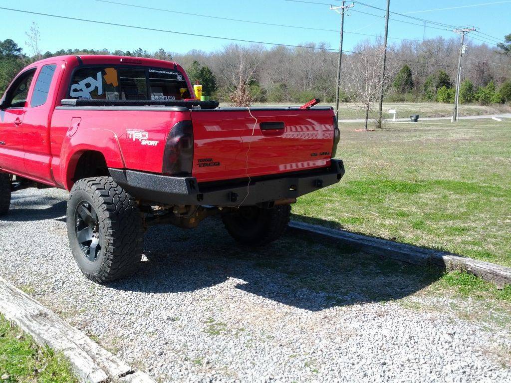

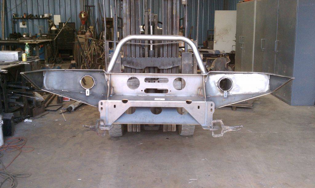

    Relentless Fab Armor!!!
    Arrival Day
    I ordered my hoop late so I had to take it to a weld shop to have them put it on..
    Priming it in the back of my apartment! :cool:
    Disassembleing
    Let there be armor!
    These things make people on the outside world say WTF!
    Smittybuilt XRC 8 Winch
    Test fitting after the first cut
    All trimmed and sealed! Testing out the clearance!
