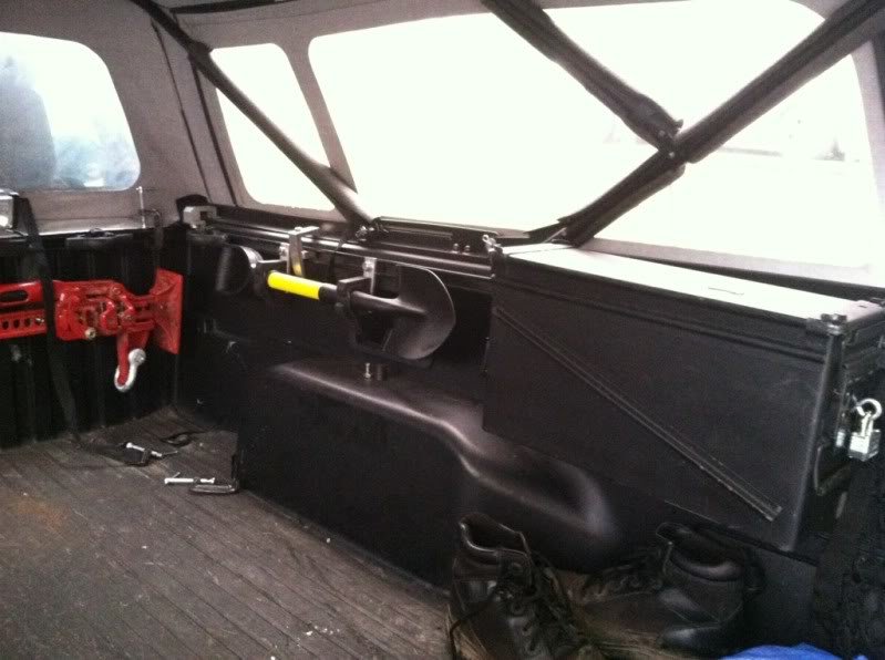

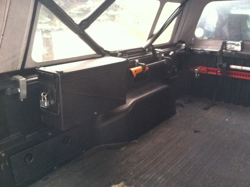

    this was my weekend project. (well sunday really.) the ammo cans were in the truck already. i removed those first, and made them mount about 1/2 an inch higher than they do now. previously, they would slam into the bed sides with every bump. i also installed 1" long rubber feet on the back side. now i notice almost no noise from them.
    then i moved my axe and shovel. they were mounted previously, but i moved them to get everything to fit better.

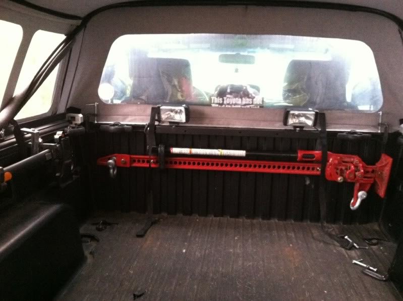

    next, i made a light bar with some super cheap driving lights from harbor freight. we'll see how they hold up. i have not finished the wiring yet because i have not ordered my switches yet (ooops) but the bar is finished and mounted.
    lastly, i made some brackets to mount my hi lift and i installed 2 shackles to the hi lift as well. ( i bought it with winching intentions). i mounted the rubber feet to the backside of these brackets as well, there is limited movement when hitting bumps....thank fully.

    i cut a couple pieces of aluminum i had laying around and mounted some quick fist clamps to them.
