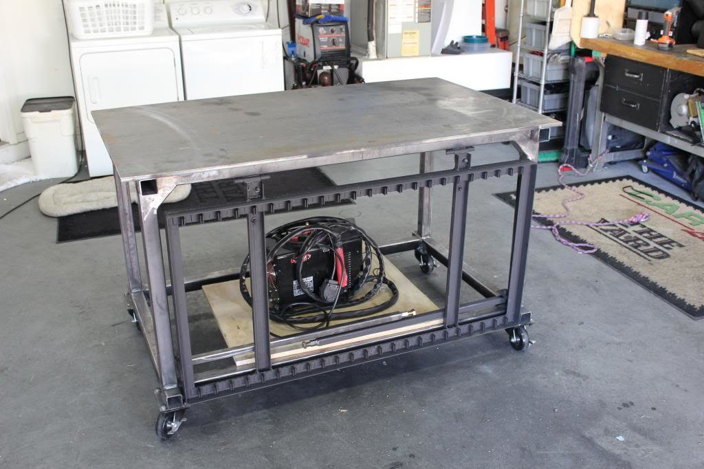

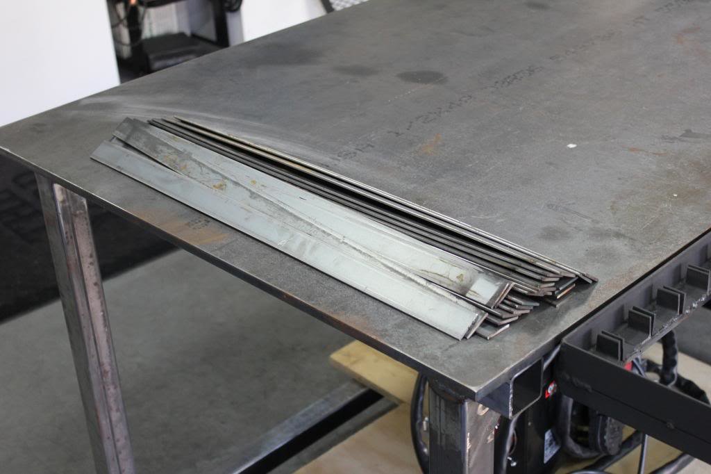

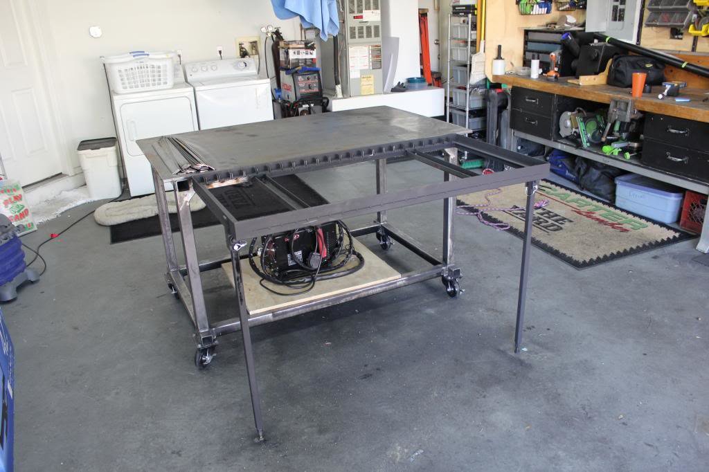

    I needed a welding table and a plasma cutting table, but I did not have room for (2) separate tables in my garage. So I came up with my idea and built it. I still have some finish work to do like shelves, vise, outlet boxes, etc but here it is so far:
    Welding table

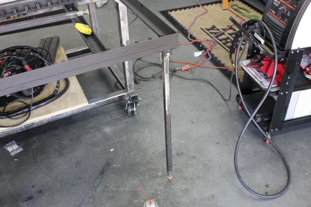

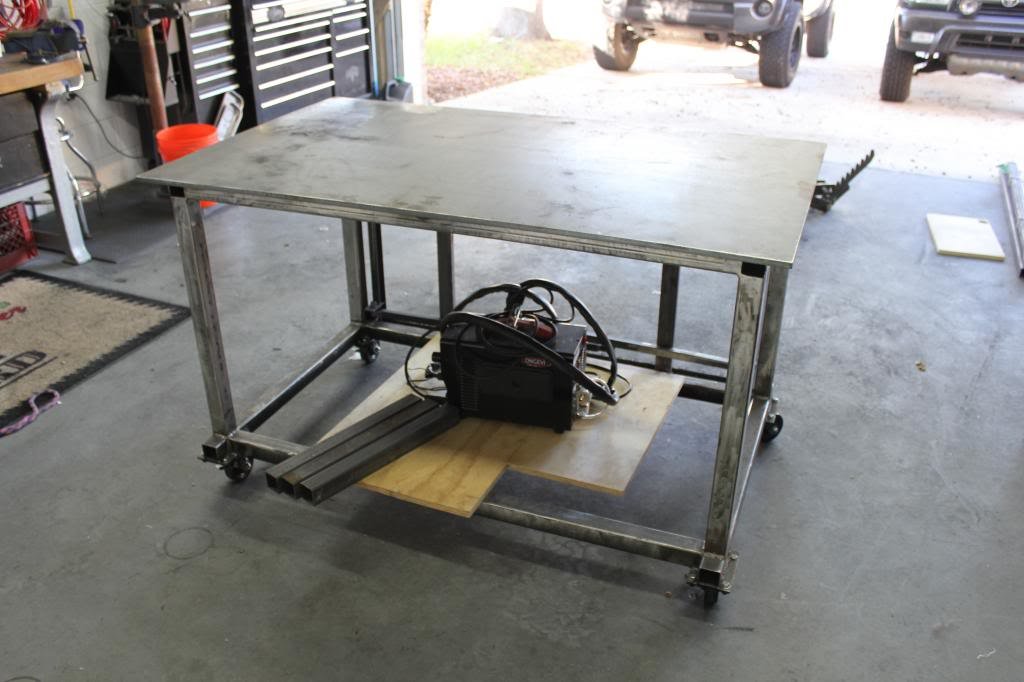

    Flip side of table with fold down plasma cutting table
    The legs fold in to stow and out to support the plasma table

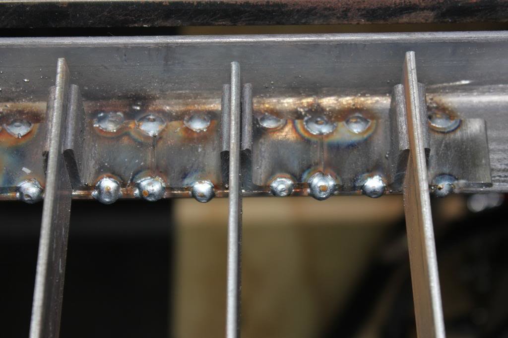

    The slats are sacrificial and removable

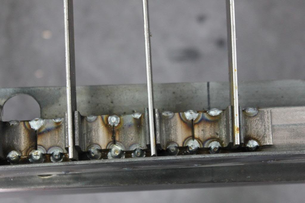

    The slat holders on the table. This part was pretty tedious...
    With the slats put into the holders

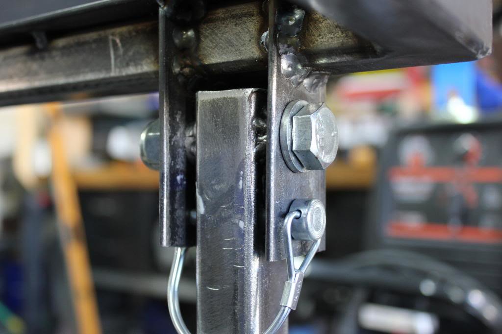

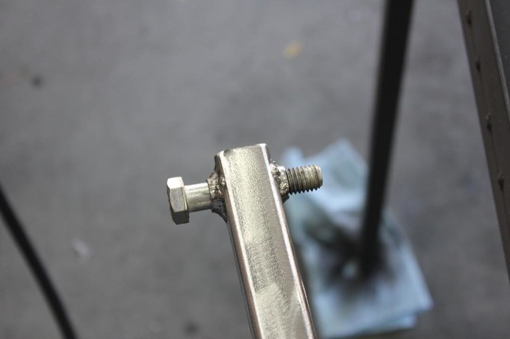

    The sleeved leg swings on a bolt and is held in place with a pin when extended

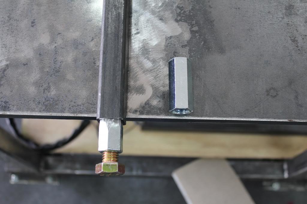

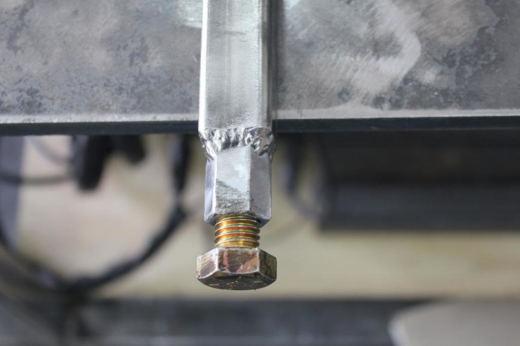

    The leg's height can be adjusted to level out the table if needed. This is how I did that:
    Result
