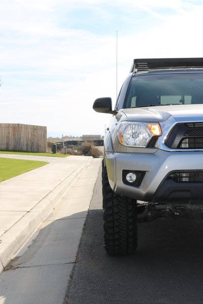

    TRUCK AS IT SITS NOW:
    45FB6FFE-88AC-4366-BD48-D4760BF7206B.jpg 80CA810D-B5EF-4C2F-8036-AFA051A302BA.jpg

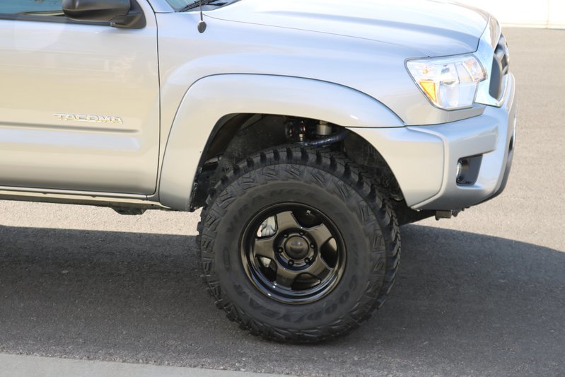

    Wheels and Tires:
    285/75R16 Goodyear Wrangler MT/R Kevlar
    SCS F5 in Gloss Jet Black
    Front Suspension:
    ICON Ext.Travel Front Coil-Over Shock W/ Remote Resi CDCV
    Total Chaos UCA
    700lb Springs
    Wheeler SuperBump Bumpstops
    Rear Suspension:
    ICON 2.0 Rear Reservoir Shock Extended for OME Dakar Leafs
    OME Dakar Leaf Springs
    All-PRO U-Bolt Flip
    Performance Rear Brake Line Set, +2"

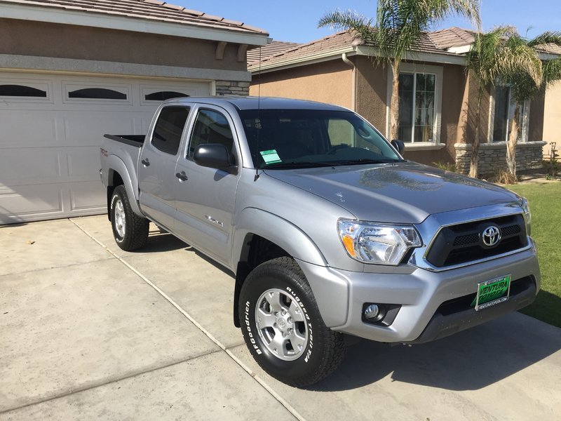

    TRUCK PRUCHASED ON 05/03/2015:

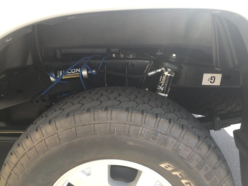

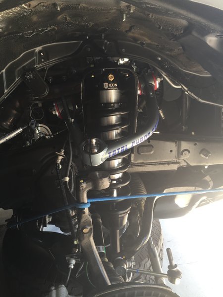

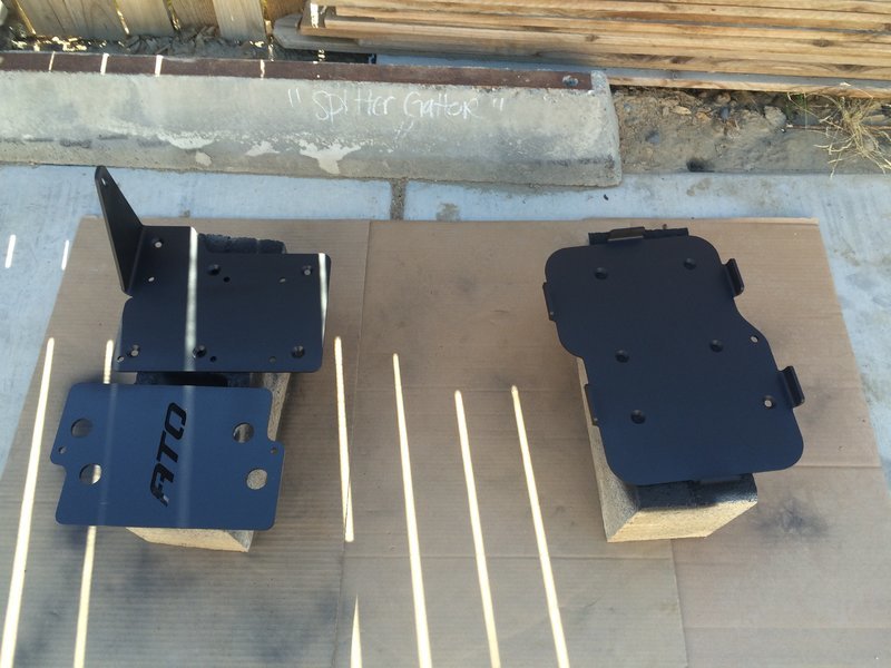

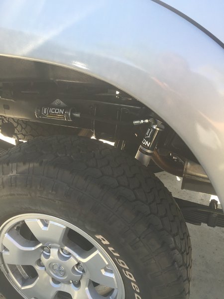

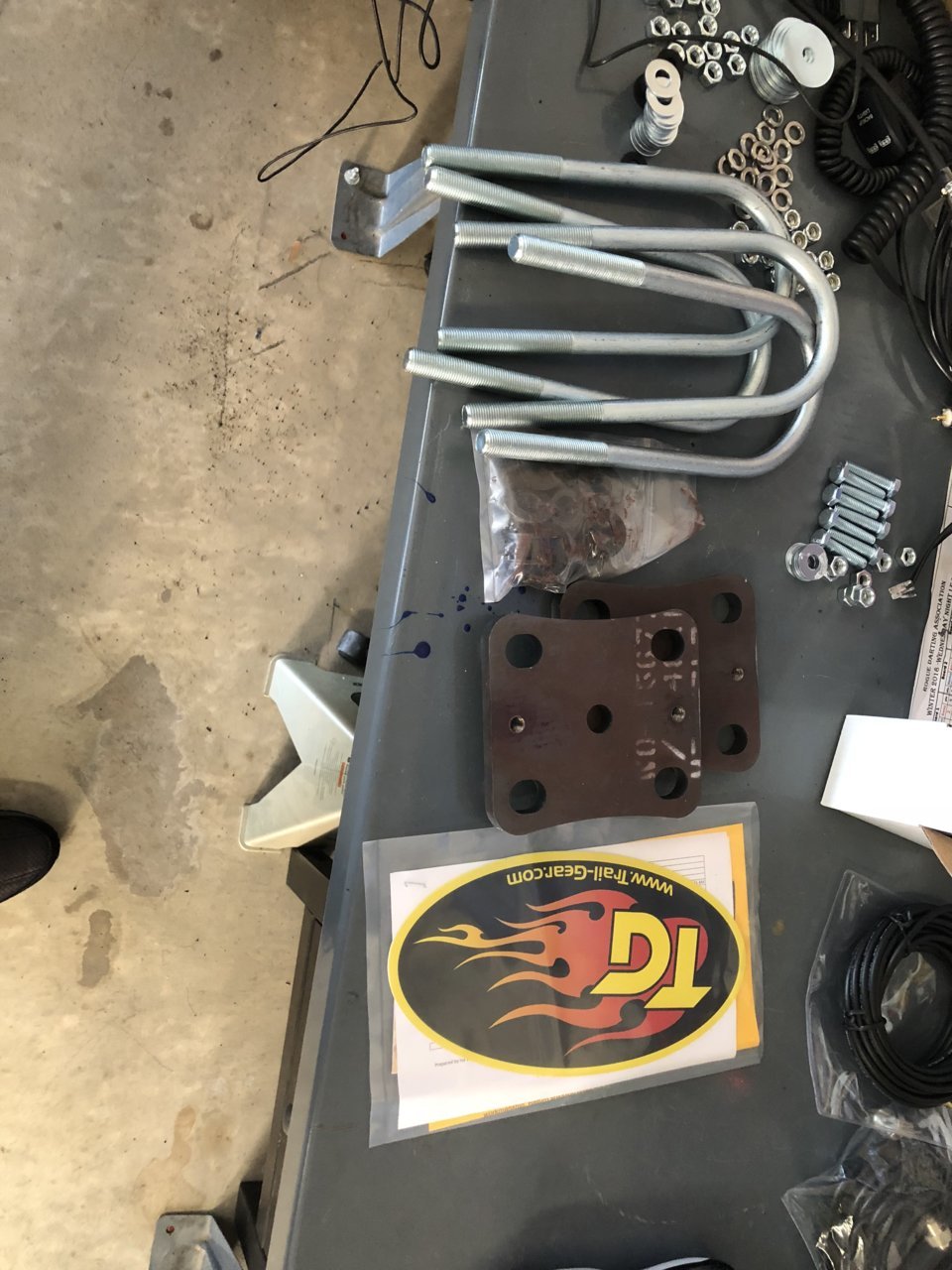

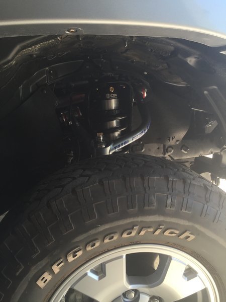

    The first modifications I did were the suspension and dual battery setup.
    And here is them going onto the truck.
    Missing the mounting bracket, metaltech had one overnighted.
    Completed and also installed the softtopper.

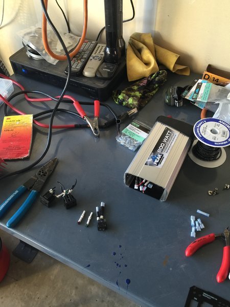

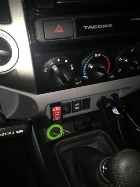

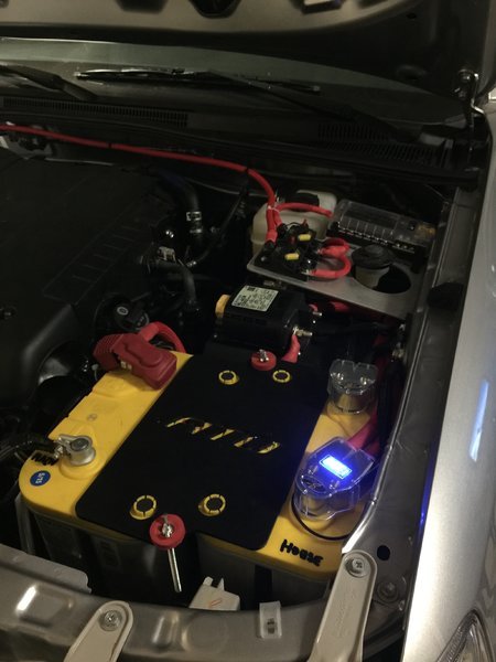

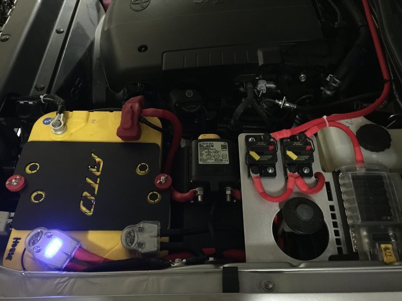

    Next was the dual battery setup:
    Sorry I have do not pictures of the process.

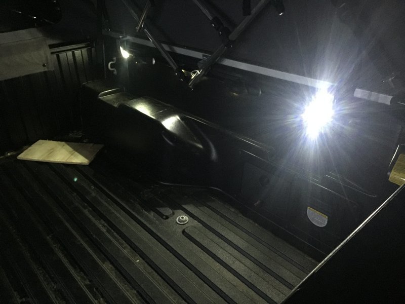

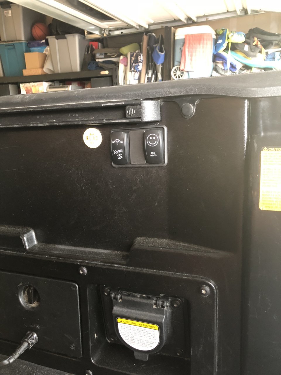

    Bed Lights
    Bed Fuse Box

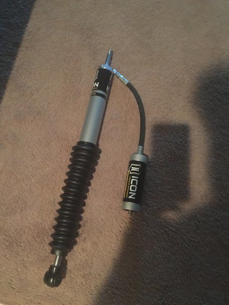

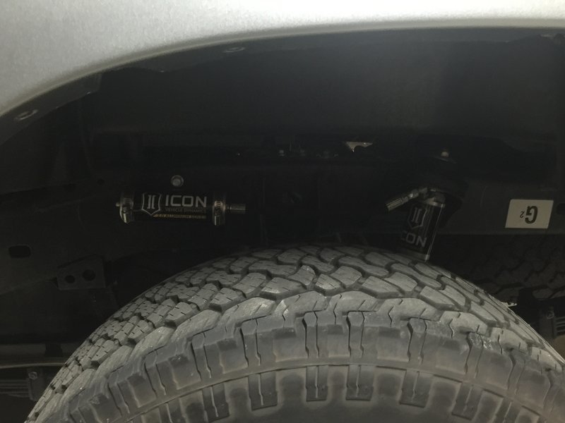

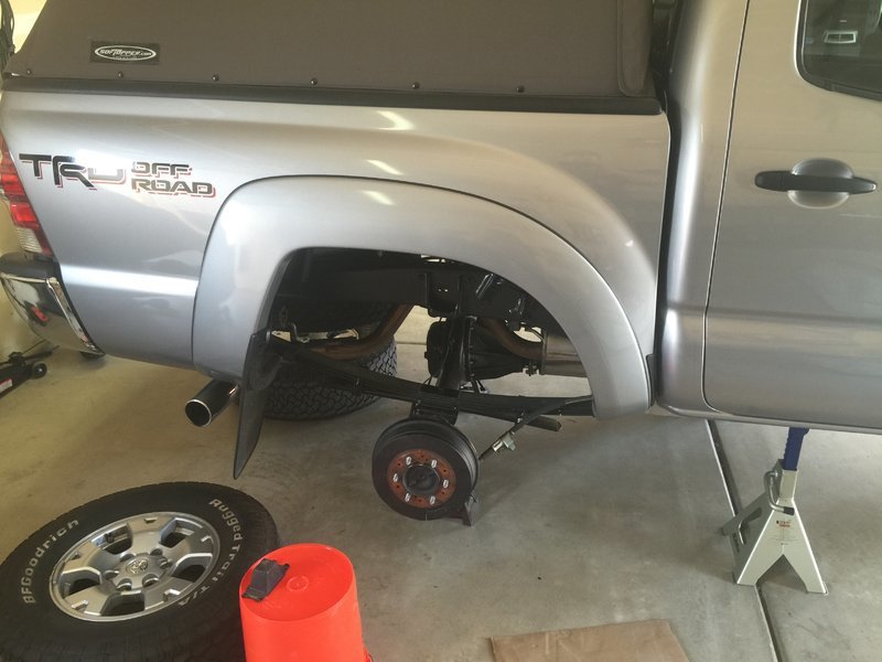

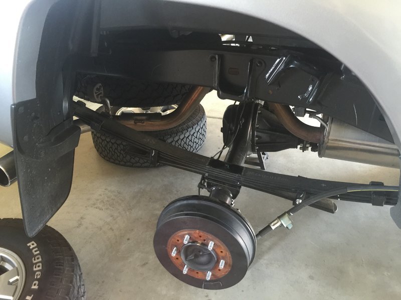

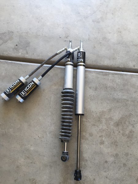

    After the trip I replaced rear shocks since the ones I ordered were the shorter version.
    The shocks only have about 2500 miles and I still have them if anyone is interested. I just need to clean them up a little.

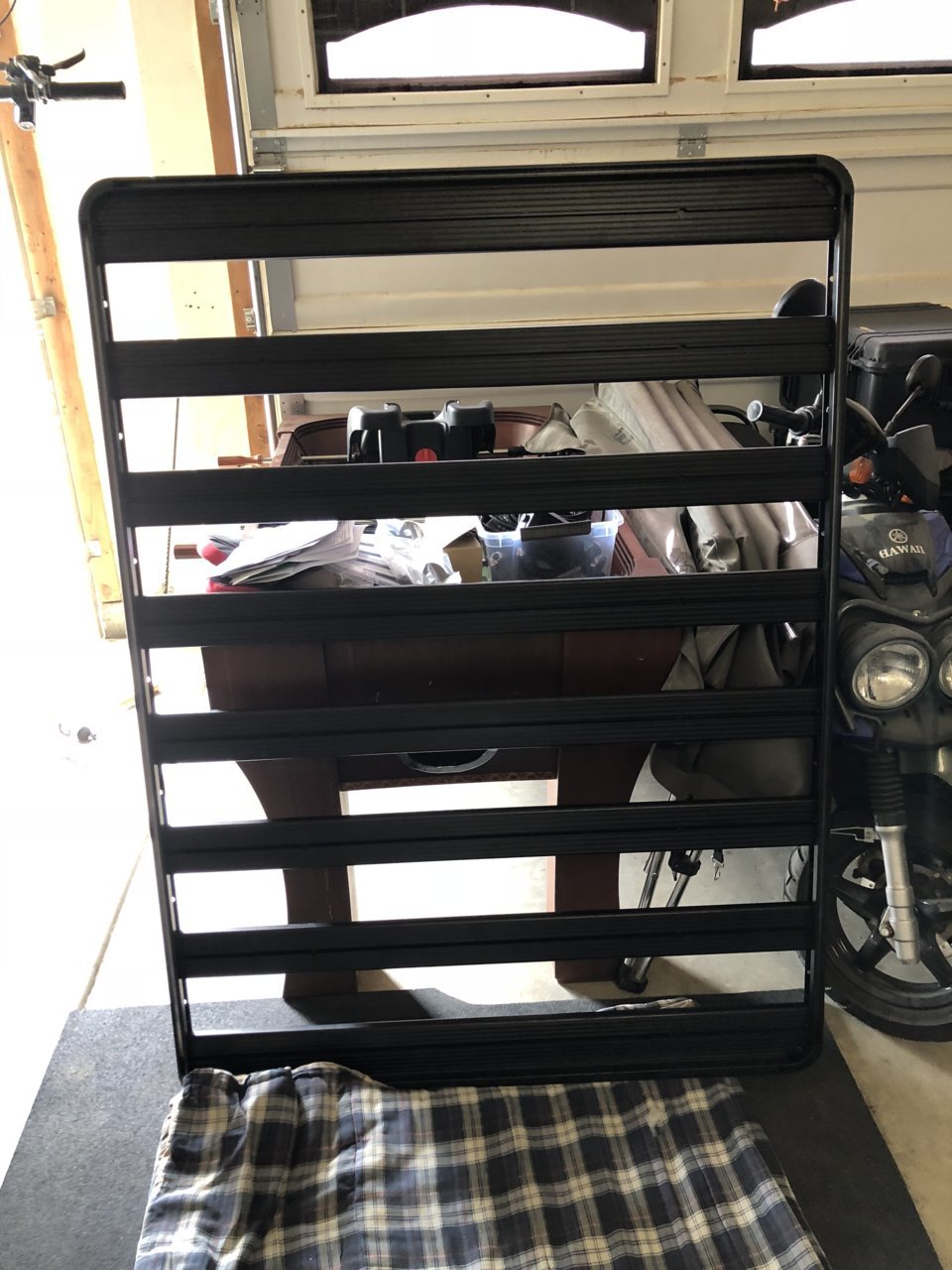

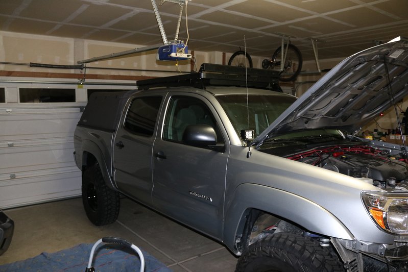

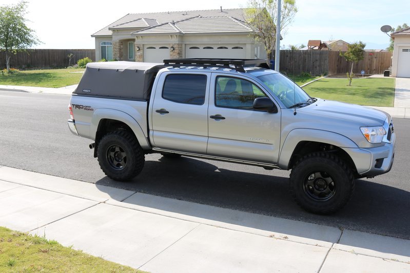

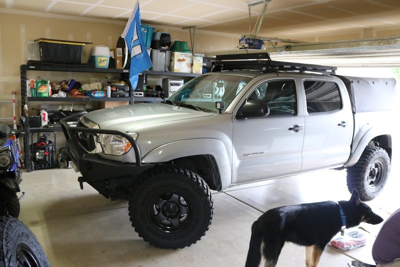

    The roof rack installed.
    Lots more to come!

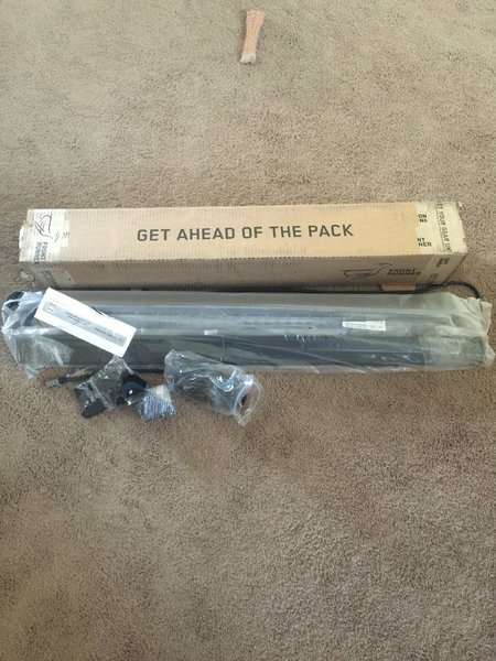

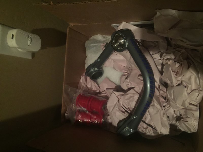

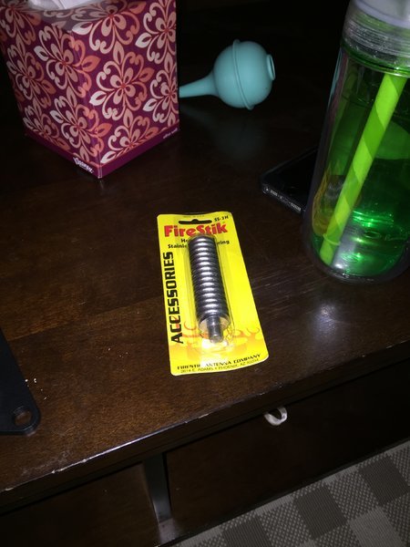

    So to catch you all up parts have being arriving at the house which has been a delight to my dog Eva who just loves to bark and run to the door. It is probably a scary sight from the delivery persons perspective.
    40" Light bar from FrontRunner
    Rigid D2 Flood lights purchased from CBI fabrication
    Cobra 75 WX ST CB radio/Firestik antenna

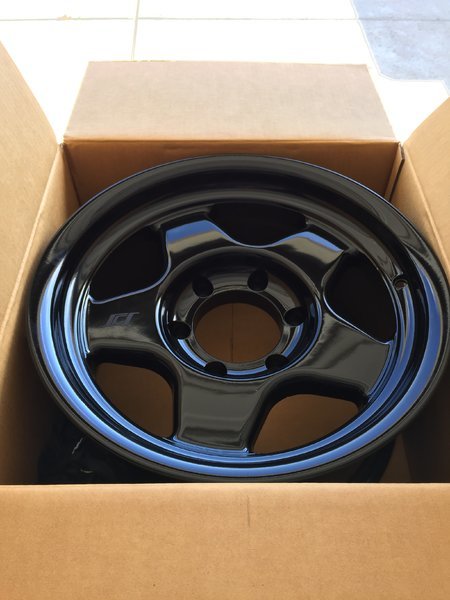

    SCS F5 Gloss Jet Black 16" 4.5" Backspace

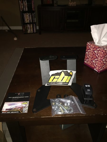

    Switches from OTRATTW and Switch Panel from IGGYCORP
    Ditch Light Bracket from CBI.

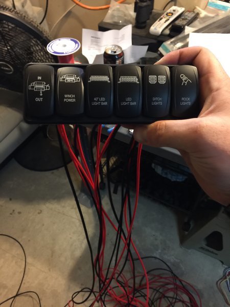

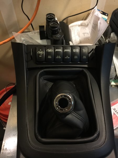

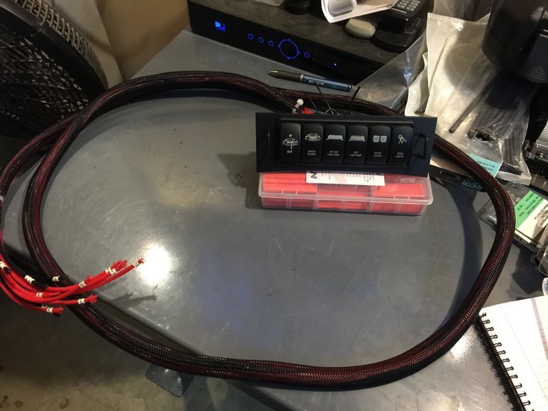

    Got the switches wired and installed.

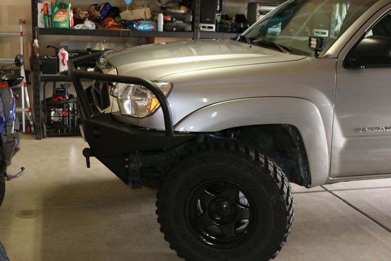

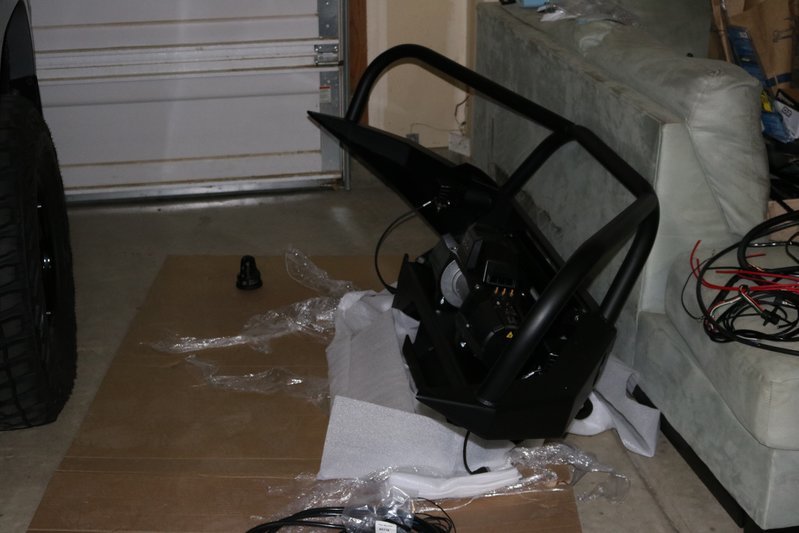

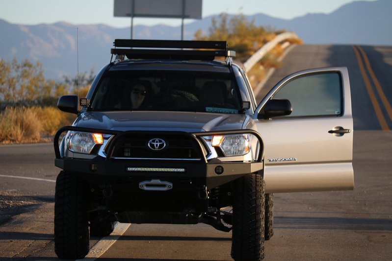

    Went down to San Diego to pick up the pelfreybilt front bumper. Meet Tyler and got to see their business which is very impressive.
    Got the rigid 20" light bar, the Rigid fog lights and Warn Zeon winch installed on the bumper.
    Bumper installed on the truck, I had to order 700lb springs with the steel bumper and winch installed the front dropped about an inch. The last picture is with the new springs.

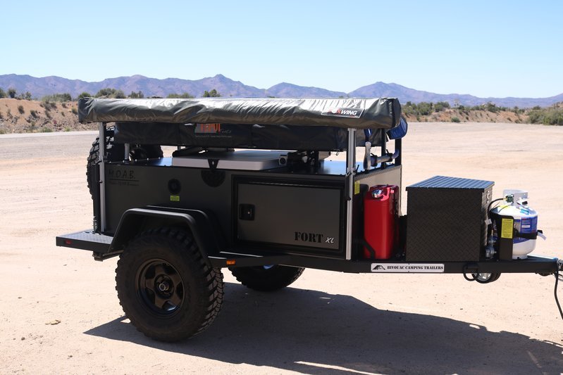

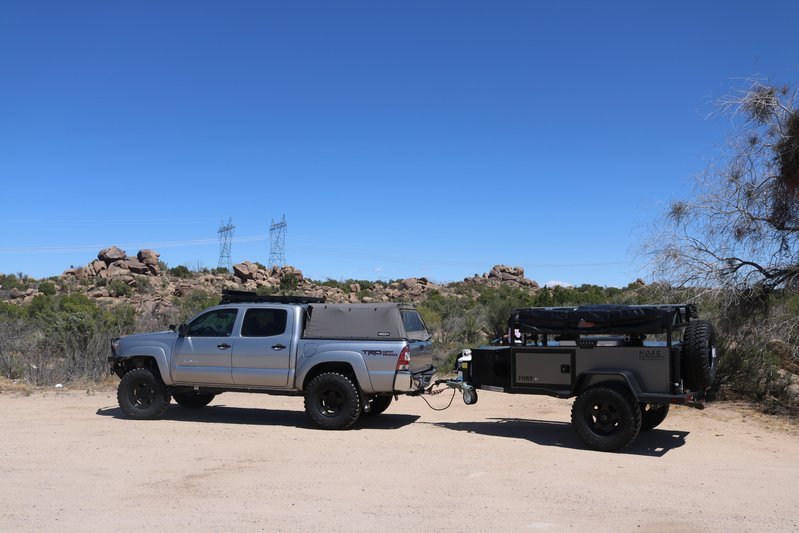

    I introduce the Moab Fort XL made by Bivouac Camping Trailers located in Phoenix, AZ check out their website: http://moabaz.com/moab-fort-xl/

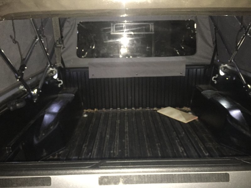

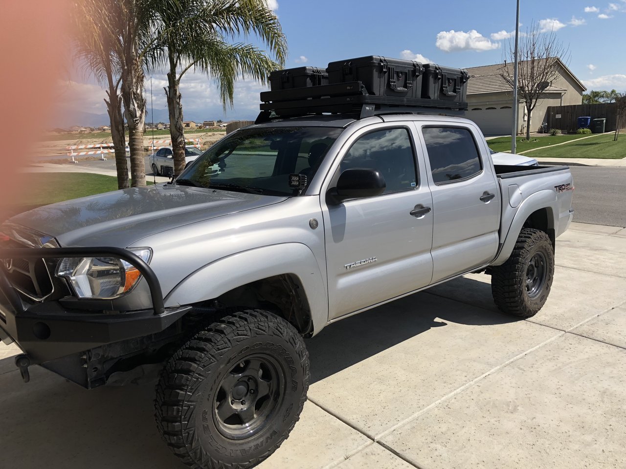

    Today I took off the Softopper to clean up the bed and get it ready for the Snugtop that will be coming in couple weeks.

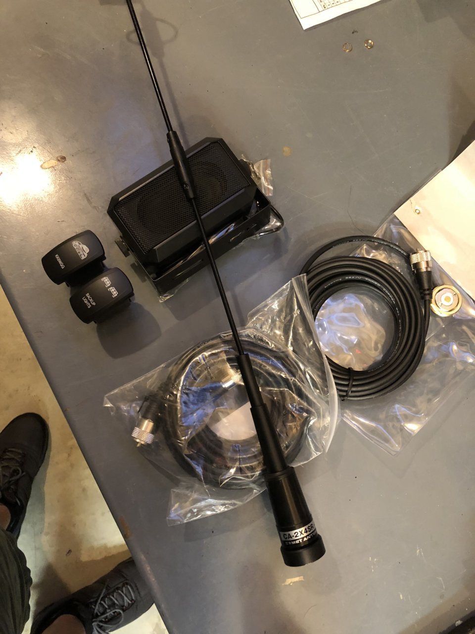

    I also order few parts to finish up the CB and Ham Radio installs. Amazon Prime maybe the best most awful service ever, at least my wallet thinks so. I plan to install the ham radio antenna on a NMO mount on the front passenger side fender. The CB antenna won’t be installed until the rear bumper comes in, 14 weeks feels like forever right now. :playball: In the mean while I’ll install the ham radio and a couple other things so hopefully I won’t have to tear the dash apart more than once.

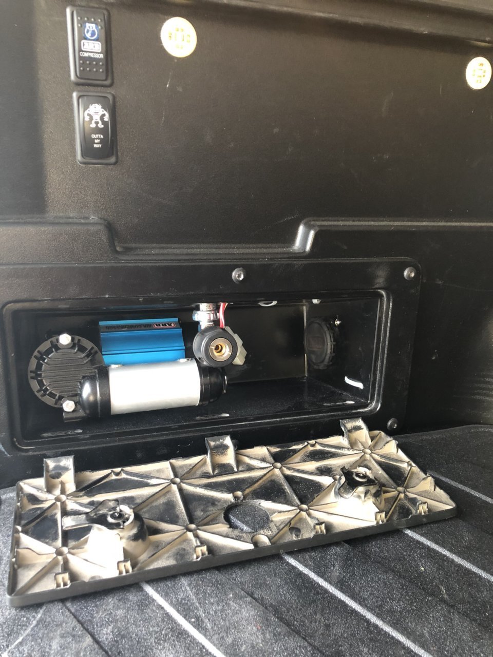

    The other thing I’m working on today is pelican storage.3F9CFB71-A909-4D44-B337-782CF5724CBC.jpg71ACA3B1-FD3E-4143-B23D-DE4365D7BC0B.jpg9E1C6D99-C475-43DB-A848-FE38CCF63962.jpg
    Any thoughts on how this looks or issues anyone might see with this, other than the fact I can’t park in my garage with them so I have to take them off after each trip.:annoyed:

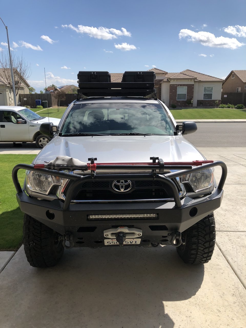

    Over the weekend I finished prepping the Pelican cases to be mounted. I drilled 3/8" holes in the bottom of the brand new cases :der:. I had to add washers between the bottom of the cases and roof rack rail to fill in the space. I also added a rubber washer to help seal it up. On the inside I have a 1-1/2" washer, split washer and nylock nut. I am not really worried about water getting inside, I think the truck would have to be completely under water and even then I think it would still stay dry. Challenge accepted! I'll post some pictures when I get home from work today. Over all I am pretty happy with how this turned out, I was a little concerned with how tall it would make the truck and how noisy, but its already noisy with how I have the light bar mounted and I've gotten used to it. Once I get everything mounted I will take it for a drive and see if I notice a difference.
    Hardware Used:
    16x 5/16" x 1-1/2" Bolts
    16x 5/16" x 1-1/2" Flat Washers
    16x 5/16" Split Washers
    16x 5/16" Nylock Nuts
    16x 5/16" Nuts
    32x 5/16" x 3/4" Flat Washers
    16x 5/16" x 1/2" Rubber Washer

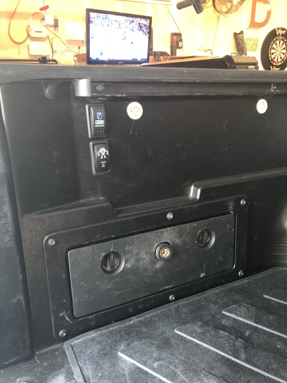

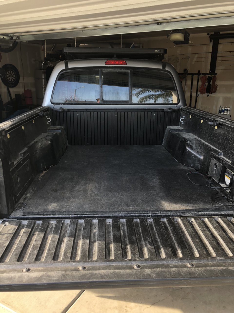

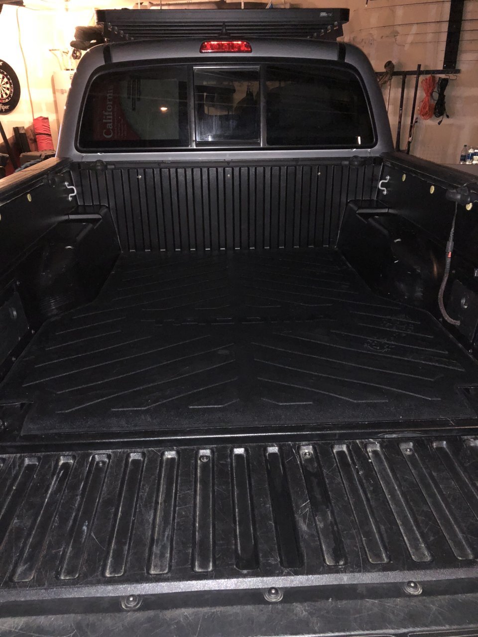

    I ran to the Toyota dealership when I got home from work today and picked up a Tacoma bed mat. Then I spent the rest of evening, between the 2 year (missed nap today, due to the baby sitter canceling last minute so the wife had to take the kids to her dentist appointment), 4 month old while the wife cooked dinner and... cleaning the bed. It’s funny how hard it is do even the smallest of task with kids around.:rofl:
    Bed Before:
    Bed After:

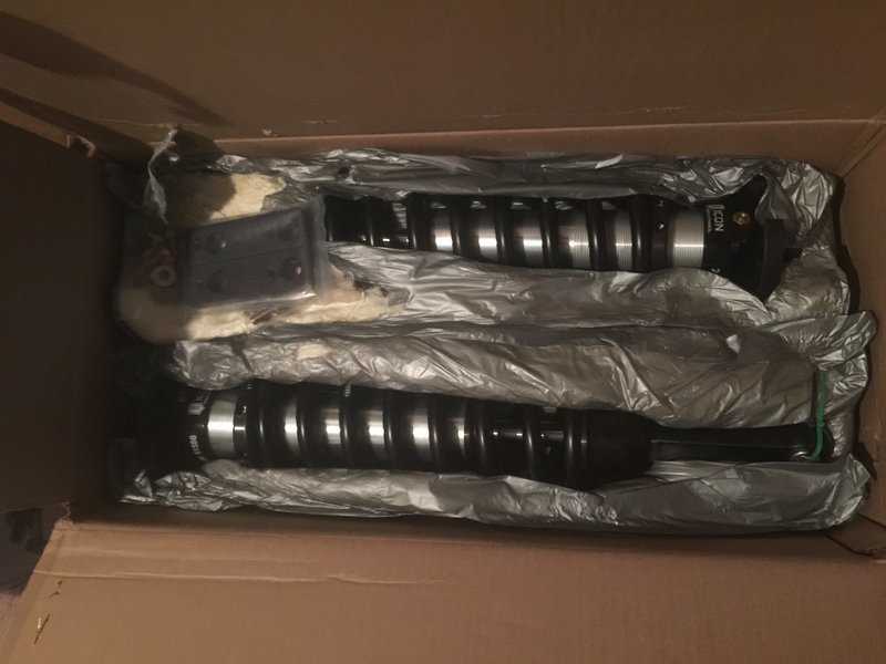

    Also I have received a few parts for the coming upgrades. :bananadance:
    90CF0983-B560-4CA5-95DE-29CDD9743572.jpg 0656B315-E423-4613-8E33-CBEF2A1F8E6E.jpg B6775422-F6FF-45FF-86BF-B3A70B0626BC.jpg

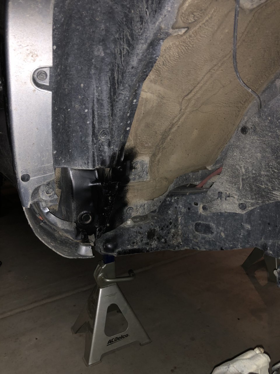

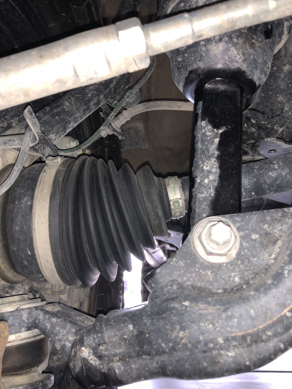

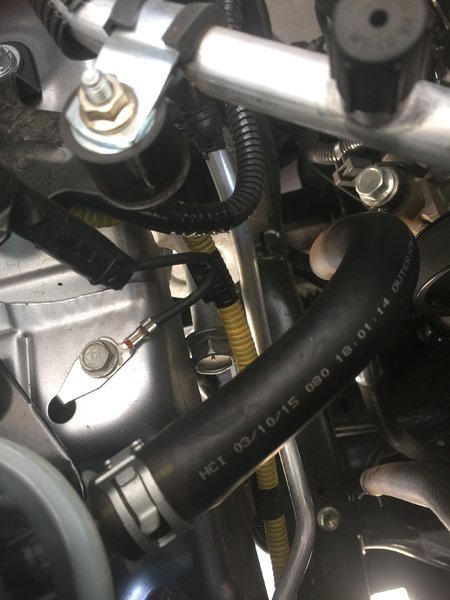

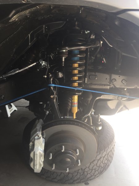

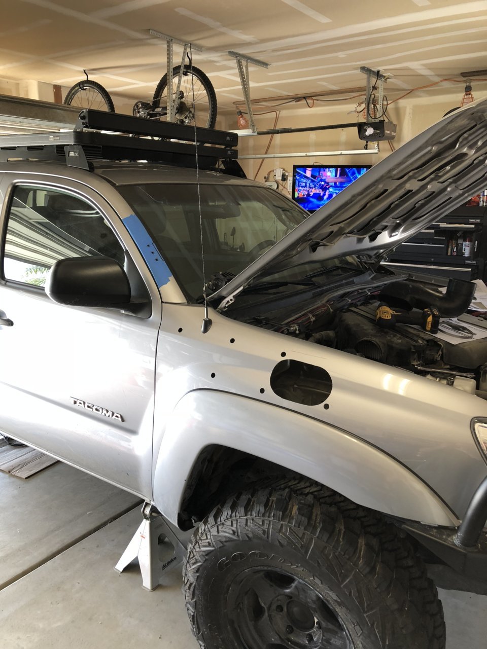

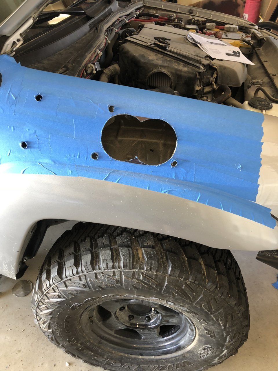

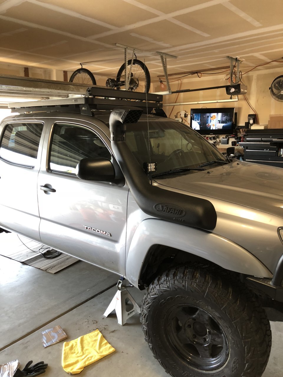

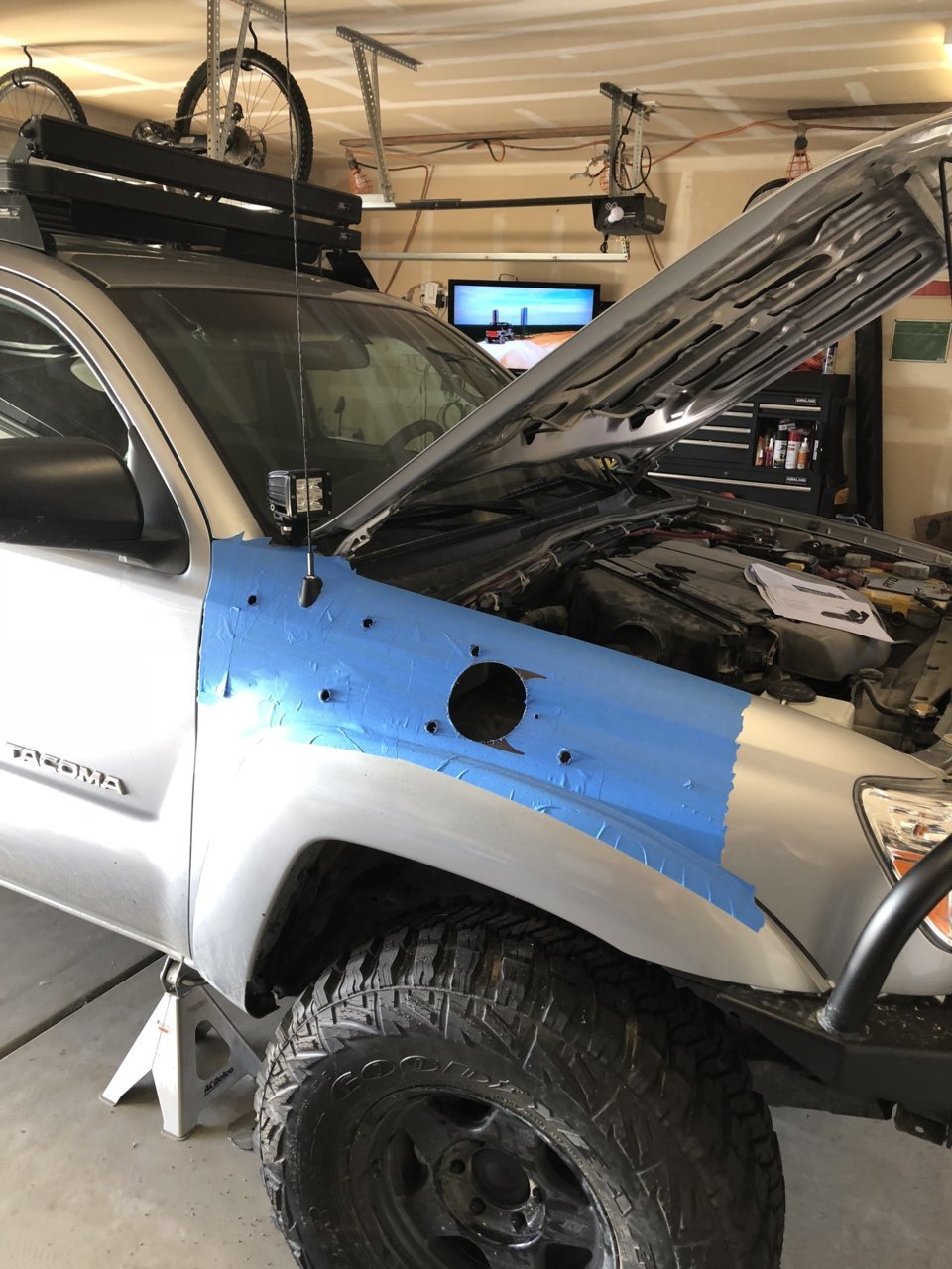

    Well today I started working on some of the many projects I have planned for the truck.

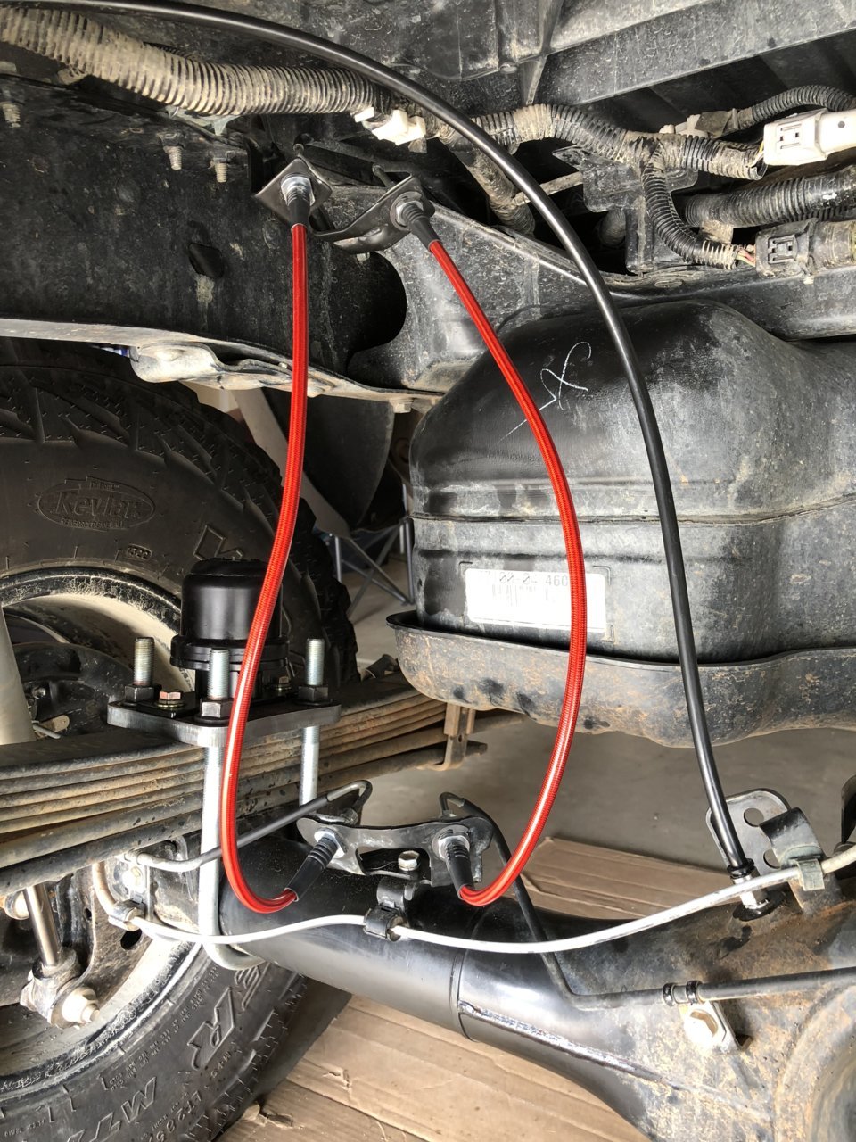

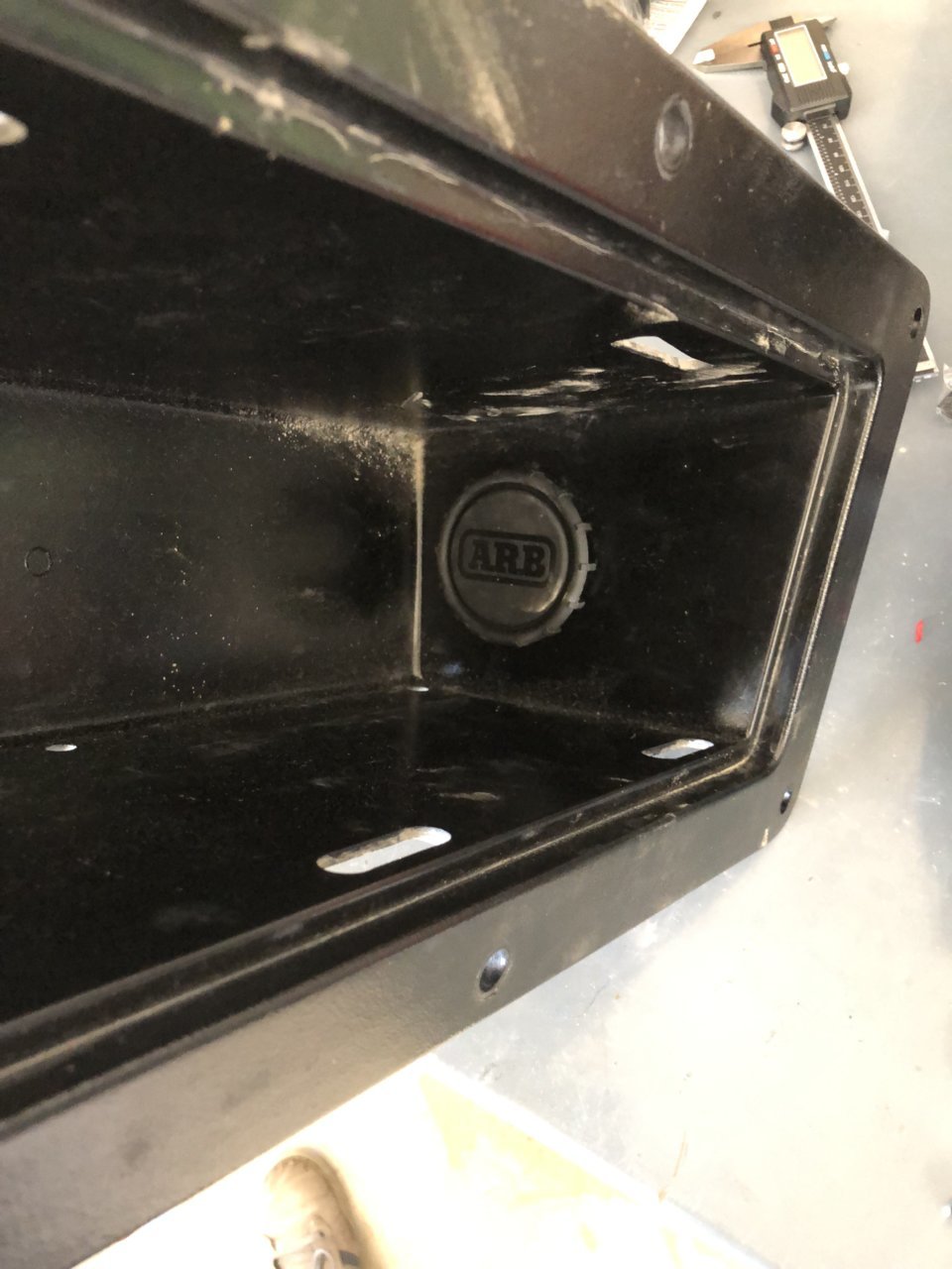

    Installed the rear diff remote breather. I started trying to find the front diff breather then realized it already has a remote breather. But while I was looking I realized my front coil overs were leaking :annoyed: so talked a DC Shock Service and I will be pulling them and sending them in for service. I’m not sure how I should feel about this they have about 21k miles on them and about 15% of that I would call off road. I’ll have to go back and read the recommend service mileage.

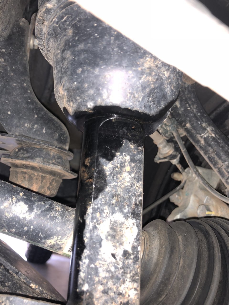

    I had originally planned on adding the remote resi when I did send them in but now I’m not so sure. Could see myself go LT in a couple years so not really worth the $500 extra. I guess I can decide after I get them pulled :rofl:
    77419232-A258-4E03-86B5-D6C892121ED7.jpg 584FFFF5-121F-4E49-8C9B-3C91EA51D934.jpg 7926374A-5459-46D1-9E56-D93BE91577B3.jpg
    The passenger side is much worse.

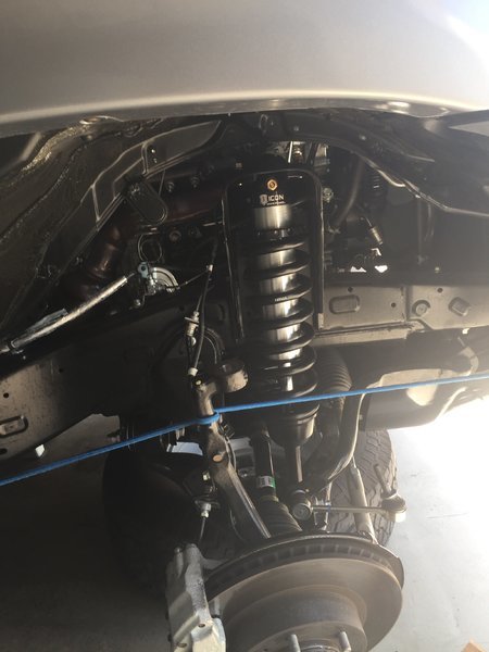

    I sent the shocks of to get service and add remote res with CDCV. I just received the call that let me know they are done and I am expecting them tomorrow or Wednesday. I decided to just add the remote res because if I end up going LT in the future it won’t be for a long time.
    Also I’m hoping to hear from the snugtop dealer this week. I’d really like to have the topper before my trip this weekend.

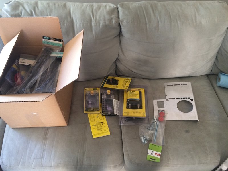

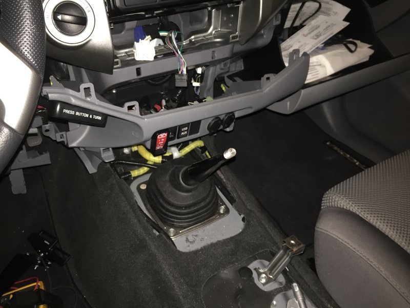

    I got my OBA compressor installed and wired.
    E6BFF87B-70D9-4056-8539-EA6BF52B0DC8.jpg C07A87F6-038C-4CBC-8B52-431CD89EE048.jpg
    I also installed some different switches for the bed lights and refrigerator.
    Installed new extended brake lines on the rear.
    You can also see that I did the u-bolt flip and wheeler superbump bump stops.

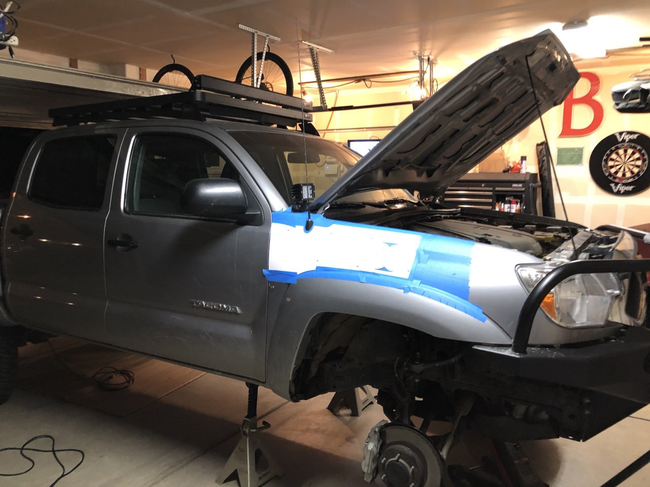

    Clear the pinch weld in both fenders.
    I plan on getting the CMC done in the next couple weeks, it will be nice to finally not have any more rubbing. It hasn’t been super noticeable but my suspension is a little stiff and I think with the armor coming it will be a bit softer so definitely think CMC is going to be necessary.
    Assembled the roof rack for the topper.
    The last thing that I did was drill a bunch of holes in the truck which at first is a lot scarier than it actually is.
    A99B5117-3027-4D48-9B12-731C52A06F8F.jpg 636F4B04-E6AD-4EB4-9FCD-8D56F85E7C9F.jpg DB8CD98A-3B09-46BF-BAF1-13F4D446AA4C.jpg 6852D4C5-6526-4AD0-B94F-38236709360C.jpg 63091501-EB5C-4A43-ABB8-D6C1C25206F7.jpg
