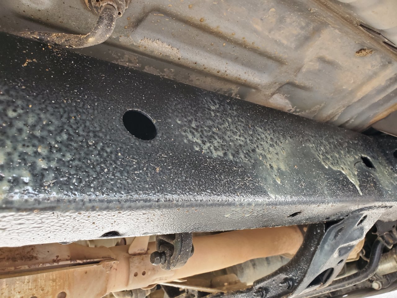

    So disclaimer I live in socal so I only buy a few of the cans and spray it myself, that being said here is what I noticed so far between the two.
    People say fluid film smells way worse, I found that to be the opposite, fluid film did have an odor but nothing terrible. Wool wax had a lot stronger odor that lingered longer. Either cases it wasn't an issue to me.
    Wool wax seems to spray on a lot thicker and I made the mistake of doing it on a windy day (got all over my face).
    That being said fluid film seemed to have come off a lot faster/easier. This is my frame after offroading in the snow and some puddles, (with woolwax)

    I had a shop spray my truck with Woolwax and after 6 months of going through high pressure washes (which have underbody sprayers) weekly I took it back so they could see how well it held up.
    The only spot it wore off was on the front of the rear differential, the rest of the underside looked just like the day they sprayed it.
    My wife will agree with you that Woolwax is smelly but I didn't mind it.
