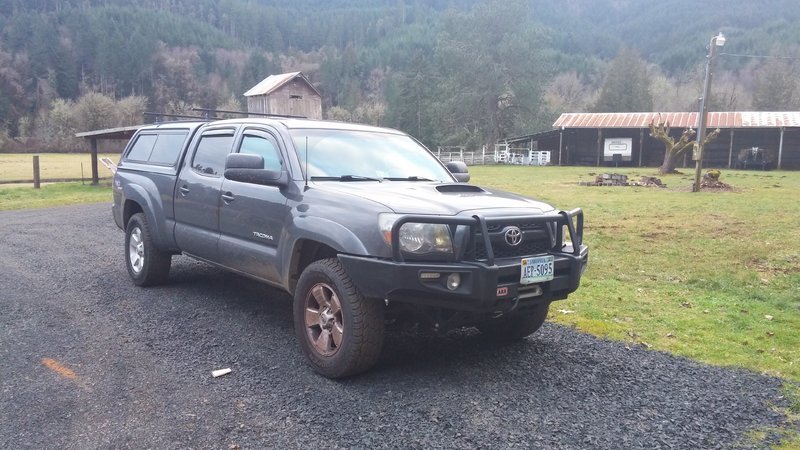

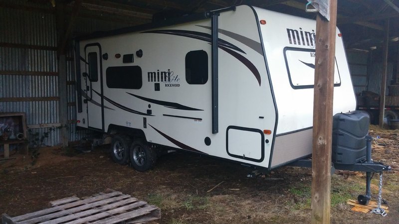

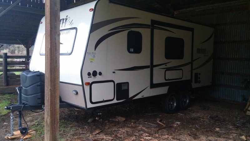

    That's the funny thing, I never took a pic of the truck hooked up to the camper. The pics above are the only ones I took during the whole trip.

    Do these count? You can see the camper and the truck in the same pic, at least.
