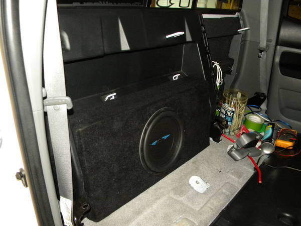

    all of the Raamat and ensolite is in the truck. Rick a RAAMAUDIO nailed the amount, on pack of BXTII did all four doors and the back wall and I have one cube left, and I used all of the Ensolite ( 3 yards).
    All of the speakers are in and the wiring is ran.
    I built the box today and put it in. I will run this for a while and probably build another. I wanted to get it in there and have the seat flip down. I took the plastic off of the back of the seat ( fine since the WO covers cover it up), I can fold the seat down, but it just kisses the woofer surround. There is plenty of room with the seat up, and I hardly ever go back there, so its not a huge deal
    3/4 MDF and a ID10D2. Just wrapped it in some black carpet since its not really in view ( no need for upholstery)
    All I have left is build the amp rack on the other side and put in the 300/4 and 500/1 and hook up the power wires. ( maybe I will get it done next weekend:)
    I am happy with the box though, it fits like a glove

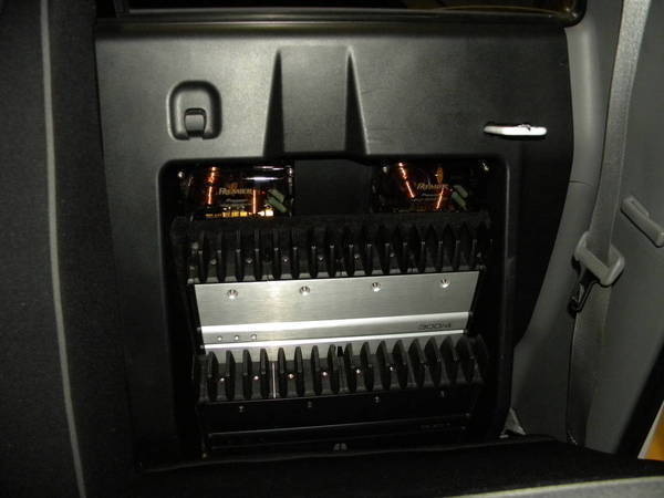

    Finished the stereo install this weekend. Getting the amps in and wired up was a real pain in the ass. This is my first attempt with a Dcab and there is not much room back there for all the wiring.
    The amp rack bolts in where the factory plastic bolted in.
    JL 500/1 and 300/4
    I am very satisfied with the out come. I was worried that it would lack some bass with the small box, but it really hits much harder than I thought it would
