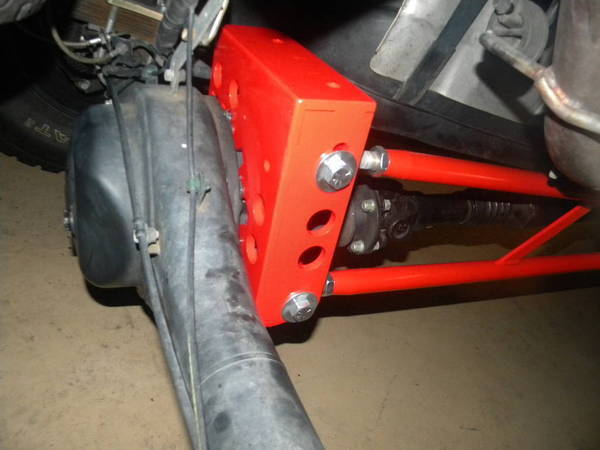

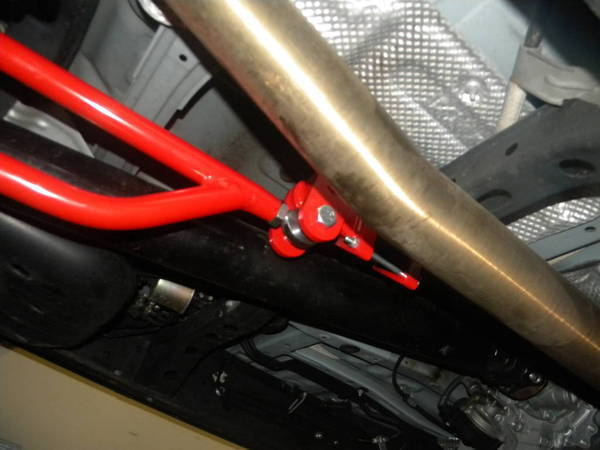

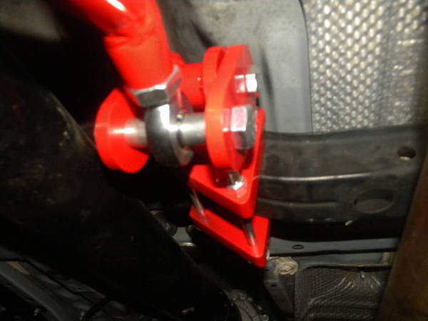

    Bye Bye axle wrap.... :D:D
    The high angle rod end and the shackle setup allow the bar to droop and not inhibit down travel an not bind when flexed.

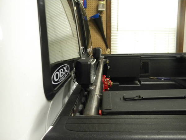

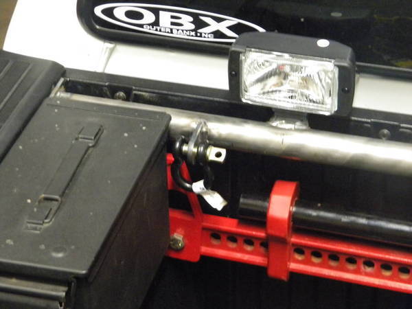

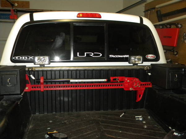

    I got started on the bed rack / tire mount system for the truck.
    I have the cross bar and ammo can mounts done. I added two light tabs for bed lights and two clevis shackles for in bed tie down points.
    the main bar is 1/2" .120 wall DOM with 3/16" end plates.
    I need to make spacers to keep the shackles from sliding side to side and rattling on the ammo cans.
    The hi lift will sit pretty much were it is in the pic, but I have to make the mounting points an attach them ( I have more tubing on the way to handle that)
    The hardware is tucked away in the cans and hidden and locked
    Once I get a spare I will make the swing out tire portion. It will be able to hold a full size 35" spare.
    I am pretty happy with the outcome so far. I should have moved the shackle mounts about 1/4" toward the center of the truck to get them away from the cans, but this will work. If the shackles rattle I will just put them in the cans and take them out when I need them
