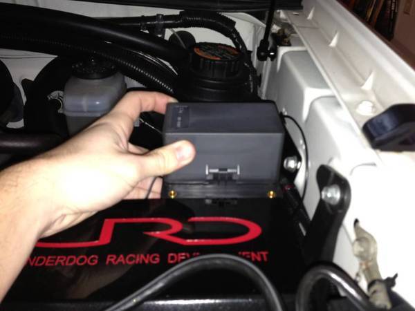

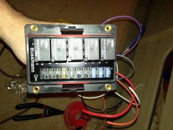

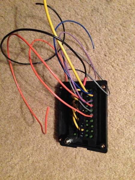

    Working on wiring up the Bussmann aux fuse box. Its a sweet setup for adding fused circuits.
    Alot of help from here
    http://mintzer.com/Jeep/AuxElectrical.htm

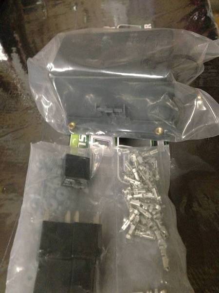

    All TXL wire for the install (best deal I found was Mcmastercarr)
    All delphi weatherpack sealed terminals (best deal was Amazon actually)
    1 - Bed Lights
    2 - Driving Lights 1
    3 - Driving Lights 2
    4 - Free relay circuit (wired for later)
    5 - Free relay circuit (wired for later)
    6 - OBA
    7 - HID 1
    8 - HID 2 (need to pick up another 20A fuse)
    9 - Free fused circuit
    10 - Free fused circuit
    I use all weather pack connectors so that the box can be removed in the future to add other circuits and/or reconfigure
    Once my wire loom gets here I will wrap them all.
    I need to make the mount, but here is where it will sit.
    I also got the n-Fab bar on, I ordered my lights, but they are on back order and wont be shipped until the 16th :( (4 700FF that I will convert to HID)

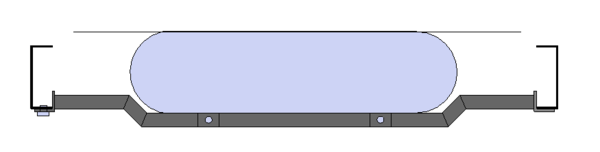

    I have the OBA mount drawn up too, it will go under bed and will have a skid to protect it (Steel is on the way)
    I will need some adjustment, but you get the idea (between the stock spare mount and the cross member that holds the evap canister. ( hangs about 1" below the frame total, not to bad.
    Justin
  18. Jan 8, 2013 at 8:31 PM
    #318
    wrmathis
    wrmathis Dark Lord of the Sith
    Sep 10, 2008
    #9126
    9,457
    Bonaire, GA
    2006 Tacoma TRD OR 4x4
    parts and stuff
    i like that fuse box and how you plan on using those connectors for it. im glad i was able to still use the one i got but i do like yours
  19. Jan 9, 2013 at 6:34 AM
    #319
    My68ur8trd
    My68ur8trd [OP] Well-Known Member Vendor
    Oct 7, 2007
    #2961
    1,530
    Justin
    Williamsburg, VA
    2007 TRD OR Dcab 4x4
    URD Catback | TRD CAI | TRD S/C | APR X-1 | DTLT | APR 2.85" Pulley |Fabtech 6" | Icon C/O | Alcan Leafs | 33 Grabber AT2 | 17" XD Addicts
    Yeah I like that one you have, but this is quite a bit cheaper.
    Probably 115 bucks total in it including all the connectors and wire for the whole project
