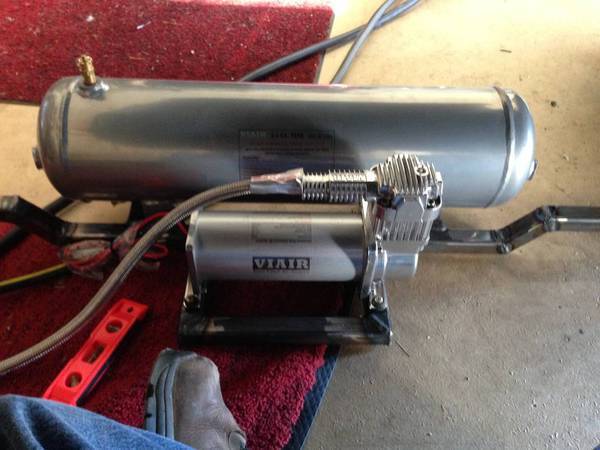

    Thats such a sick idea. Great job.
    What compressor did you get or did I miss that above?

    its the VIAIR system ( 1007) 100% duty cycles 150 psi
    Should be able to do anything I want it to short of a die grinder .
    I will likely use it to run nail guns from time to time as well ( wont need to drag the pan cake compressor with em all the time)
    If I ever get to SAS this thing, it will be used for air lockers as well

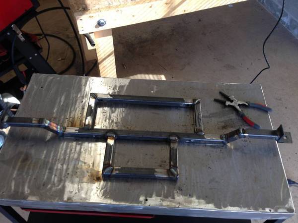

    What was total cost on parts? (Square bar)

    its about 8 ft of 1" .120 wall and 2" 1/4 thick angle for the feet
    prices vary, but its roughly $50 in raw material I would guess.
    I might through a interest thread up when I get it all done and see if there is any interest in the cross members
    I am going to do another for a local guy with a one gallon tank in the near future ( once I get back in the country)

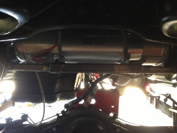

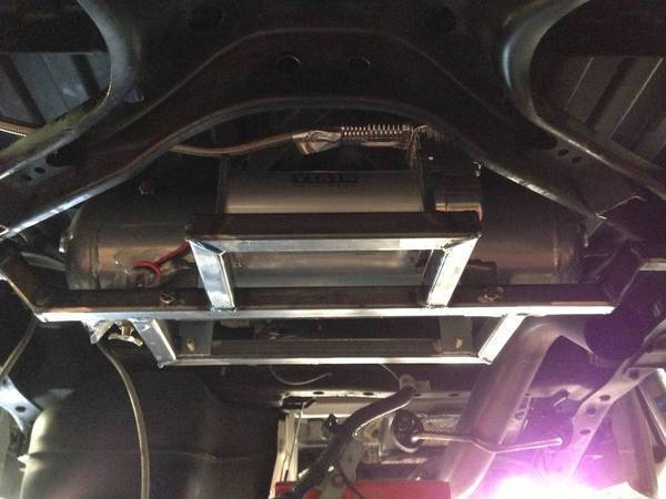

    The only other issue I have is When I do my OBW, I might need that space... Also, did you move the carbon module? Thats on my things of "To Do"

    My bumps were closer to the LCA and wouldnt let use my shocks fully:mad:
    do you ever bottom out?

    No I did not. There is probably a foot between the tank and the cross member with the carbon can. The compressor could have gone on that side, but I would have wanted to move the cross member up to center it, or run two cross members ( not necessary with the way I have it, its stout to say the least)
    When I take it off to paint, I will see if I can just move the whole thing forward, that would let you run the stock spare still.
    I dont have a spare under there and I wanted it just behind the axle, instead of directly above it
