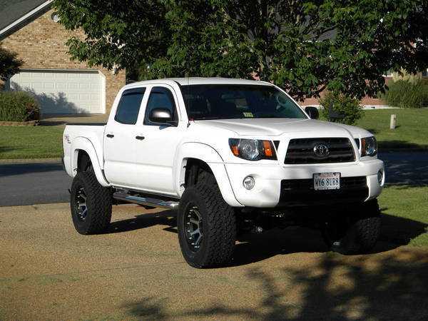

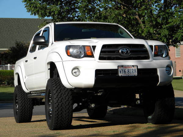

    UPDATE 9/6/2010 :D
    So we installed the suspension yesterday. Took 13 hours, but all went smoothly.
    Fabtech 6"
    Alcan Rear 6" Springs
    Bilstein 5125s
    Stainless Brakelines
    Icon Coilovers
    17x9 XD Addicts
    33 1250 17 General Grabber AT2
    Sorry for the blurry pics, the lightening sucked when I took them
    So the eye candy first and I will go through some the the issues I ran into. Oh yeah, I had the lower bumper wrapped in matte vinyl too
    [​IMG]\
    OK some details. I bought this kit from another TW member used ( the Fabtech parts) and pieced together the rest.

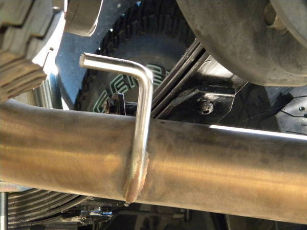

    I had a set of Alcans made in place of the rear blocks and AAL. I also put in the Alpro upbolt flip. I have a feeling that these shocks are too long. They are great in droop, but I think I will bottom them out flexed, but they are ok for now
    I didnt like the idea of bending the hardlines and all those brackets that Fabtech sends to move the brake lines. So I replaced them from longer stainless lines from the GB. The rear were the perfect length. The fronts are a tad long, but should work out fine
    I put in Icons up front instead on the spacer/standard shock
    The next thing that I need to tackle is modding the exhaust.
    Its a little tight :)
    I had it up the rack, and there is a massive amount of droop in the back.
    Also, I answered my 33 vs 35 questions, I think these look perfect. I am glad that I went with 33s. The truck gets aligned in the morning and will be on the road.
    I have noticed a little power loss, but I havent really hammered on it yet.
    I love how the truck looks now, It is a tad bigger than I thought it would be, but all is well.
    Justin
