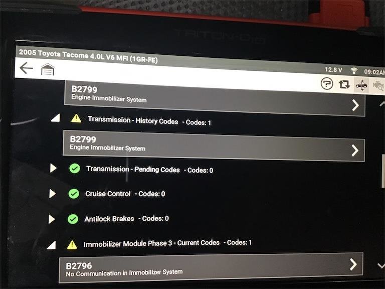

    For the fifth time in as many months, my truck wouldn't start when I climbed in after work. Once again, my wife had to come give me a jump start. I drove it home and put it on the charger.
    After the second time this happened, back in May, I took it to a repair shop assuming it was a dead battery or bad battery (it is still under warranty). The shop ran tests, confirming that the battery was good, the alternator was good, and that it was charging. Their report was:
    - Unable to verify any slow crank or no crank issues.

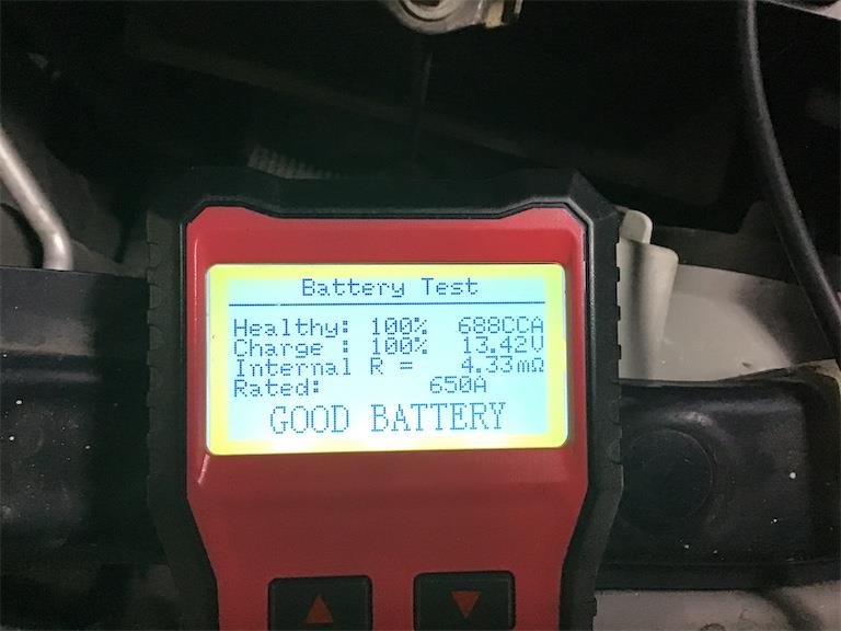

    - Performed a battery test.
    - Battery is testing good.
    - Performed a starting system test.
    - Starter is operating normally.

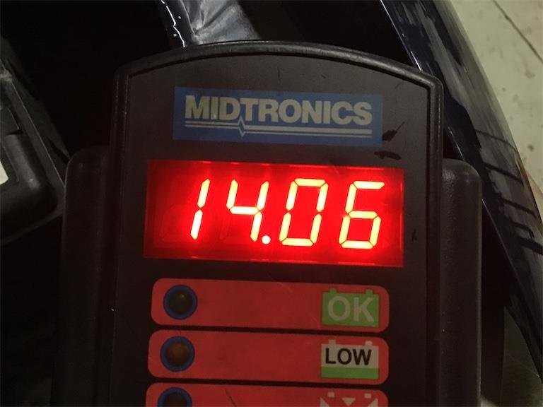

    - Performed a charging system test.
    - The alternator is putting out 14v loaded and unloaded.
    - Checked the connections at the alternator. They are clean and tight.
    - Terminals ends on the battery are tight and clean.
    - Checked the starter harness.
    - The wires are clean and tight.
    - Scanned for codes.
    - Found security codes. Depending on which key I used.
    - Being unable to duplicate the issue, cannot verify that is the issue
