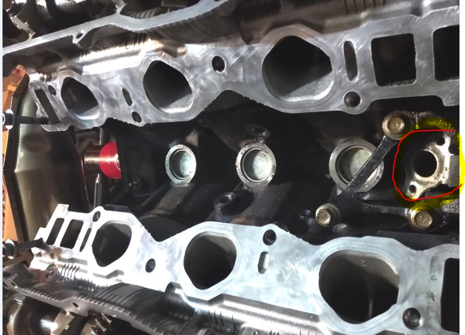

    the leak is more than likely from the thermostat bypass tube that is under the lower intake. It comes out the back of the "V" on the back of the block and goes to the heater core. The second place might be the core plugs on the back of the block... trans or motor has to come out to deal with these. I have a posting called "Mystery coolant leak found" under my name.

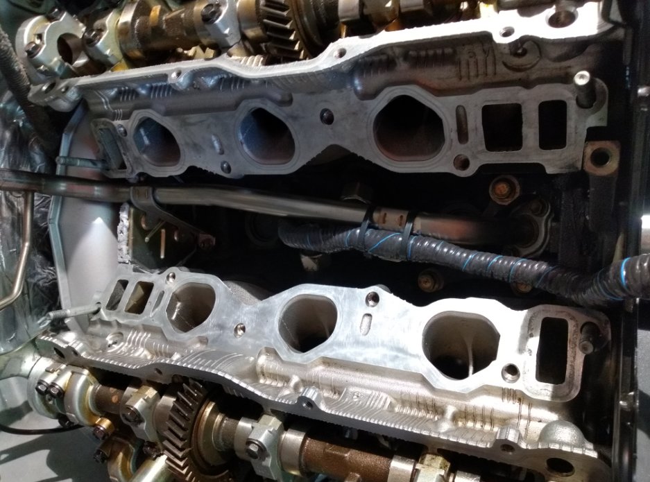

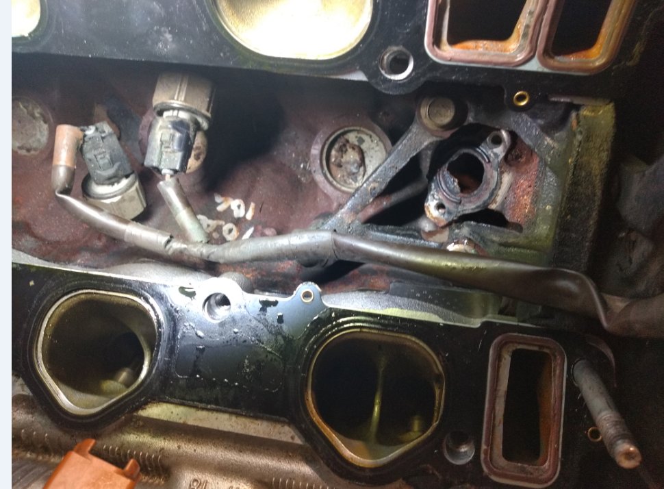

    Here's a picture. The bypass tube is sealed with RTV. I saw this breaking down on the 21 year old engine that had 70,000 miles. Just keep you eye out for any any coolant vapors that may be coming up from below the lower intake manifold at the front of the engine just behind the timing belt cover.
    Picture before cleaning to see how the old RTV is breaking down. It was a good time to replace the knock sensors and wiring harness.
    Pipe installation with my enhanced knock sensor wiring harness. Lookout for steel gasket failure and gasket rash pitting around the head coolant ports. Those can begin to seep if the metal gasket rusts.
