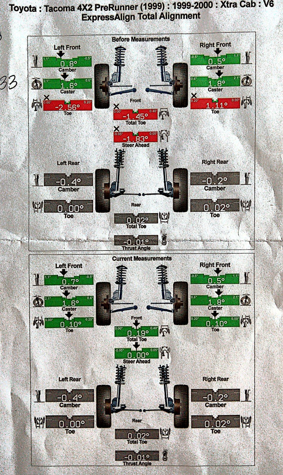

    Does this Firestone report describe "how it aligns"?
