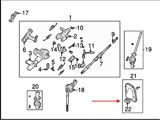

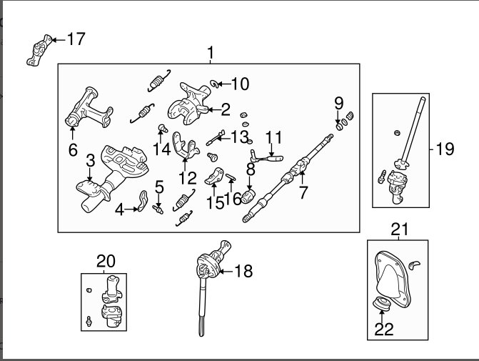

    I've checked Longotoyota.com, RockAuto.com, eBay, and Amazon. I can't find that boot around the steering shaft. I think we are talking about #22 in this diagram, correct?
    #49
  10. May 12, 2024 at 4:39 PM
    #50
    tacoman2001$
    tacoman2001$ Well-Known Member
    Sep 23, 2022
    #406478
    767
    Yes.

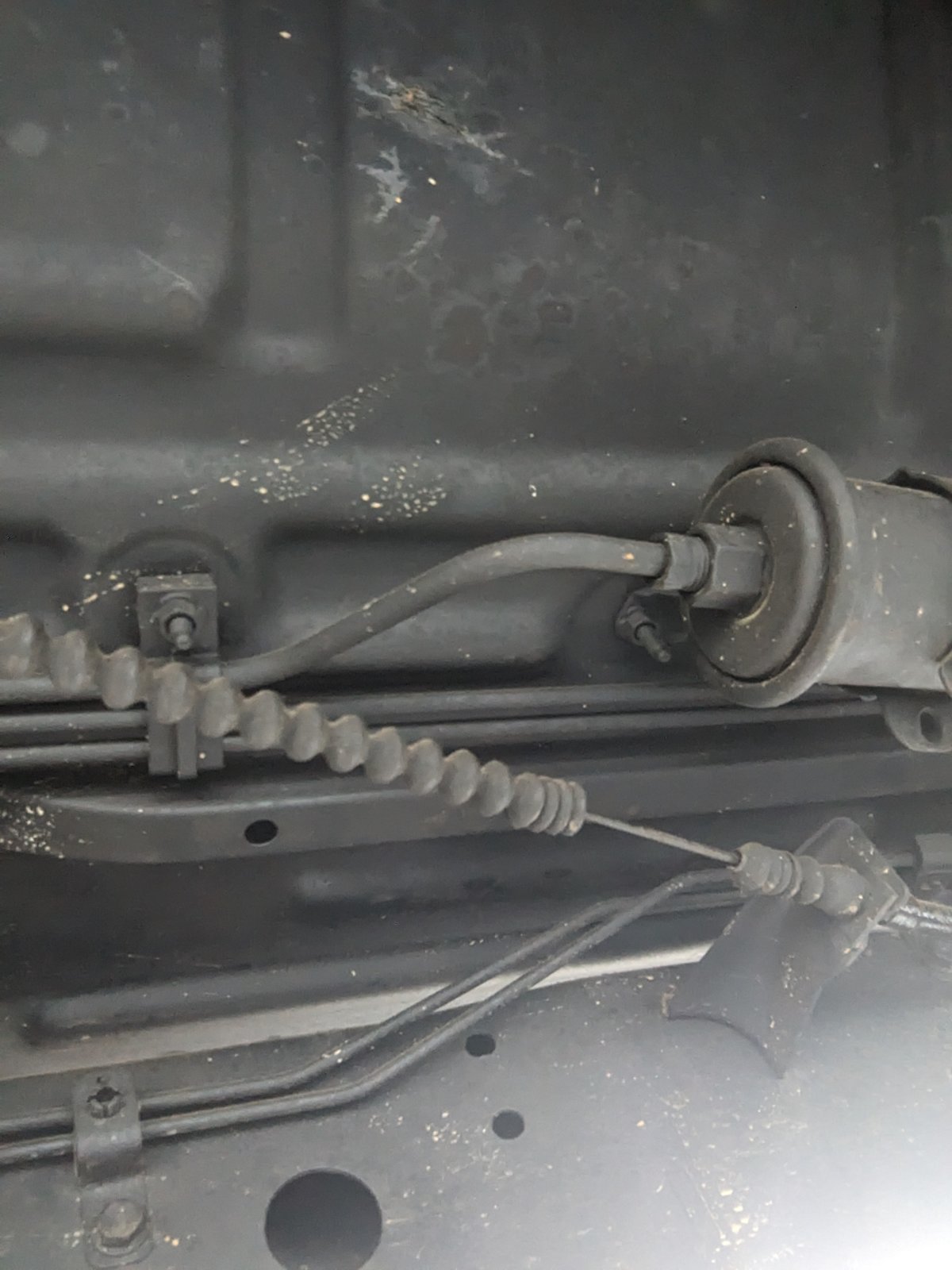

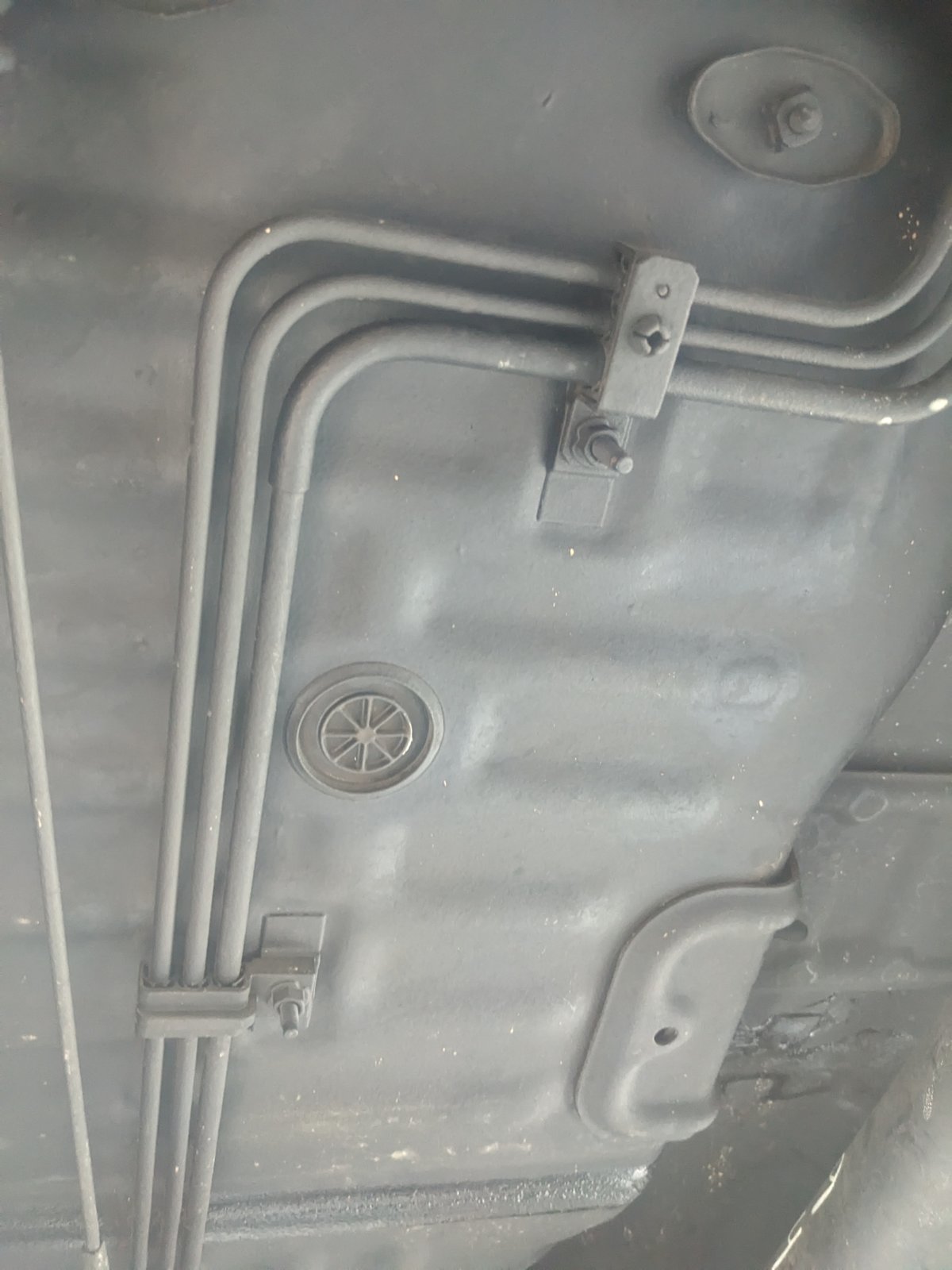

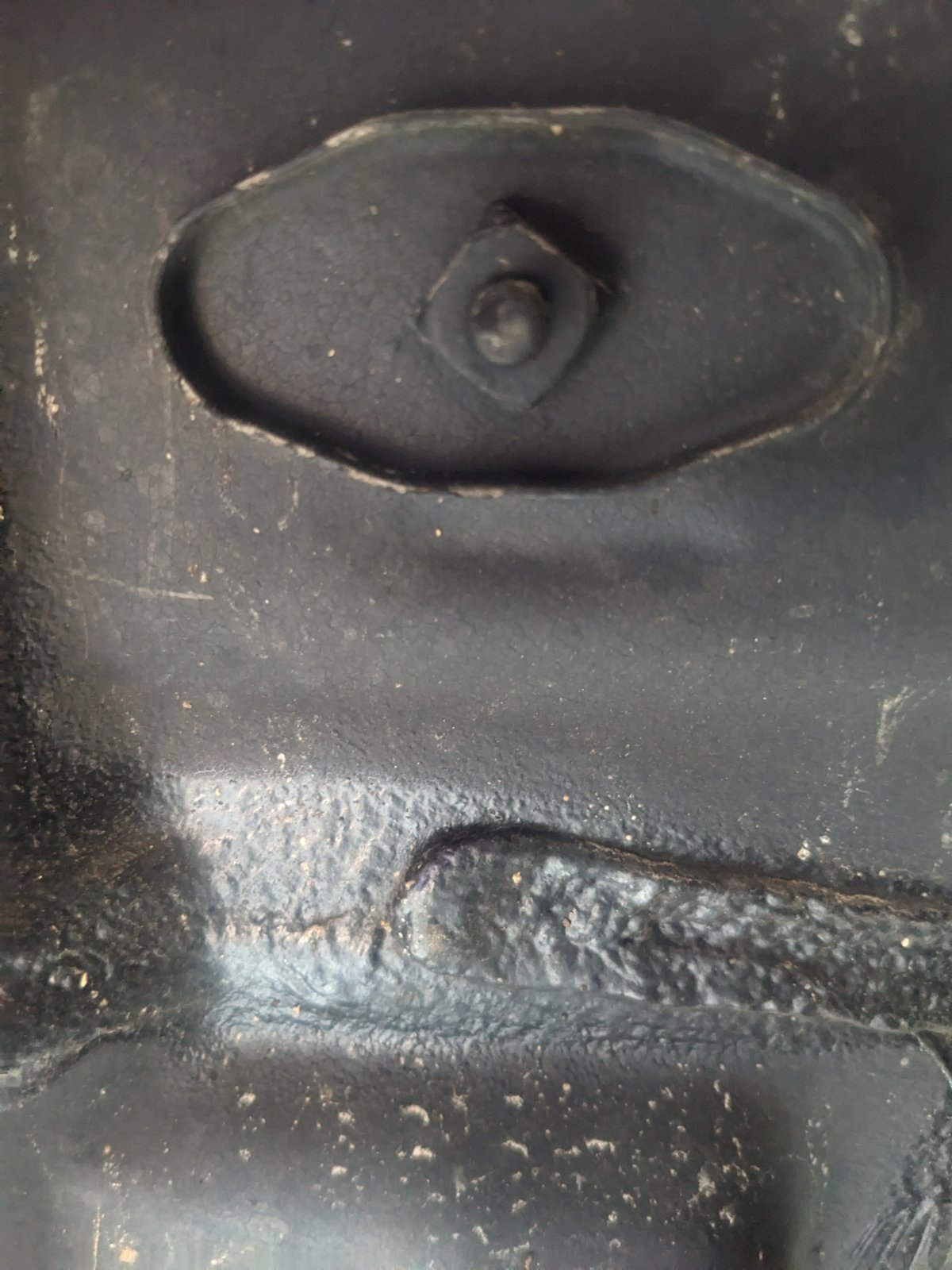

    do you have any pics of that ziebart application
    i am quite curious to see what that looks like under there!
  12. May 13, 2024 at 5:09 PM
    #52
    handytravis
    handytravis [OP] Active Member
    May 7, 2024
    #449352
    32
    Travis
    1999 Pre-runner
    Camper shell, 1st Gen Tundra wheels
    Pretty boring stuff to look at, but I took a few random pics. You can see some tiny chips here and there because it's been over two years. Ziebart guarantees no rust as long as you go back every year to get the coating touched up. In St Louis 2 yrs ago the price was $400 for the full treatment and $150 for each maintenance treatment, but you only qualify for the lower price if you come every year. The coating I would describe as somewhere between tar and black rustoleum paint. It took at least 12 months for it to cure hard. I remember working on the driveshaft 6 months after the coating was applied and I got quite messy. Note: They don't coat your exhaust or drive shaft.
    And, now I realize that this rust preventative treatment really shouldn't have been on the list at. This is clearly not a repair expense.
    PXL_20240513_234302861.jpg PXL_20240513_234249572.jpg PXL_20240513_234106169.PORTRAIT.ORIGINAL.jpg
    Black97v6MT[QUOTED] likes this.

    LongoToyota.com provided that parts breakout showing the boot as part 22.
    The official Toyota part number is 45292-35090
