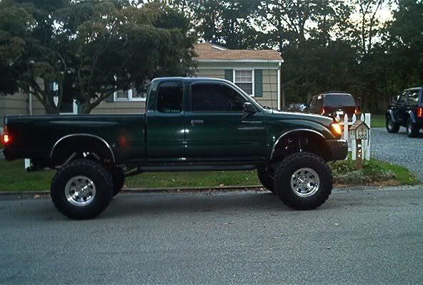

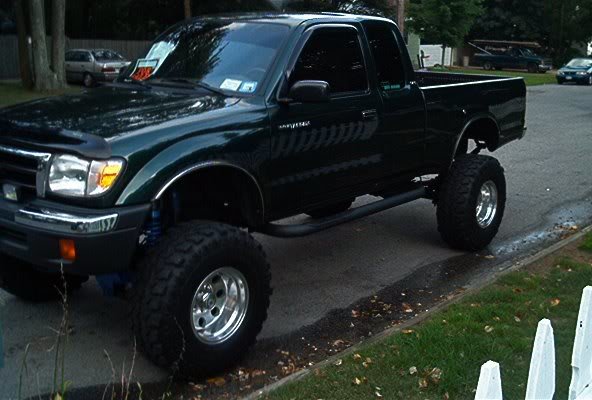

    thats a trailmaster 6" lift for the first gen tacos i had one on my 99 with fox racing coilovers.
