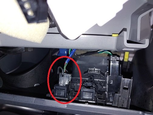

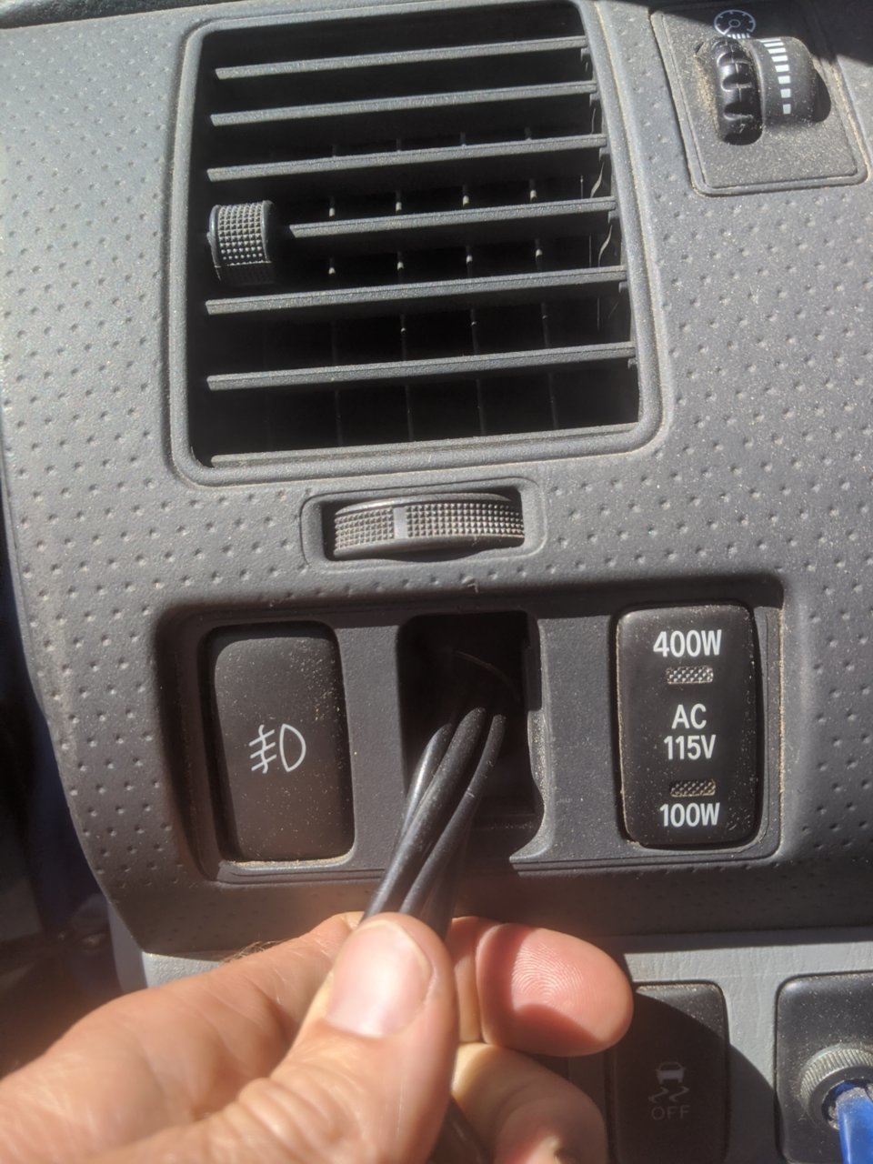

    IN the dash left of steering wheel I have the fog light switch, and 2 blanks. the right blank has a 5 wire connector plugged to it. What does this go to?
    Wires are:
    red
    light green
    dark green w/ black
    blue
    light green w/ black

    Maybe it's the RSCA button but with a blank in place of the actual switch.

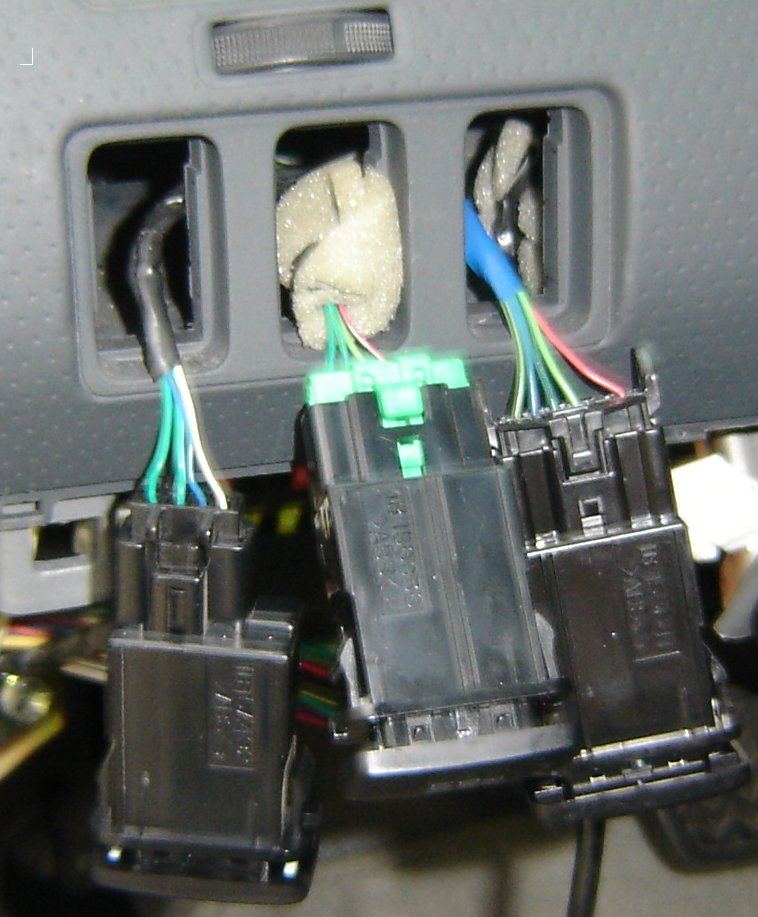

    Inverter. At least that's what's in that spot on my 2010 dclb

    I have the RSCA button on the lower panel, along with the lsd disable.
    I think @pmstoy10 is right. I find other pics with it there.
    thanks guys!

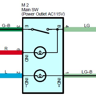

    Those are the switch wire colors for the inverter, so that’s definitely what it is.
