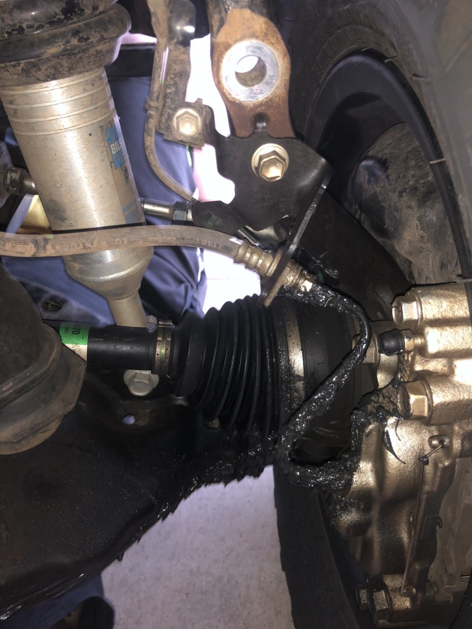

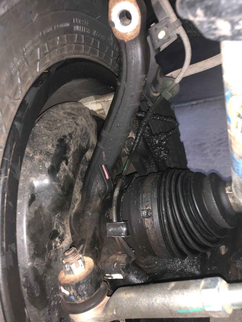

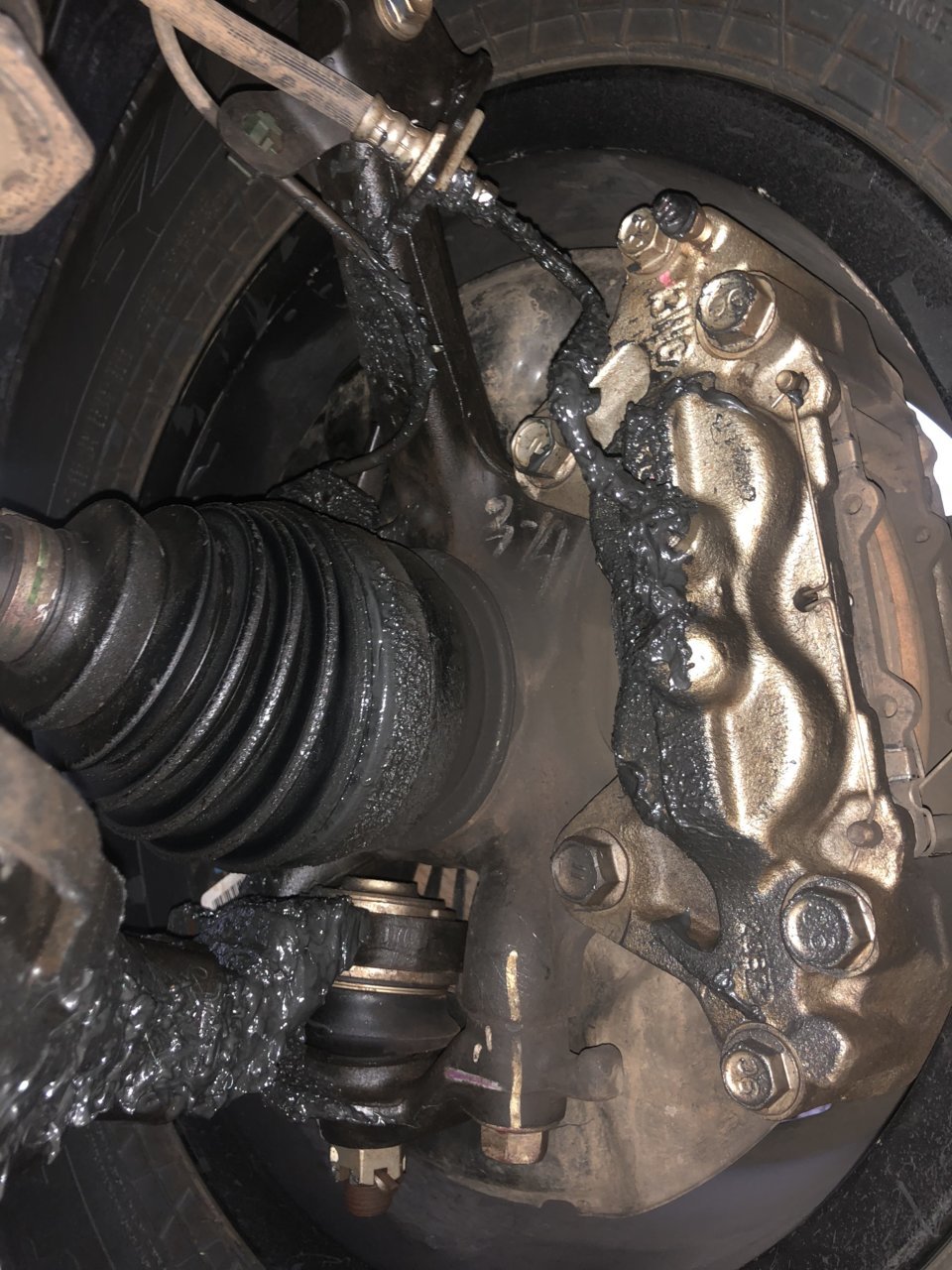

    Hey guys,
    So I was wondering what you guys think might be going on? Looked into the passenger wheel well and saw thick oil. These are the pictures I took for visuals. I have unfortunately not gone off roading due to other things. Just normal street driving and this is how it is. Any thoughts?

    Appears to be coming from the CV Joint boot.

    CV joint grease. Your boot is likely torn or split, or mis-seated.

    Based off the 360 degrees of grease in line with the boot, I’d agree. Probably have a tear from wear on it in one of the creases. Even without off roading it happens.

    Look at the spray pattern. It's coming from the CV where it meets the wheel hub or something got splashed up on the CV and it slung it.

    Depending on how long it has been like that, you may need more than a new boot. Once you start slinging grease out and allowing dirt and water in, the CV joint starts to wear rapidly.

    It’s been less than 500 miles like that. Here in Arizona it doesn’t rain much and it’s only been on the road.

    I agree with others. Your CV boot cracked and the grease spun out. What grease you have left is probably contaminated with dirt, water, and yucky stuff which will quickly grind and wear out the bearings. You need a new CV joint assembly complete with new bearings, clean grease and sealed in a new boot.
    Common fix that any mechanic can do.
