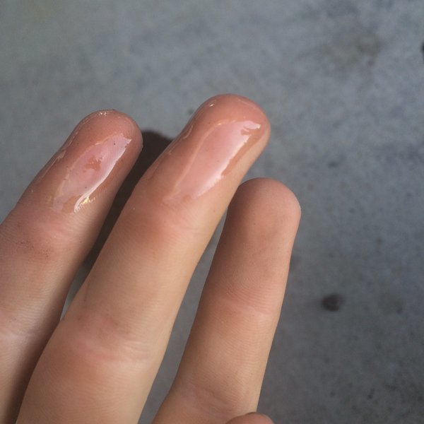

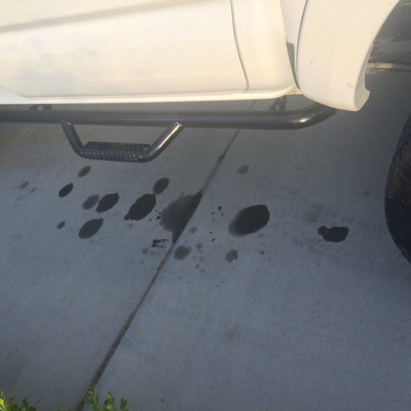

    Alright so lately ive had some fluid leaking on the driveway, clear in color coming from the back left far side of the truck. What is it? Ps. Easy way to clean it off the driveway?

    Is it sticky or viscous?

    Looks like oil? Brake fluid? Get under and look!

    How far back? You do have two brake lines coming from the axle to under the bed. It looks like clean brake fluid from the picture. When I put extended brake lines on the rear, the connections under the bed wanted to leak unless you got it super tight.

    Can't be oil. Oil hasn't been changed in 2.5k miles, that's way too clean. And I don't think it's brake fluid, because it's coming from under the pinch weld area, not the breaks.

    Another vote for brake fluid. Don't drive the truck until it's fixed!

    If it's leaking that much brake fluid your brakes would suck. Power steering? A good way to start is look at the levels.

    I think tacos use ATF fluid for power steering fluid, and it's clear not pinkish. Brakes are performing fine :(

    You might need to trace back towards the engine/brake lines from that weld. It might lead you to the source as the source probably isn't the weld.
    To answer your question about cleaning the driveway; Grease Lightning diluted with water will wash it up. But do NOT use straight grease lighting it will bleach your driveway. OR you could use kitty litter or "oil dry" (same stuff basically)- drop it on the ground and rub with your foot in circles for a good 5 minutes, sweep over each spot rubbing the stuff around, then sweep up and rinse off with a hose.

    I would guess brake fluid, or possibly blown shock? I had my right rear billy blow out and some milky brown-ish fluid leaked out. Brake fluid seems more likely. Get some braided stainless lines to replace the current ones.

    Did you check your reservoir levels? Does it smell like brake fluid?

    What does it smell like? The smell alone will tell you if it's fluid from the brakes, diff or shocks. I am putting my money on brake fluid.

    Anything leaking inside the bed? The drain hole is right in front of the leafs.
