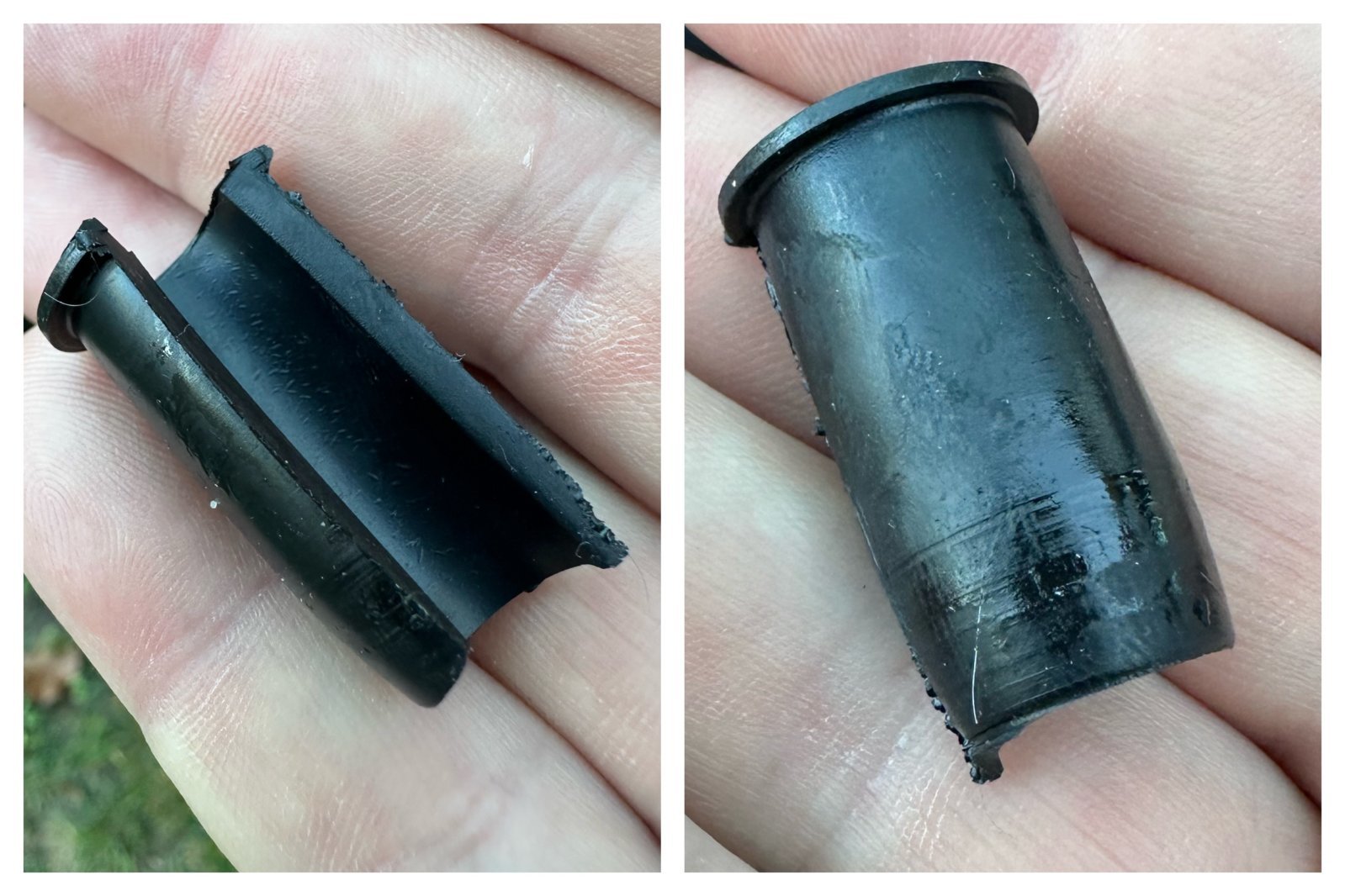

    This thing mysteriously appeared in the footwell of my 23 Tacoma TRD 4x4. No way in hell I, “tracked” it in. So I assume it fell out of the steering column sort of area. Looks a bit like a split grommet of some sort and felt lightly greasy. Any ideas?

    I'm pretty sure that goes inside the brake pedal return spring as a noise damper. I seem to recall another thread asking the same thing awhile back.

    Exactly this. I recall a thread or two as well. Stops spring from making twangy sounds when pedal is moved. lol

    And yes, it went in the brake pedal spring. Hasn't popped out since either.

    Hey guys, so sorry...somehow I didn't realize this thread was replied to. I almost threw that thing out the other day thinking I got no love. Now I'm gonna go searching to stick it back wherever it was LOL. Thanks a lot!
