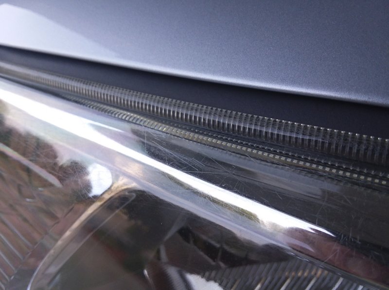

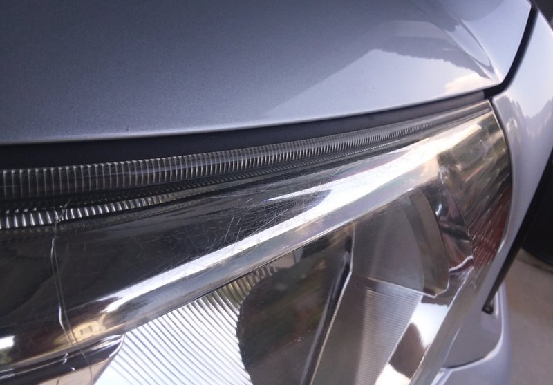

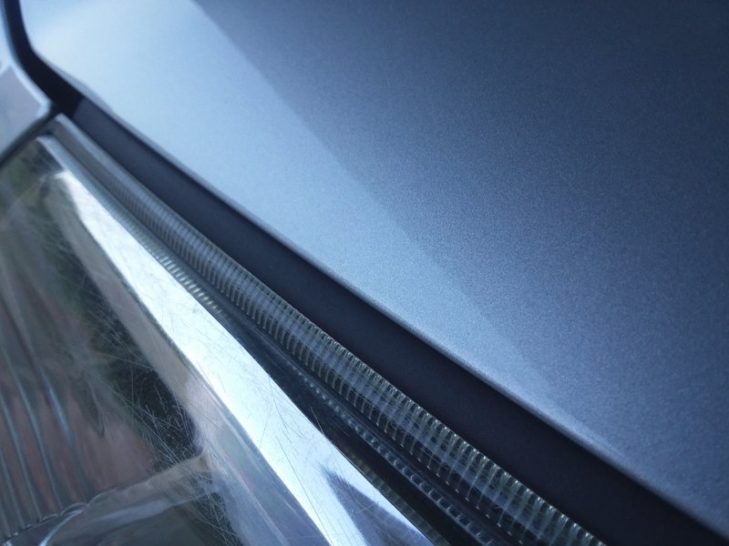

    These scratches are continuing to get worse. Maybe it is just age and normal wear and tear. I've see headlights haze over due to age and oxidation but never really seen any just develop scratches like this for no apparent reason. Any one else continuing to see this problem get worse with the 2nd gen headlights? 3rd Gen's starting to having any issues?

    Man some of you don't know what you're talking about. Injection molded headlights won't have clearcoat on them. Polish on plastic would dry to be a chalky white substance.
    OP - Put some thin masking tape on the scratched area for a week and resume life as normal. In a week, check the tape. If the tape is also scratched, then the cause is external.

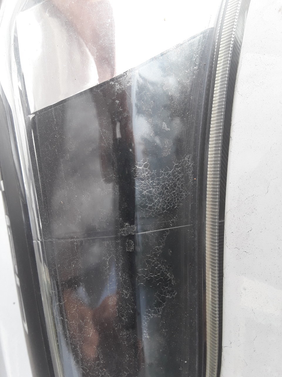

    Looks like age, and sun exposure related failure, of the factory UV protection coating. Mine coating failed, and in the beginning looked a lot like that last photo. Mine got worse, and hazed over, that's why I recently replaced my headlight assemblies. I got tired of buffing them with compound, and it didn't help for long, they would just haze over again.

    Air, including all the debris in it, gets pushed forward, compressed and speeds up going over the leading edge of the hood. The top of the lens is part of that airfoil. Redesign back to the old days would fix it, but mileage would suffer, so it ain't gonna happen.
