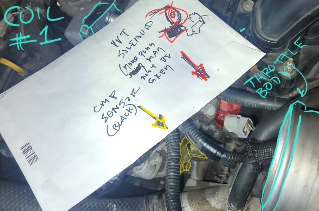

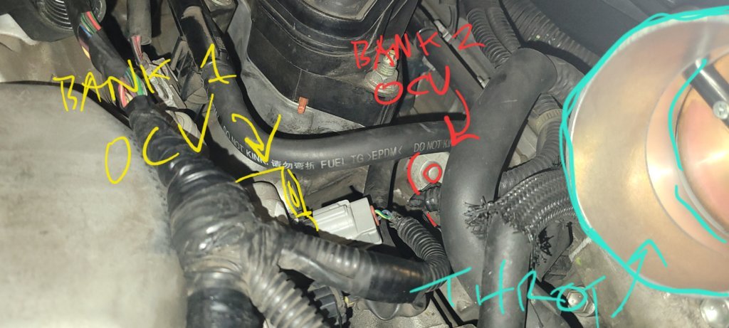

    Here, I've illustrated both OCVs and the bank 1 VVT sensor.
    hinmo24t likes this.

    You would def have to move the alternator to get to the bank 2 VVT filter.
    Did you watch the videos I linked in my earlier comment? Does your truck sound like that ever, how about when it's cold out?

    thanks for those marked up photos above...
