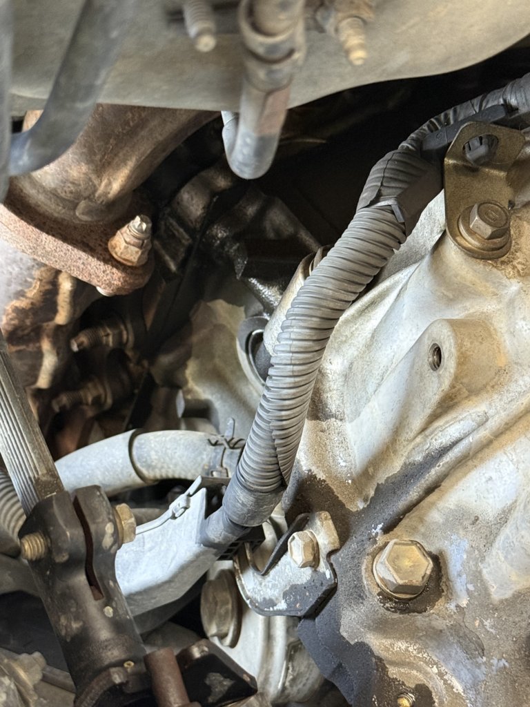

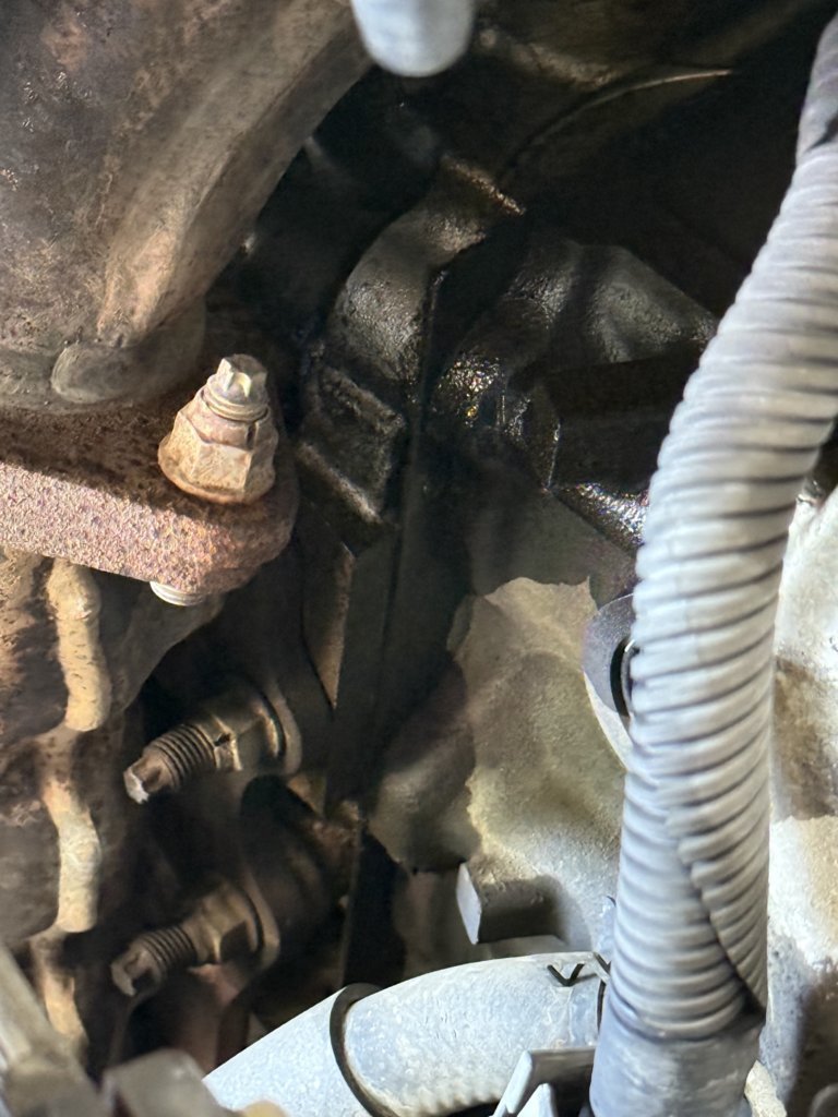

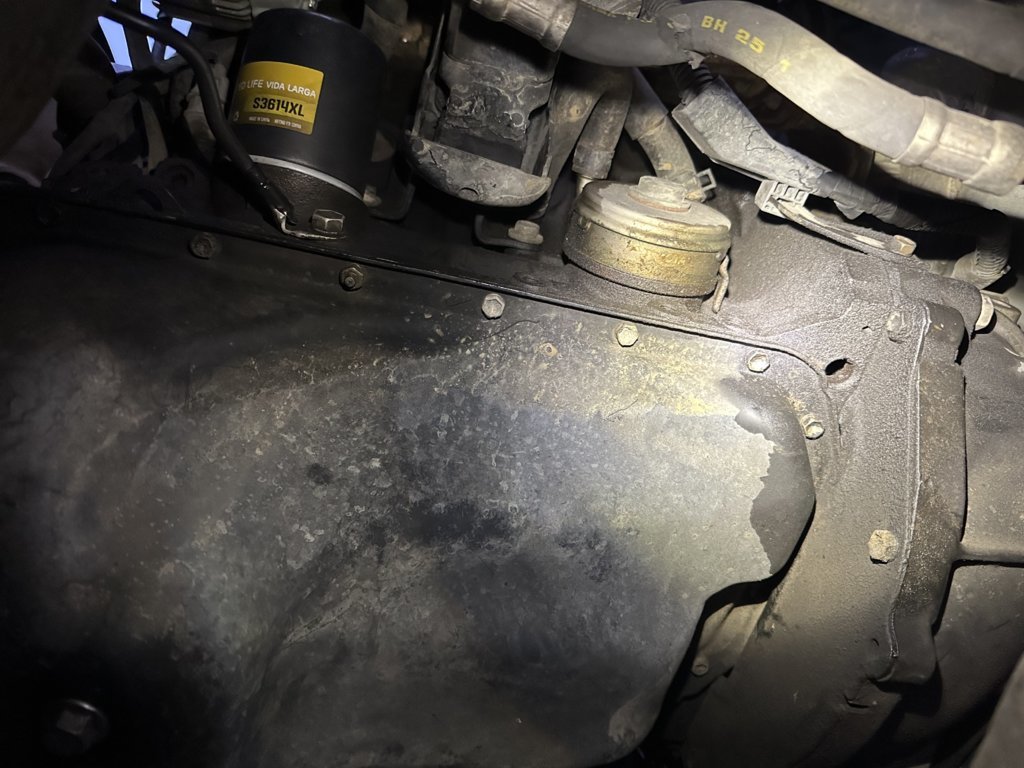

    Hey guys I recently had the valve cover gasket replaced on my 2003 Tacoma but I power washed the bottom of truck and it still seems to be leaking a bit of oil. It looks to be leaking under the headers or from back of motor. will attached some photos. I also noticed that there were some bubbles in oil and alittle white smoke from start ups but truck runs strong. Could it be a head gasket?

    The valve cover gasket was half the job. At the rear of each head on the 3.4 V6, there are 2 camshaft end plug seals, 4 total. I sounds like either they didnt clean and seal these or replace these... they are like $5 each at the dealer. Simple enough to check When cold, use your hand and feel along the back of the heads, you should feel them then swipe along the back of the head, if it comes back oily you have found the issue.

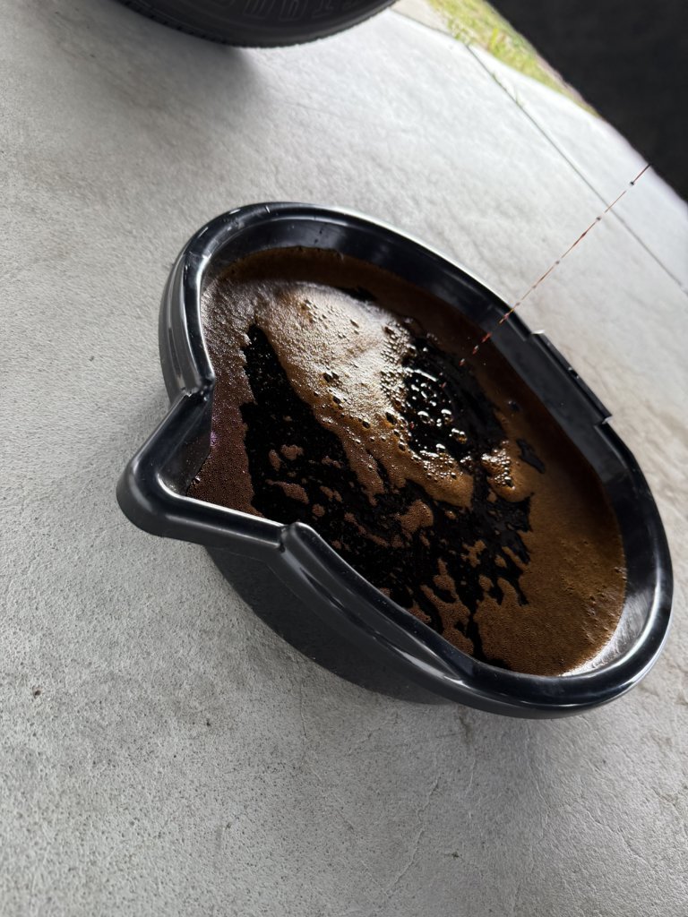

    Don't worry about the bubbles on the oil change. Completely normal.

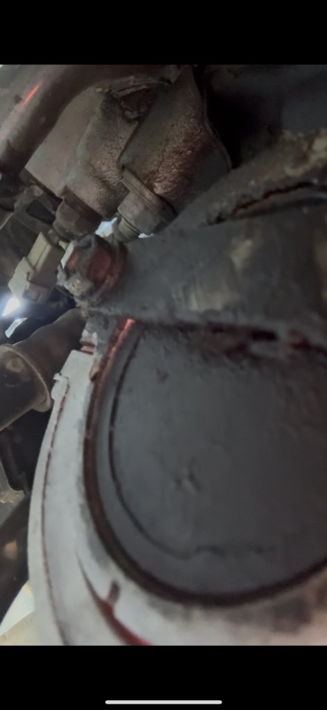

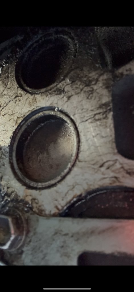

    Spot on brother, just checked truck and took some pics from what I was able to. Question is now is this a fairly simple fix or would I need to have valve cover completely off again. And could this also lead to the white smoke startups and coolant in oil?

    From checking the rear cam plugs it looks like it was leaking from there as I posted in some of the pictures above so I’m hoping it’s just that. But could there be coolant leaking somehow seeping in from the those plugs. The valve cover job I had done looks to be done good other than those plugs.

    Unfortunately you have to pull the valve covers off to replace those cam shaft plugs.

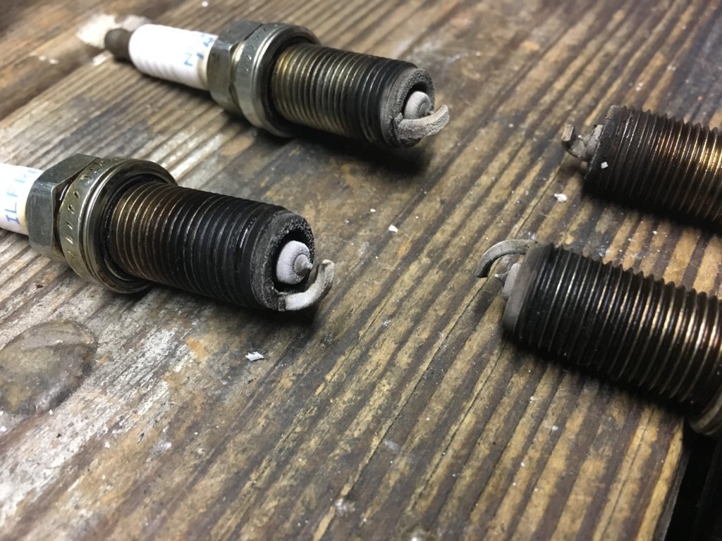

    these were my plugs on my STI
    UGH still hate looking at them
    Needed new short block bc of lean condition

    Dang, those got hot!
