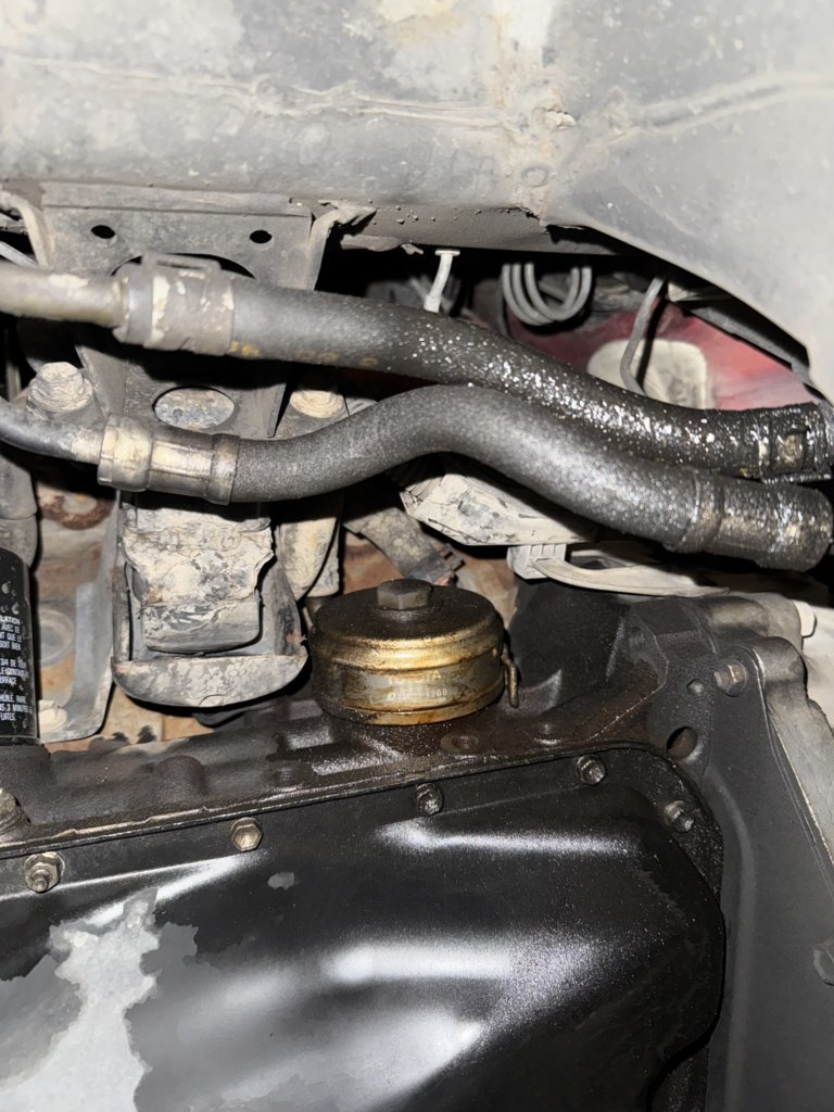

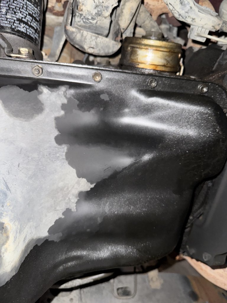

    I also thought it was that because of all the oil on top of cooler but it seems to be coming from more on top of the motor. Unless it would be spraying all over. Ima post picture of the spark plugs later today. But I haven’t had any driving problems at all. Just some oil drops under and around the bottom of truck.
