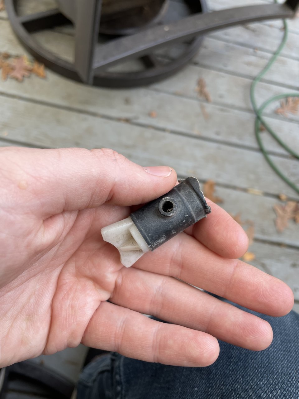

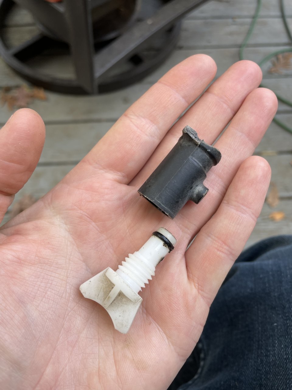

    Anyone recognize this part? Friend thinks it dropped off my truck in his driveway. Not sure if it’s actually off my truck at all but I don’t recognize it.
    White winged part is a cap that screws off, with an O-ring seal.

    Looks like a radiator petcock

    Radiator drain, better check yours.
    Somebody has a broken radiator.

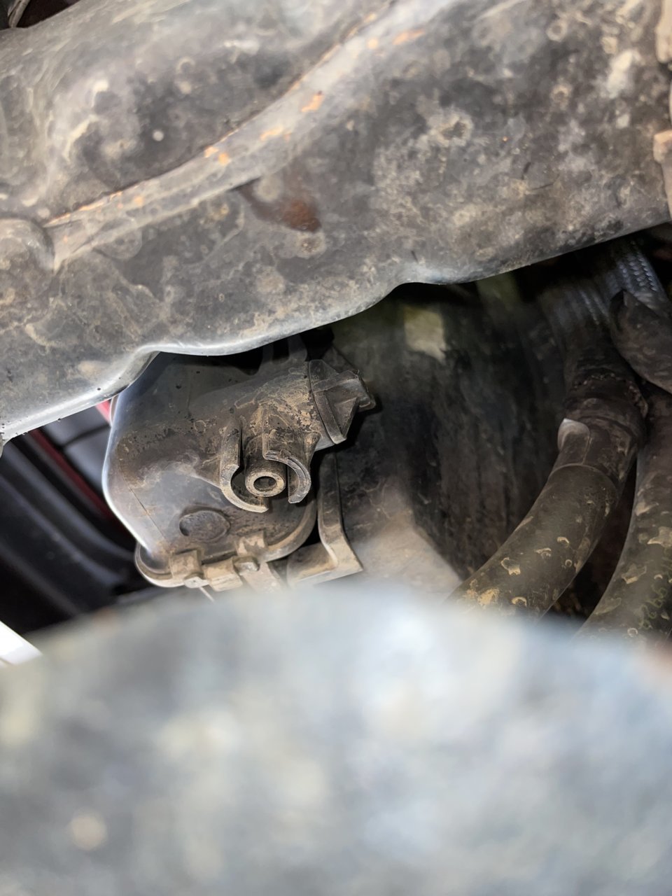

    Just check my radiator and I see what I think is the corresponding part, intact.
    Is this it? And does this mean I’m probably in the clear?
    Friend said there was a head-on collision in front of his house a few weeks ago so thinking the loose part was probably collateral from that, washed down into his driveway.

    Probably not yours. My 07 oem petcock is black. It will be on lower driver-side corner, facing the engine.
    Edit, after viewing the last pic: your petcock is missing! It should look like the one you found. But how is coolant not draining?! Maybe, it’s just a coincidence and your petcock is only missing the end part. See if the petcock you found fits on your radiator.

    So if my petcock is missing, what is this black winged cap?

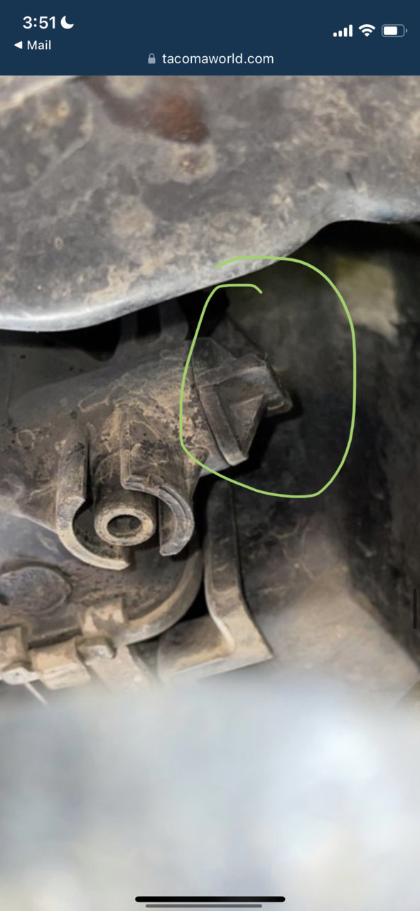

    My bad. Yours is not missing. Either the pic does not show the wings or they are broken. Here is how it should look. Looking at your pic again, the angle is probably hiding the wing portion. Sorry to startle you.

    Ok no worries - I don’t know what I’m looking at lol. Yeah the angle shows the wings straight-on so they’re not obvious. Thanks!
