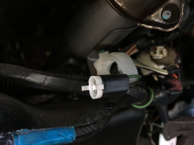

    I found this plug under the steering wheel in my 99. Does anyone know what it goes to? It has 12v between the contacts with the ignition in the ON position. It is not active in ACC or with the key out. Green is positive and brown is negative.

    The one pictured only has power when the key is on. Using that for the ring would kind of defeat the purpose wouldn't it?

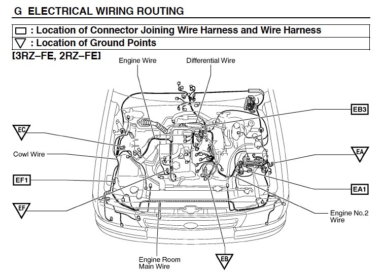

    Oooo, I think I found it. Connector EF1 is more rounded like the one in your picture.

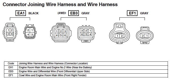

    Flux Capacitor
    Eh, maybe not. EF1 is in the engine bay.

    It runs into the wire loom with the rest of the ignition wires.

    It doesn't look like any Toyota connector I've seen before. It has round barrel pins.

    That's what I was thinking. It doesn't look like anything under the FSM. I think the only thing you can do is trace the wire. Does it look like someone added it in, or is it part of the factory harness?

    It goes into the wire loom with the factory harness, but I guess it could have been put in there after the fact. I can't really tell where it goes other than back with the ignition wires.

    So I have determined that the plug goes to my South East Toyota installed security system. It is referred to as the "Theft Deterrent System" or TDS. I compiled the documentation on the system a while ago since it was hard to find correct info. I'll post my documents here for future reference.
    The green and brown wires at the connector change to orange and yellow which are part of the starter disable system.
