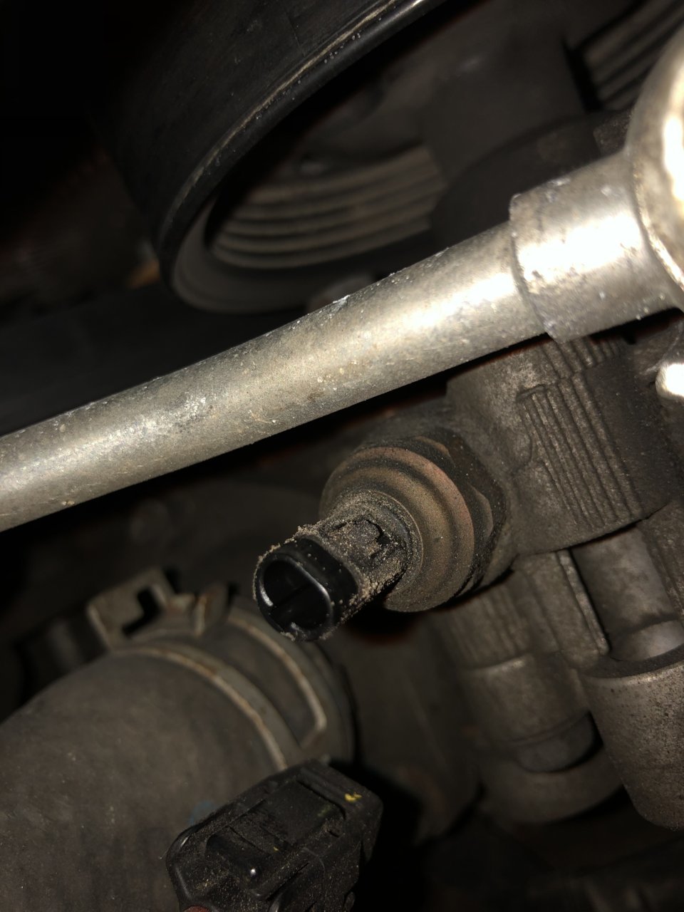

    Seriously anyone know what this is.. I can't find anything on this side that's missing a 1 wire plug

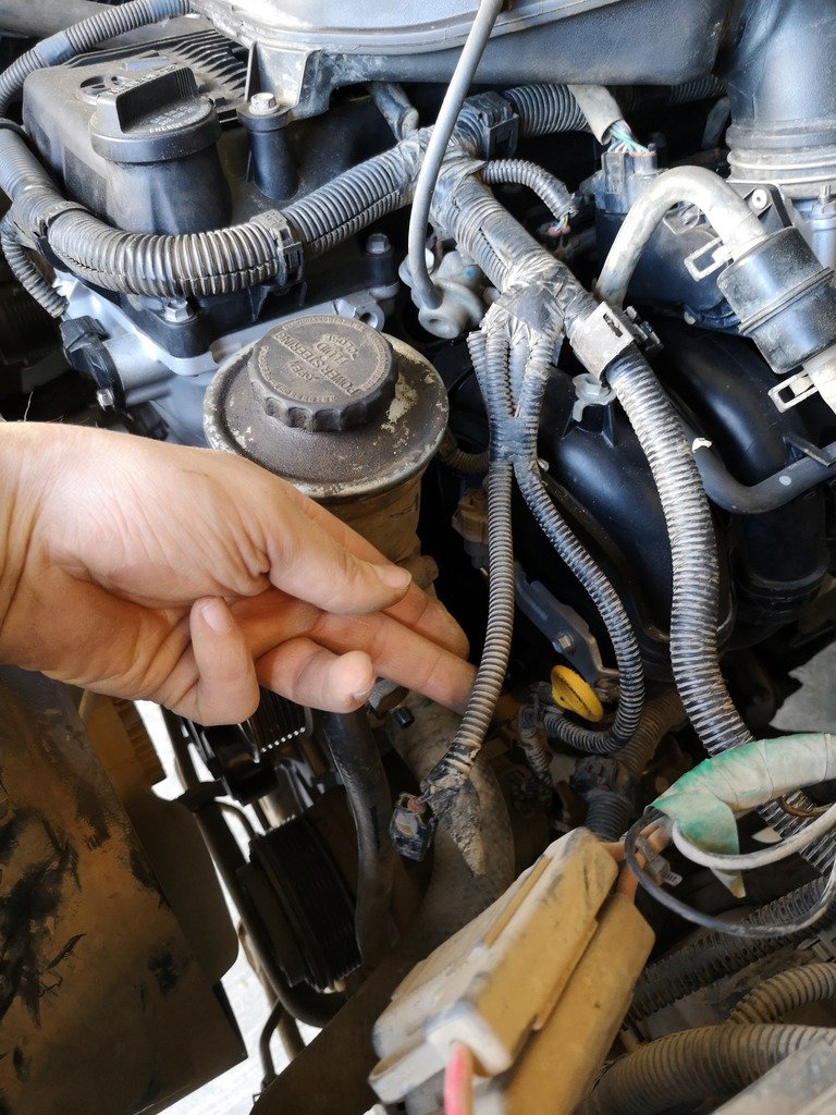

    Ac maybe?
    I can go look.

    That looks like it goes into the bottom of the power steering but I don't have a plug end there just a tube thingy

    Yes bottom of power steering.
    Mine unplugged.

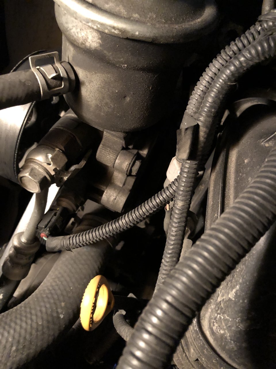

    I got a single wire plug going into the power steering pump. Looks like just a tube, maybe the plug end has a mini sensor or something.

    Ok the the receiver end of mine has clearly broken off does it do anything @Jeffch you throwin any codes ?

    No codes I unplugged the wire to get the pic.
    My wire plugs into that tube.

    It's a idle kick switch for when the steering is a full lock.
