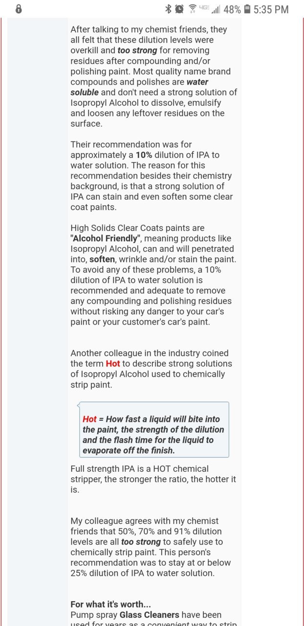

    I thought 20-30% is ok as long as you don't let it dwell?

    That's about what I use.

    I stay in the safe zone at 10% looks like 25% would be ok but if 10% is strong enough yet still 100% safe that's were i like to stay and not chance anything. Paint jobs are expensive. I love my truck but Toyota paint is lacking in my opinion and I dont want to chance anything. I also polish and wash and wax/seal my truck regularly and love to keep it looking its absolute best. This applies to every thing but single stage. I just go by leading pros in the biz.

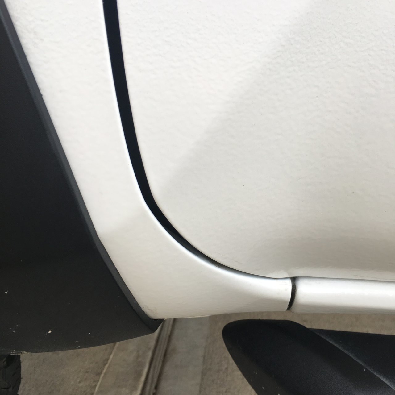

    I got it cleaned off today, I used mineral spirits applied with a rag let it sit for a minute and hit it with a nylon brush. Then I hit it with quick detailer, clay bar, quick detailer again. We’re In for some rain so I’ll wash and wax after the rain.

    Nice! Glad we could help. Make sure you get some wax or sealant on after the rain.
