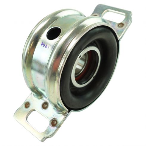

    Alright so a bit of background - 2003 Manual V6 Tacoma TRD ~175k miles. Recently drove from OR to CO after which this issue cropped up. The truck makes what sounds like a tire rubbing (too low to capture on video) and there is a very obvious vibrating that goes along with it. It comes and goes but is pretty consistently noticeable at around 30-40 mph. I did notice the other day that the noise and vibration disappear when I put it in high 4wd. I had a full vehicle inspection done at a reputable shop and they could not diagnose the issue. I took it to another shop that couldn't diagnose it either.
    I'm at a bit of a loss now what to do next... Hoping to get some leads here to hopefully get this resolved ASAP before summer travels. Let me know if you have any questions.

    Thanks for responding Glamisman! I came across a discussion about the ECGS bushing in another thread but dismissed it because of the model years mentioned ('05 and newer). The description of the issue I read in that thread did mirror mine almost exactly, albeit related to a newer gen tacoma. Any thoughts?

    ahh got it, thanks! yeah that is the feeling i get after doing some research :confused: I guess ordering up one of these bushings and installing it is a good place to start.

    When I did mine I had to thin out/trim/grind on the extractor edges to get it to fit behind the stock bearing and the bottom of the hole that it was pressed into. There just wasnt enough "bite" to extract the stock bearing.

    did you lube the U-joints?

    also check the carrier bearing, if the black rubber is roached out/worn, more than likely its bad.

    Is it safe to drive until it's addressed? I ordered the part and tool.

    Quick update here.. Had the ECGS clamshell bushing installed a couple days ago and the vibration is gone! Hopefully it holds up and this helps someone else who runs into the same thing. Cheers ya'll :cheers:
