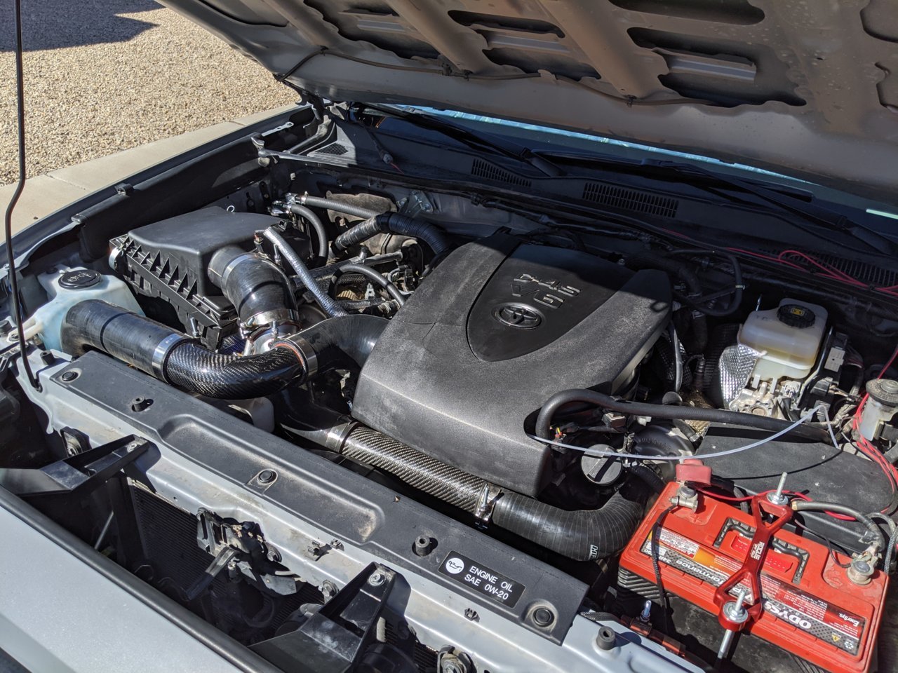

    - OVTuned (N/A tune from Dec2017 - Nov2020; FI tune Nov2020 - present)
    - OVTune Twin Turbo kit
    *base kit, no fueling upgrades, Turbosmart boost controller set to 6-7psi (originally tuned for 9-10psi)
    - Doug Thorley catless y-pipe with resonators
    - Fabspeed Motorsports o2 sensor spacers with mini catalytic converters
    - JLT driver side oil catch can; Morimoto universal oil catch can on passenger side

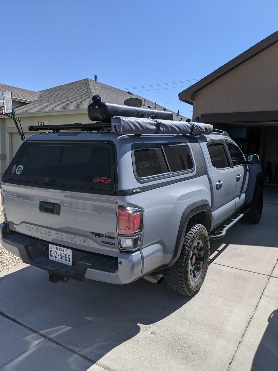

    - A.R.E. Overland shell w/ various options
    - Prinsu Toprac above the ARE shell
    - 3 Prinsu load panels
    - Rotopax 4gal fuelpax
    - WaterPORT Weekender
    - WaterPORT Day Tank
    - ARB awning 2000x2500mm #814201, mounted with Prinsu awning mounts

    Fabspeed o2 sensor spacers with mini cats continue to work nicely, keeping away the CEL for the sensors, allowing me to retain my cruise control and meaning I should expect to have zero issues doing my annual state inspection.
    Not to mention when I drove for the 1500-2k miles with the CEL for the sensors, I eventually got used to it being there and would've had no way of knowing if an additional cel popped for anything, if it was something no immediately felt in the drivability of the truck. So some peace of mind there

    Lol no. Original 3.5L 3GT v6, with the OVT Twin Turbo kit.
